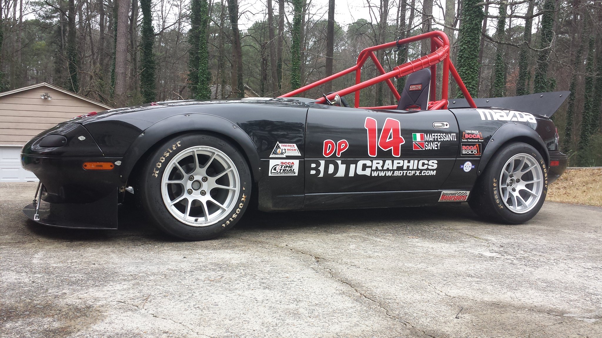

Took everything apart so that I can make the final mods for the template for the air dam, strip the protective sheet off, and replace all the hardware with much shorter bolts (because an inch too long over 50 fasteners adds up to more than I want to give a free ride around the race track)
Pro-tip: on DiBond, don't use an impact to snug up elevator bolts.
Since it's a relatively soft material, I used a spacer and a few stacked washers (and a nut) to get all the elevator bolts for the air-dam pulled into place. I was successful on a couple, but also chowdered one up royally (to the point that I had to cut the nut I was using off). When I ditched the impact and just used a ratchet, it was smooth (but much slower) sailing.
Because that one hole was properly boogered, the square shank on the elevator bolt wouldn't grab enough to tighten down a nyloc nut, but a little improvisation got it handled. All the surface area from the domed base of the bolt + the lock nut have a good hold on it, it was just getting it to that point that was the challenge.

I have (and will), the problem is that there's a VERY limited market for this stuff.
Nice work but you must be spending a small fortune in fastners.
Honestly, a lot less than if I tried sourcing them from a hardware store. Considering specialized stuff costs well over $1 per bolt from Ace/Lowes/HD, it could be way worse.
Just looked over my McMaster orders and it's only about $30 in fasteners. Buying in bulk helps A TON.
~$20 in Elevator bolts (2 packs of 25)
~$6 in washers (1 pack of 50)
~$2 in Nyloc nuts (~0.5 pack of 100)
Thanks! Compare it to the first effort and it seems pretty apparent that I've learned a couple things in the last year :D
The fitment on the airdam the 1st time 'round was garbage O_o
Don't be so hard on yourself. 1000x better than anything I'd come up with. :)

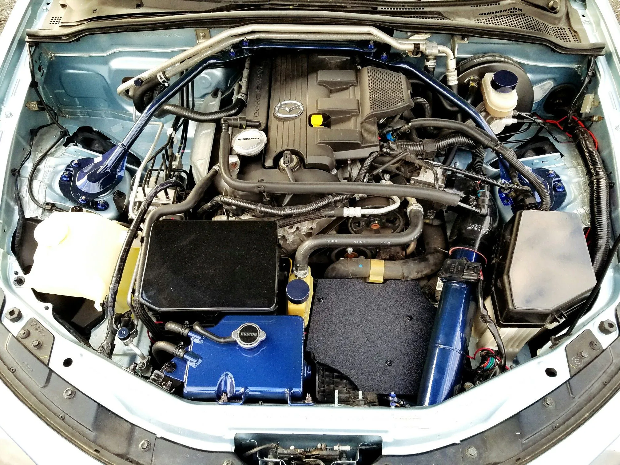

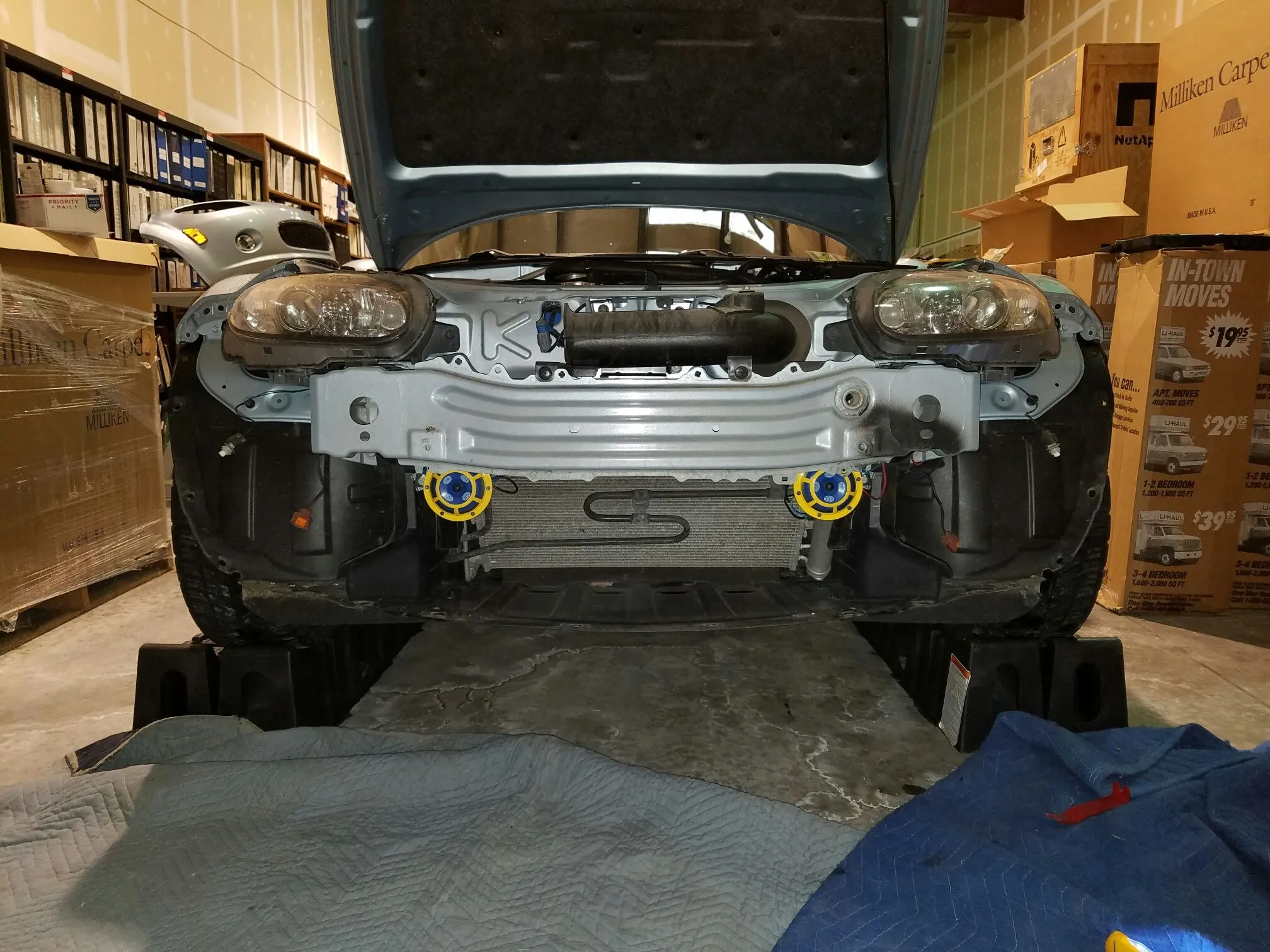

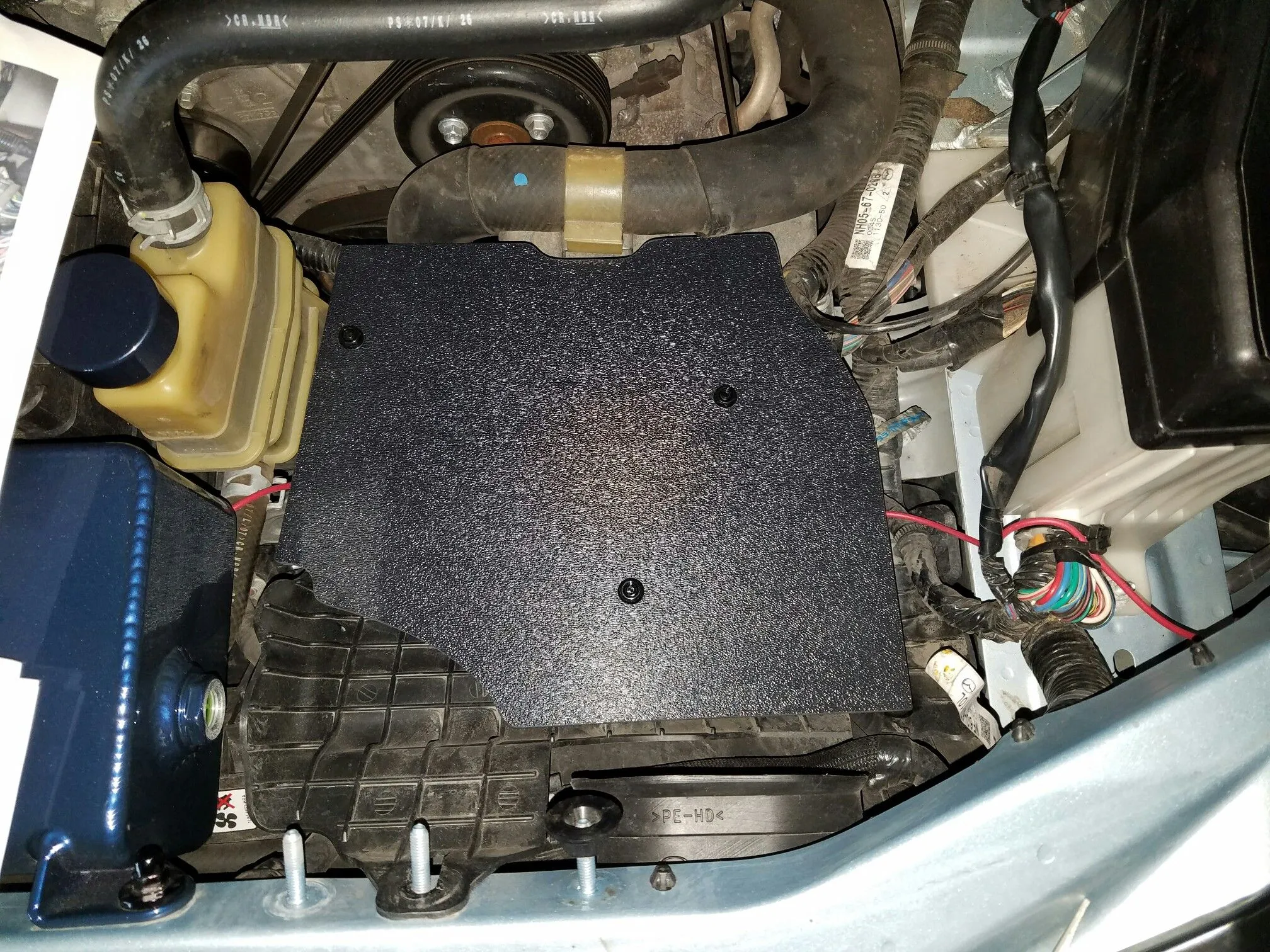

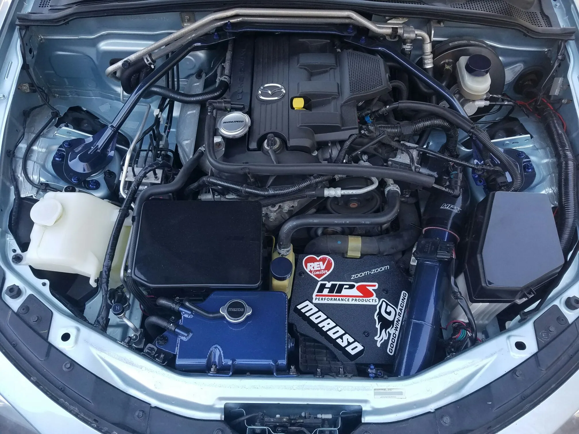

Yesterday I replaced the rear pads and rotors. Today I installed the IL Motorsports brake fluid cap cover, Rich Velardo custom ECU Cover, OEM FSTB, HPS silicone intake elbow and removed the bumper to install a Moto-East CAI. Since the HPS elbow didn't have slots for the PSV bracket we made a small bend and drilled a hole so I could attach it one of the FSTB mounting points. I had the brake fluid cap cover, intake tube and FSTB coated mag blue to match the coolant tank and other misc. engine bits along with the wheels.

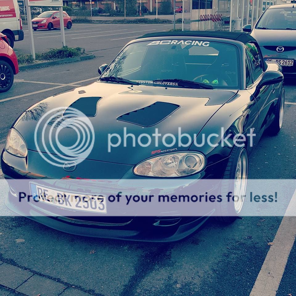

i just ordered a set of Singular NC Hood vents for the MSM. Im looking forward to those coming in, im not looking forward to seeing how steady my cutting hand is when it comes time to install...
