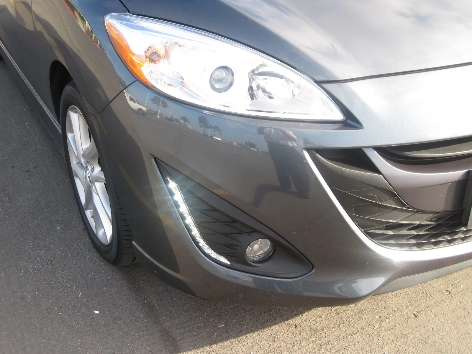

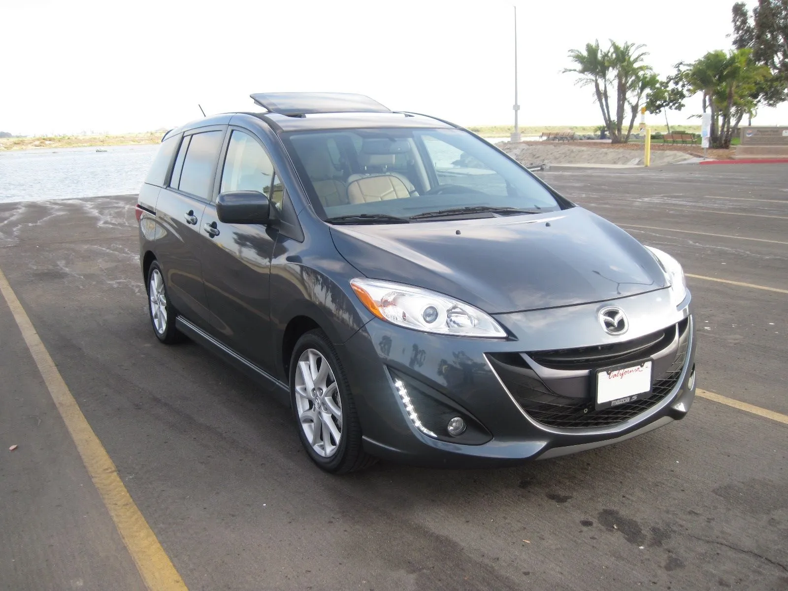

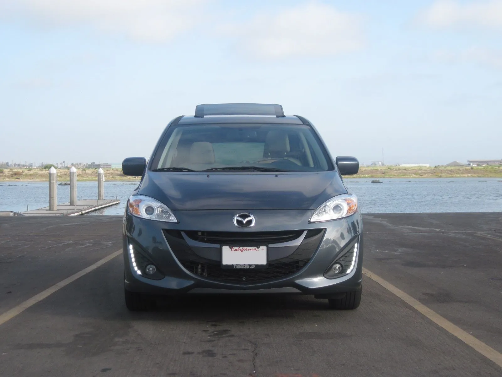

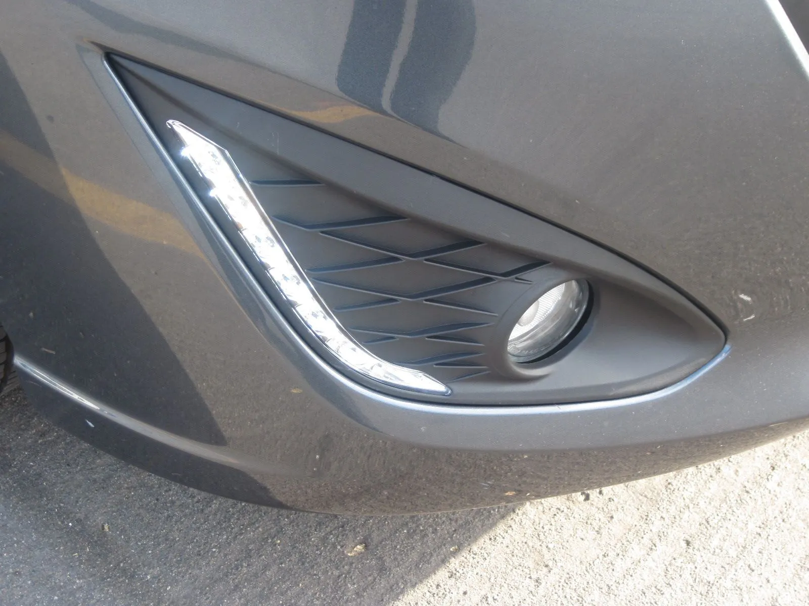

Installed LED DRL bezels on my 2012 Touring last weekend.
Looks OEM, works great!
