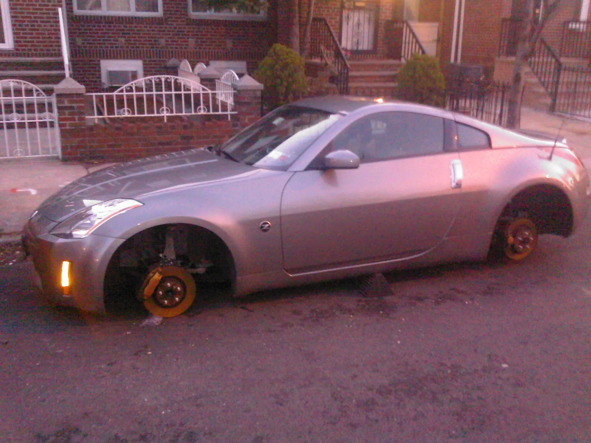

Remove factory wheel locks for regular acrons. The 90s have ended and I don't think people are out to steal OEM rims. Make tire change much easier without having to fumble for a key.
I beg to differ.......
Hope that wasn’t your car. Have to admit I have not seen or heard of stolen rim incidents in a long time since it is easier and less risky to just jack the car. The 350Z being popular with the import crowd, I’m sure it'll get chopped pretty easily and quickly too.
Do you have history behind this pic? Was the Z on OEM rims or aftermarket? Do you know if the owner had locks – they can be defeated just as well. I will correct my comment in that cars with limited edition rims (eg. NISMO or performance line) or high end cars are exceptions to the rule.
Personally I can sleep easy and not worry about anymore pilfing my rims –nor the car for that matter. A very effective anti-thief device (and becoming more effective with time) is the stick in the middle console :p, which maybe why they didn’t (or couldn’t) take the car.
I know most of the story. It was a special edition rim, but all that meant was a darker finish than stock, nothing special really. I dont know if there were locks on the wheel, I will ask next time I see the guy. In any case, they also stole rims from a BMW 335 and a Toyota Venza in the same month. My other car sits in a garage, I dont trust it on the street, even with locks on the wheels.
