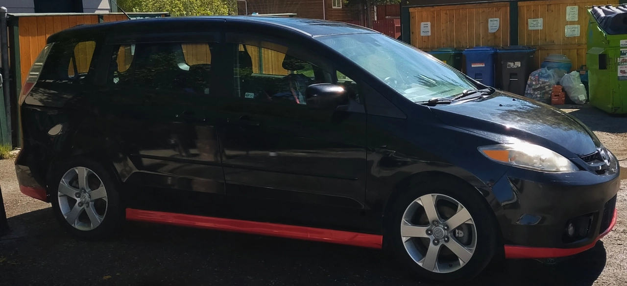

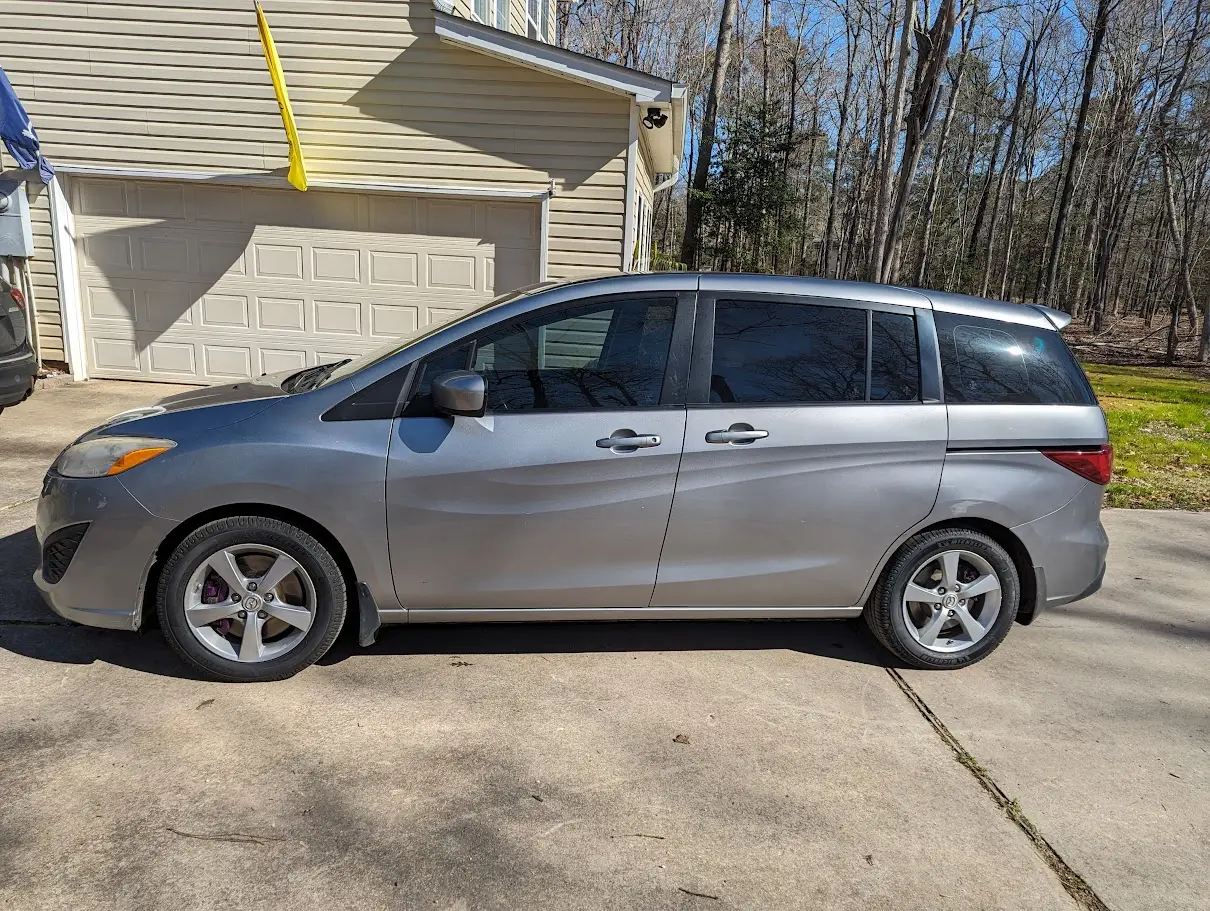

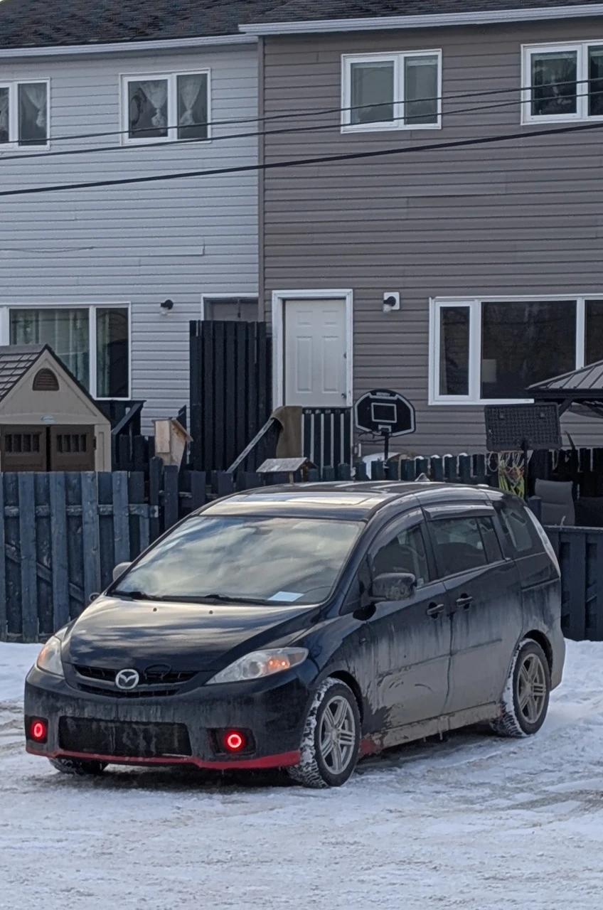

Ha ha! Back on the road. Total loss write off my ass :D
Looks great! How did you end up handling the damage and insurance?
The dialog with insurance went like this after their assesor was done...
Insurance: Our estimated repair cost is at our valuation (KBB) of the car. It's a total loss and were not directing the repairs be done. We will send you a check for our estimated value (KBB).
Me: Can I take the car back and have it repaired.
I: Yes.
Me: Would you then cover the repair costs, or am I out-of-pocket?
I: Yes, we wiil pay for the repairs, but only our repair estimate.
Me: 🤷‍♂️ Okay, I'll take it back.
Had it repaired for a lot less than they assesed and insurance sent a check for their estimate. Went from *total loss* to repaired and made a little profit. Again, 🤷‍♂️

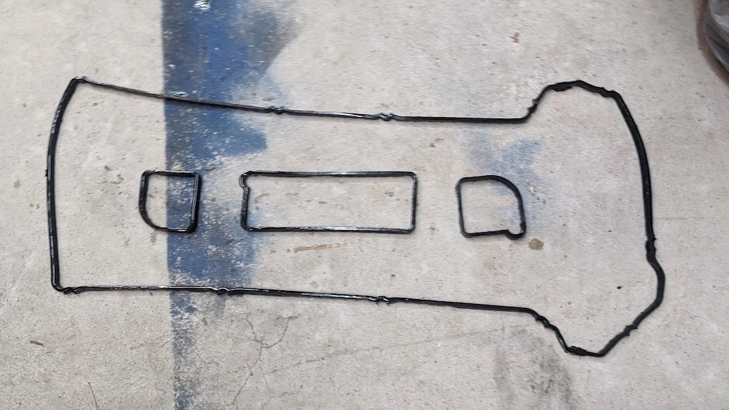

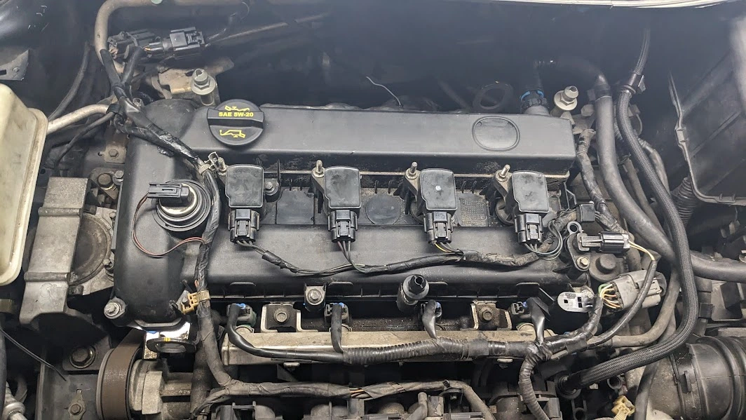

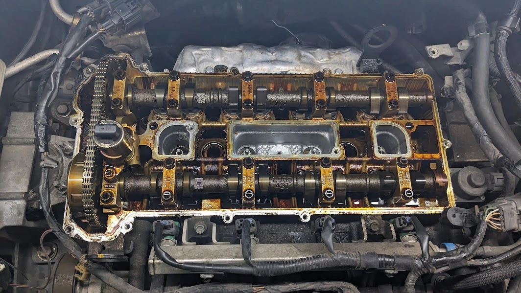

Valve cover gasket has been leaking since I got the car. Nothing major, but I noticed residue on the right side and some on the back towards the exhaust. Also was building up by the sensor on top. Funny thing I couldn't for the life of me find out what the name of the sensor is or what to even call this gasket. I had to do a lot of running around looking up pictures of Mazda 3, 5, 6 and Fords. Luckily I found some stuff to put me in the right direction. People were calling it a VVT Solenoid and others saying Oil Control Valve, but what ever it was it is Part# L362102D5A. Also the only way to install this gasket is removing the valve cover, since you have to press it in from the inside.
160K Miles and its not as filthy, but still dirty
Gasket was HARD, but it wasn't brittle, managed to all stay together when prying it out. Part of me wants to say it was OE, but whoever replaced this in the past had nearly stripped some of the 8mm studs. So I had to be extra careful not to make them any worse. Which meant using my deep socket was out of the question, so I had to use my tiny 8mm wrench and manually loosen and retighten them. My knuckles werent thrilled.
Back together, I have it mostly tighten down. I put some sealant by the timing chain and just gonna let that cure overnight.
Next up, I need to do both belts and idler pulley, check compressor oil before summer, and radiator flush.

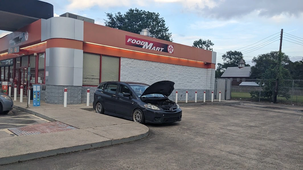

Pumped gas today while doing a delivery, as soon as I was leaving at the stop sign, I hear a thunk from the front followed by vibrations and very weird noises from the engine. Immediately pulled over and popped open the hood
Looks like the engine/torque mount on the transmission has left the chat.
Very slowly limped the car back to the gas station to be towed in the morning.
