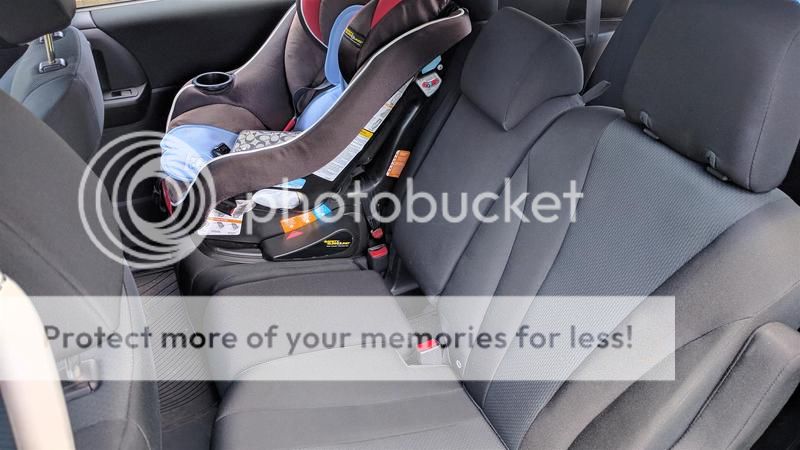

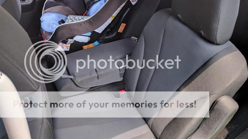

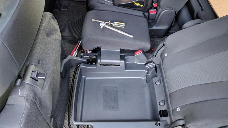

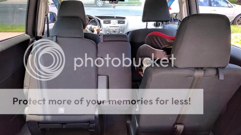

Not exactly today but in the passed 2 weekends. I got the 2nd row middle seat installed which was on my wanted list since day one.

How hard was the install? And can you repost the oics cuz i think the link is broke

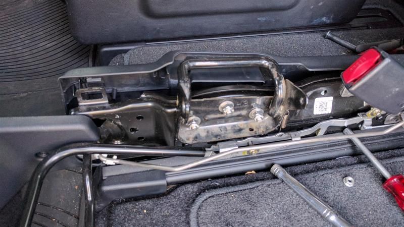

Fixed the pics. The mod is not that hard.
The plastic tray has to be remove and trimmed to fit the hinge of the bottom piece. There is a line on the tray already. The hinge was riveted to the original seat base which has to be cut off and replaced with some bolts and nuts. The US seat base have those holes pre-drilled which is nice and installation is straight forward.
The back piece is a little different which involving swapping the frame of the back piece where the hinge and a "C" hook for the new seat welded on it. The original cover from the donor car has a zip going from the bottom all the way to the hook. Since the one from the donor car has a different pattern than mine and I would like to keep mine to match the rest of the seats. So fitting the frame with the "C" hook in the US ver, seat cover take a little bit effort. Once fitted into position. I cut the cover and the foam underneath to match the "C" hook and that's it.
More importantly, where did you source the parts and how much should you expect to pay for it?
I got them from a Junk yard in Hong Kong, Kam Tin to be more specific if you are familiar with the area, while I was there for vacation. Paid ~$190 for the whole LHS 2nd row seat assembly since they are attached. Disassembled the 7th seat and took the frame of the back piece. They are all fitted into my luggage.

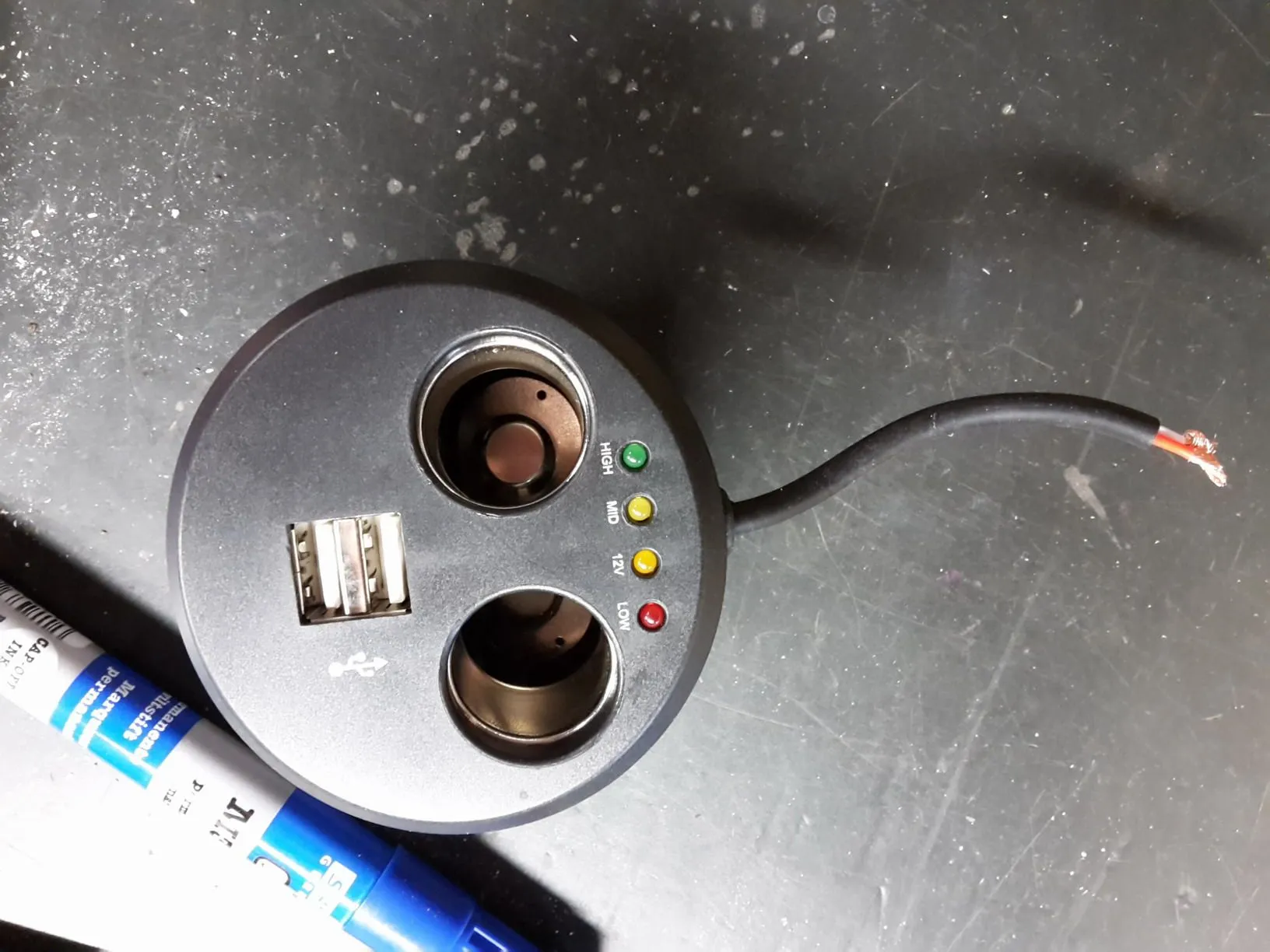

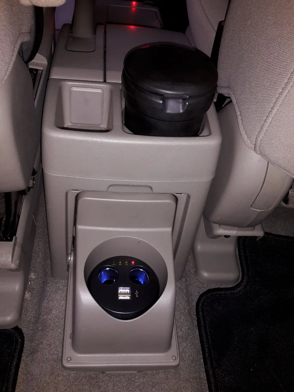

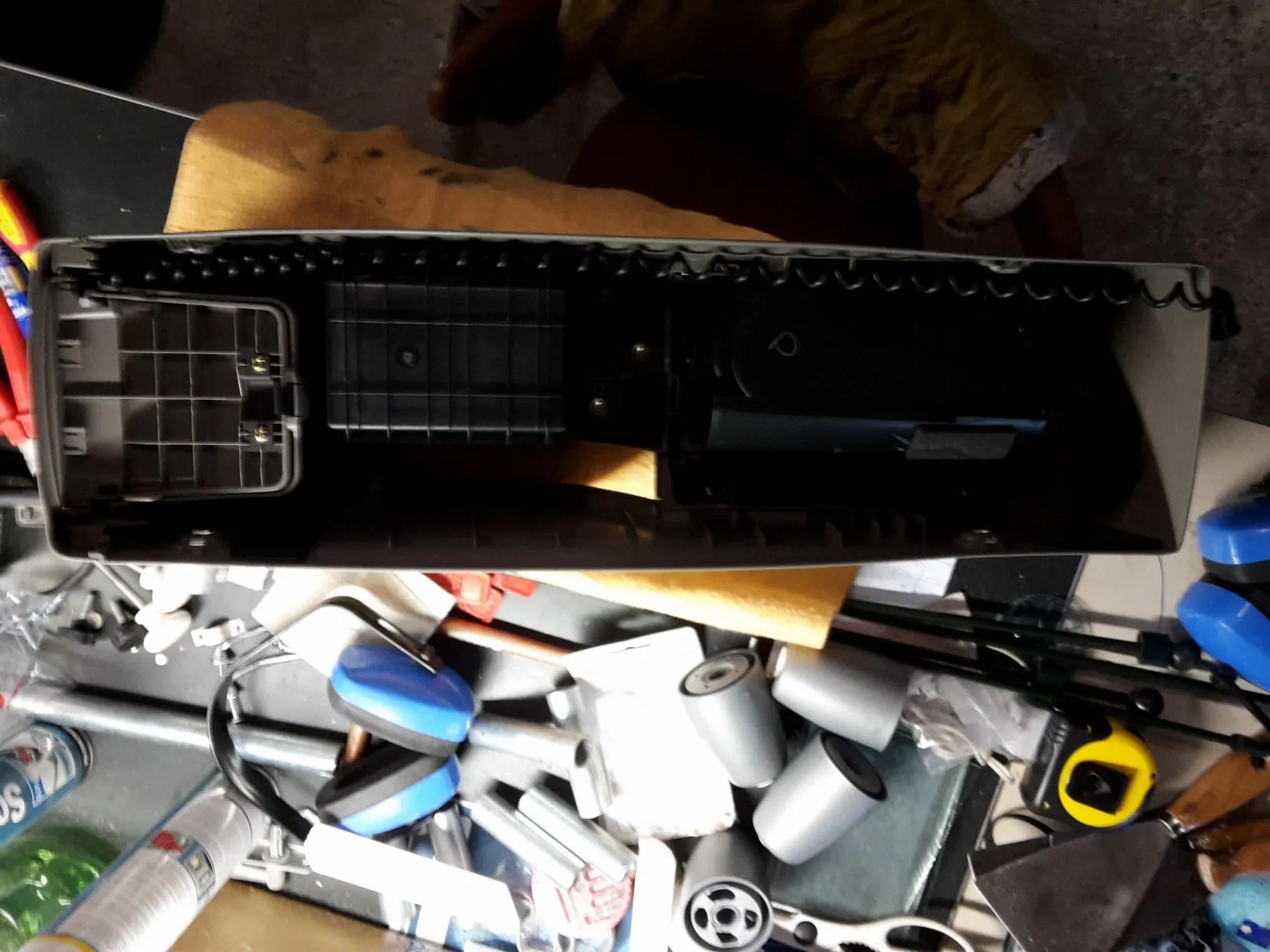

Installed Ring RMS10 power socket in rear fold out cup holder
Today I installed this power socket (12V + USB) in the rear fold-out cup holder between the to front seats:
http://www.ringautomotive.com/uk/products/Cars/Multi-Sockets/Multi-Sockets/RMS10
I bought it to use it occasionally as a stand-alone socket, but it fitted so nicely in the cup-holder that I decided to make it a permanent install.
The install turned out to be quite straightforward:
1. Remove the complete console by detaching the four screw on the side walls
2. Remove the cupholder by removing one screw and then detach it from the clips
3. Remove the front cover of the cupholder

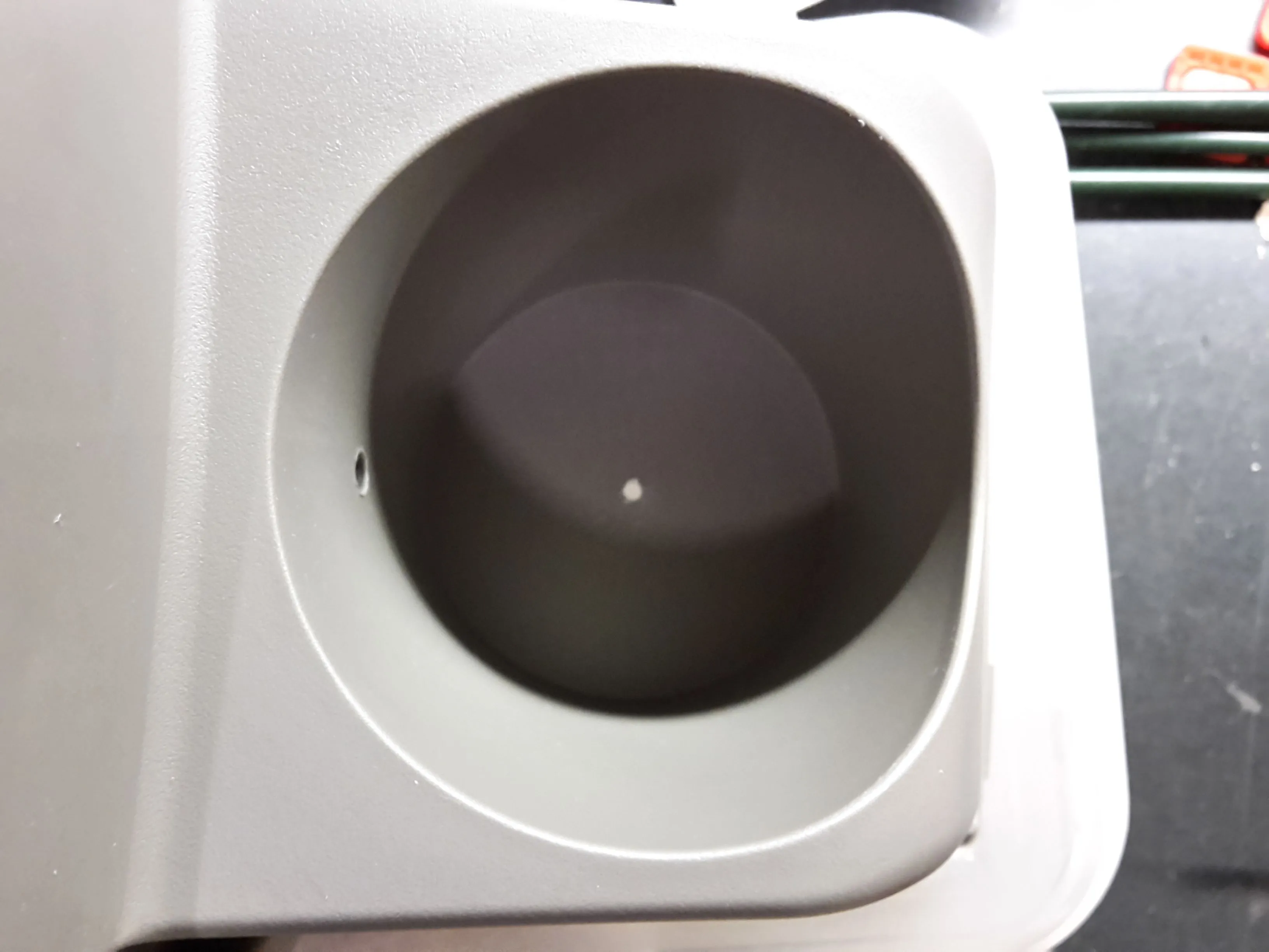

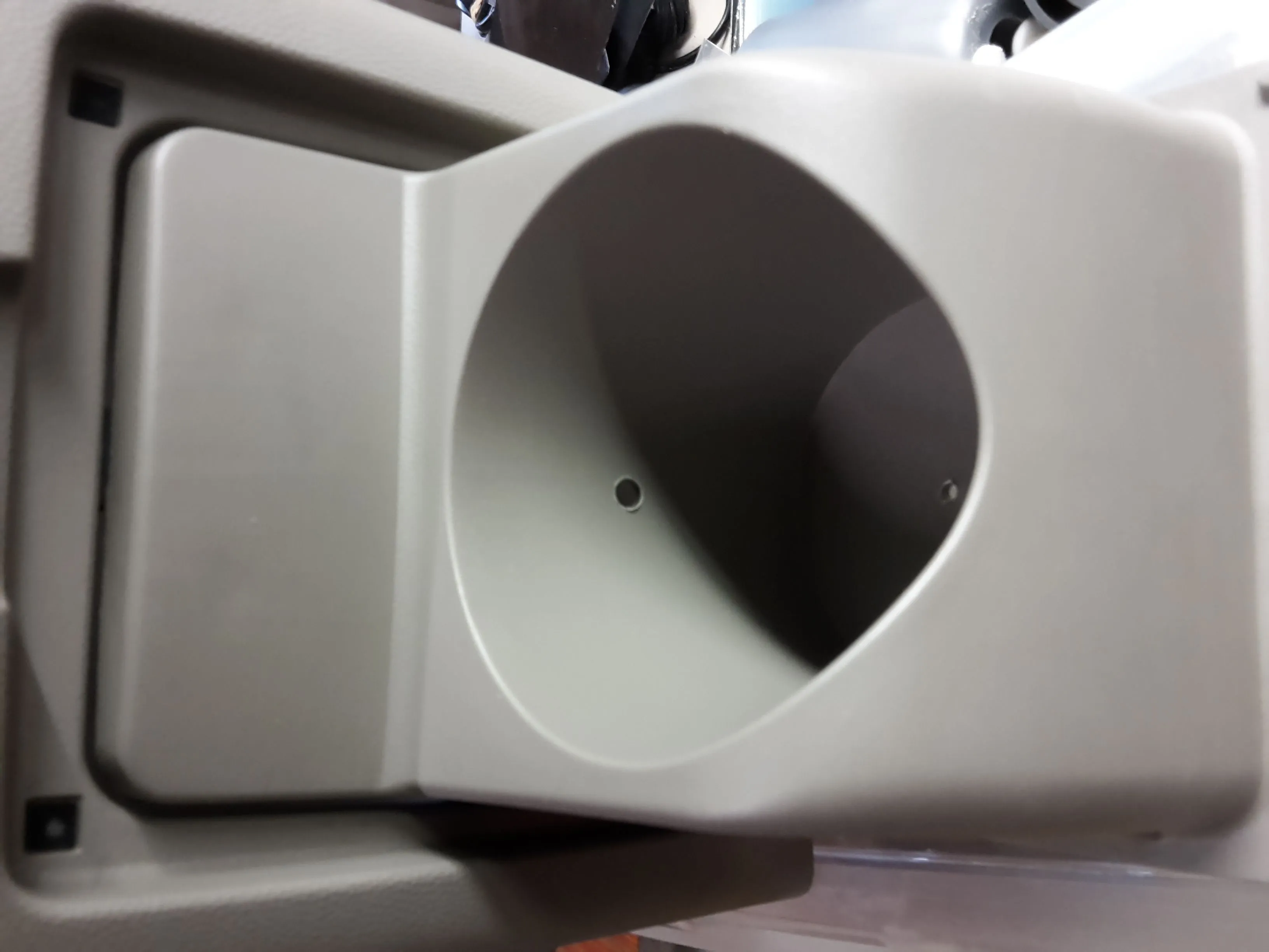

4. Drill two holes in the cupholder, one for the power line and one for a screw to secure it to the bottom of the cupholder.

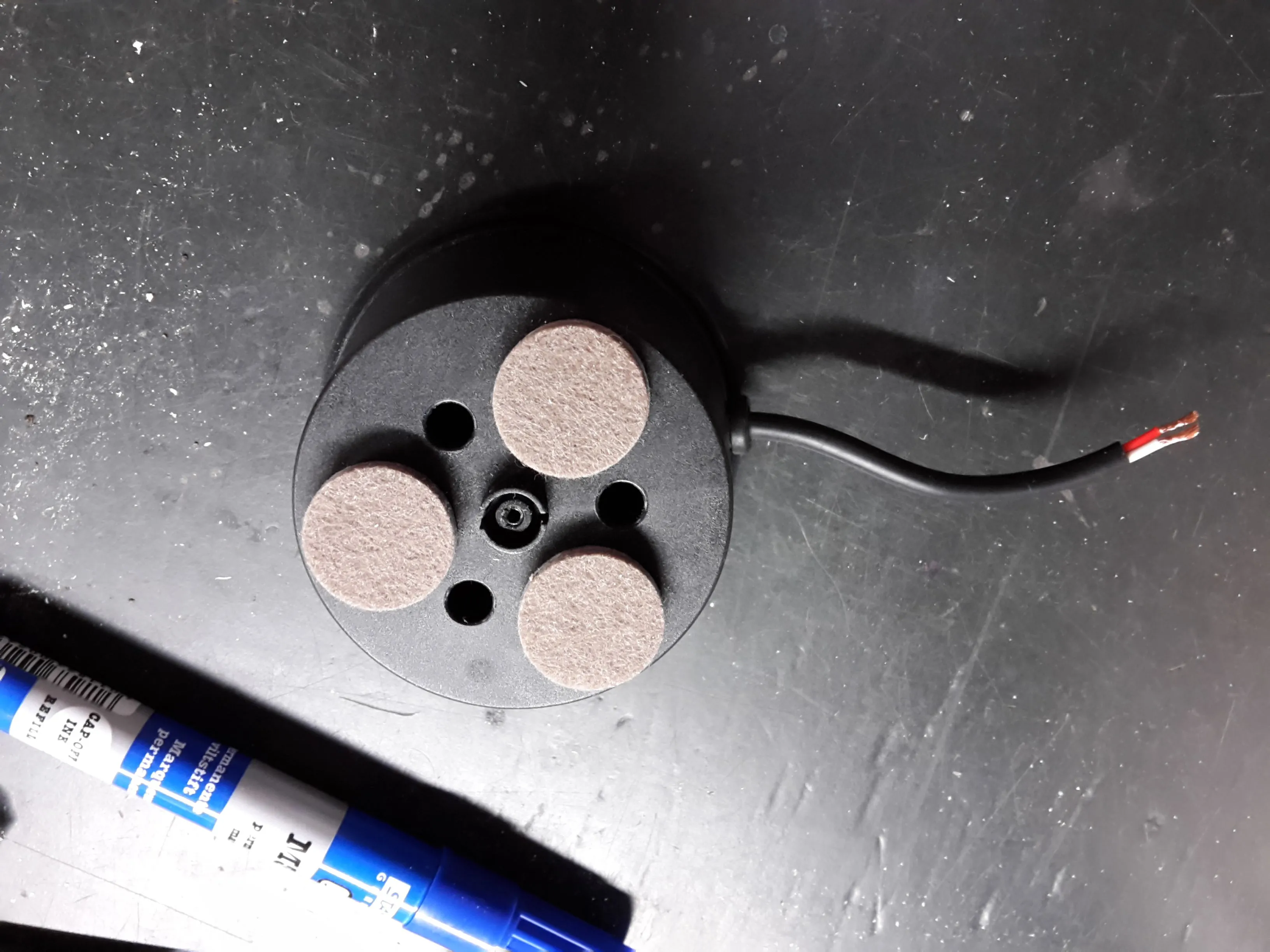

5. Cut the wire of the power socket to allow it to go through the hole

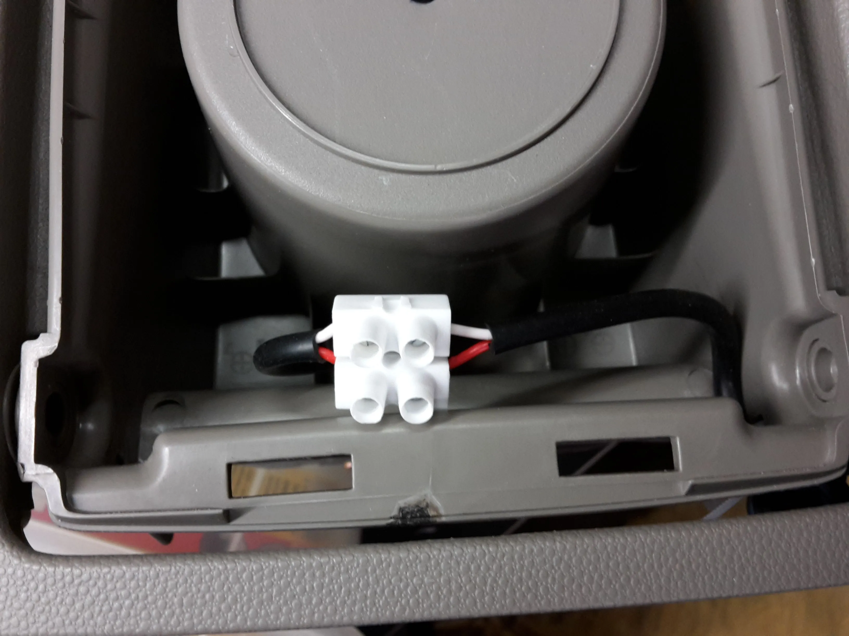

6. Route the wire through the hole and on the inside of the cup-holder re-attach it to the other part of the cord.

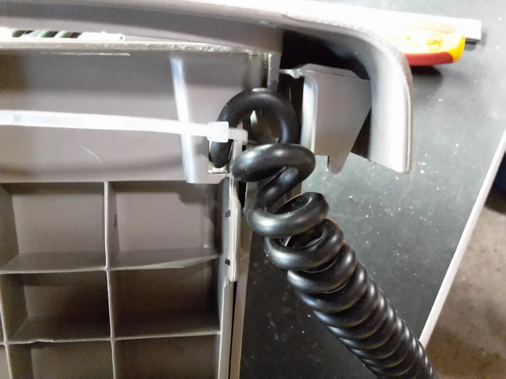

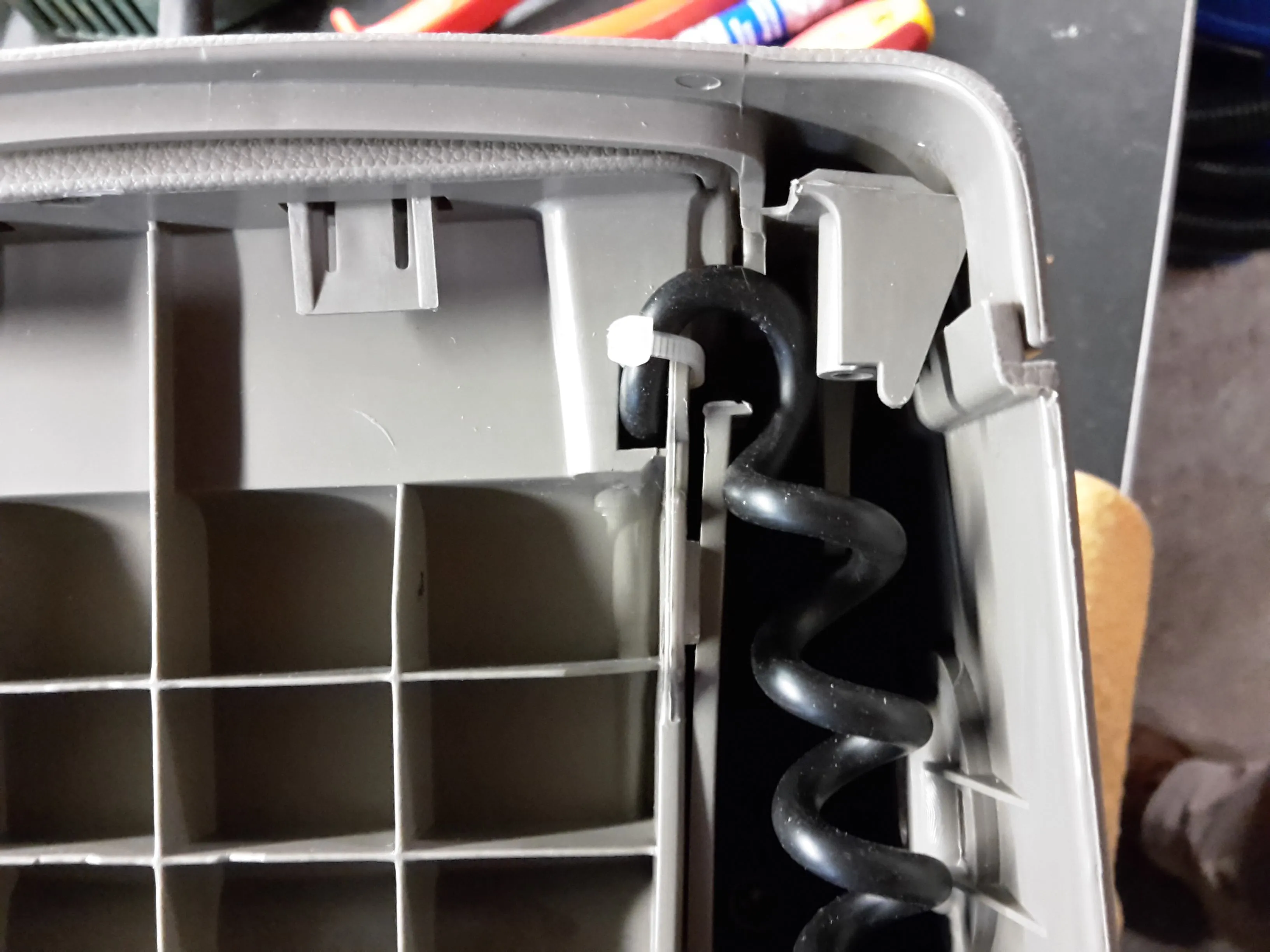

7. Secure the wire using a tie-wrap to the hinge of the cupholder to make sure the wire doesn't get trapped
8. Route the remaining part of the wire to the front of the complete console and reinstall the console.
Some other photo's:
I cannot find out how to show them inline, so ended up adding the photo's as attachments...
