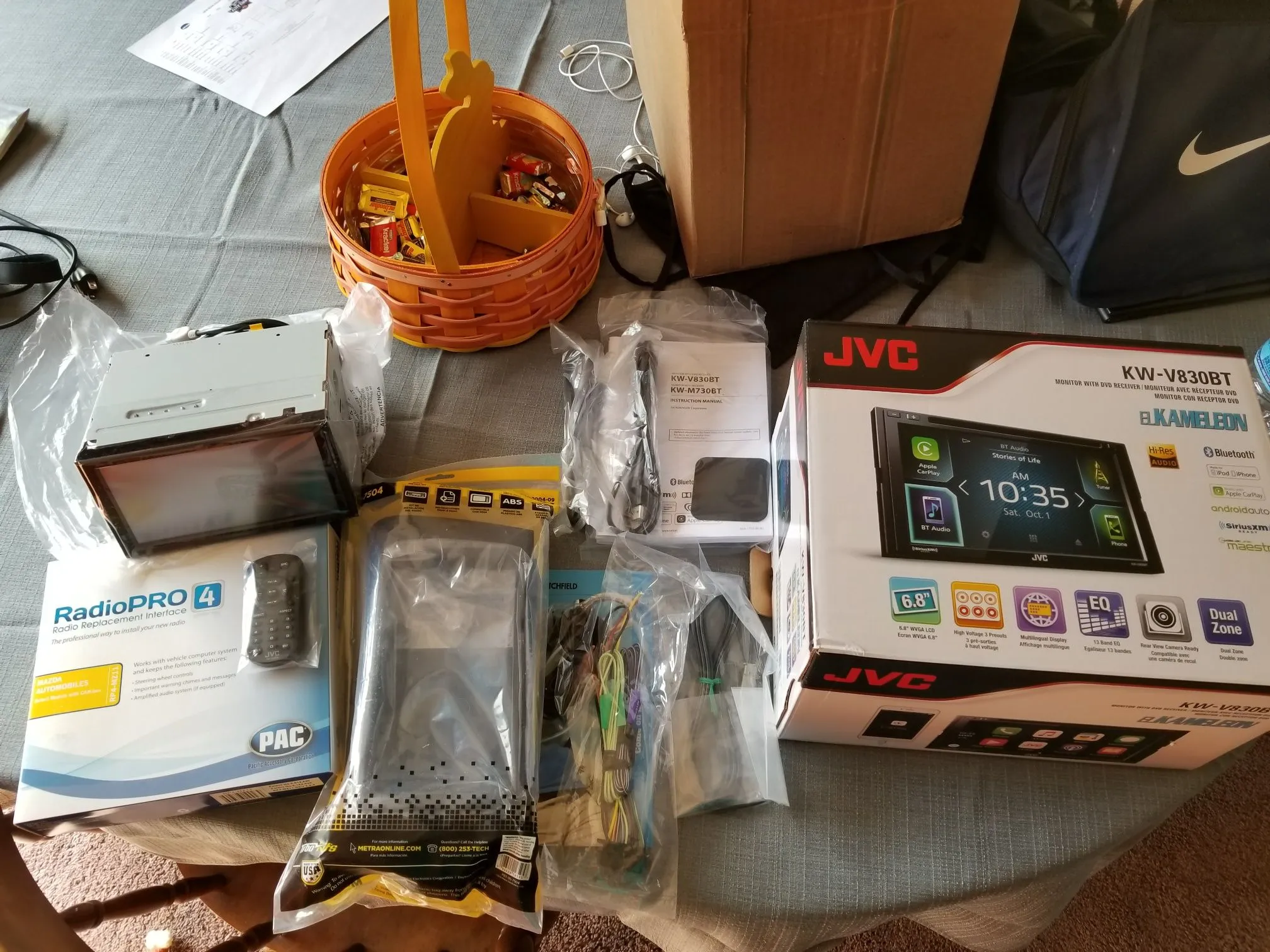

This came in last night and will be installed in the 2008. :)

HU installed. The boy is working now so well play around with the settings tomorrow.

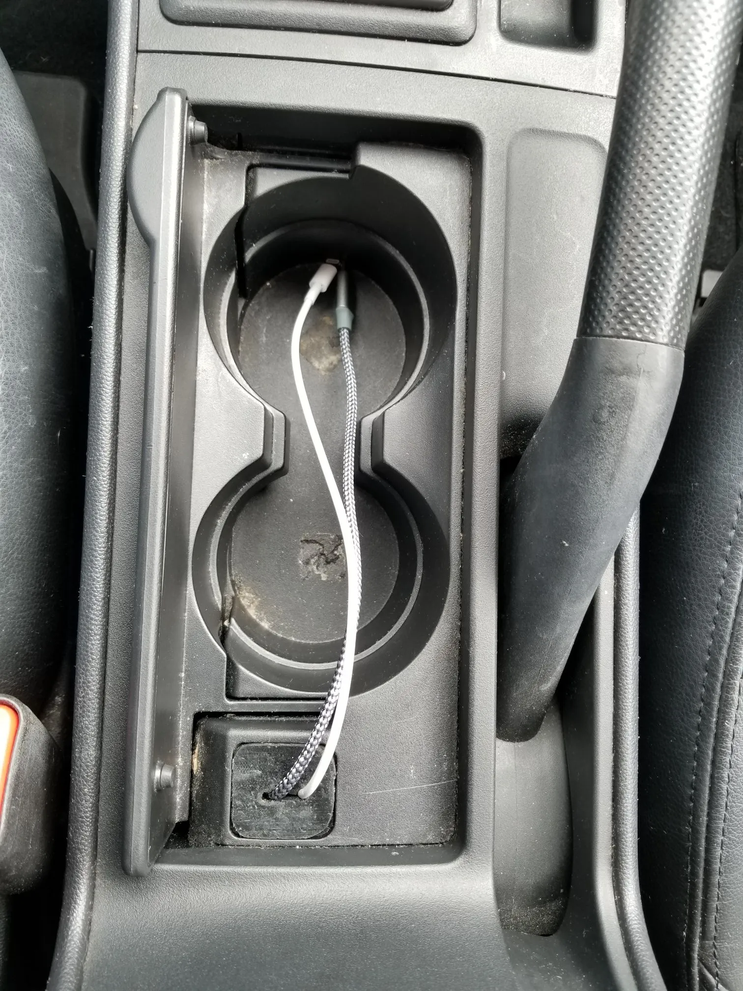

Wasn't crazy about the way I initially ran the USB cables under the dash and into the PS footwell. So I pulled out the cupholders, shifter trim and center console pocket to re-route them. I cut a piece of rubber to fit the hole at the rear of the cupholders and then notched it to feed the cables through. I'm much happier now.

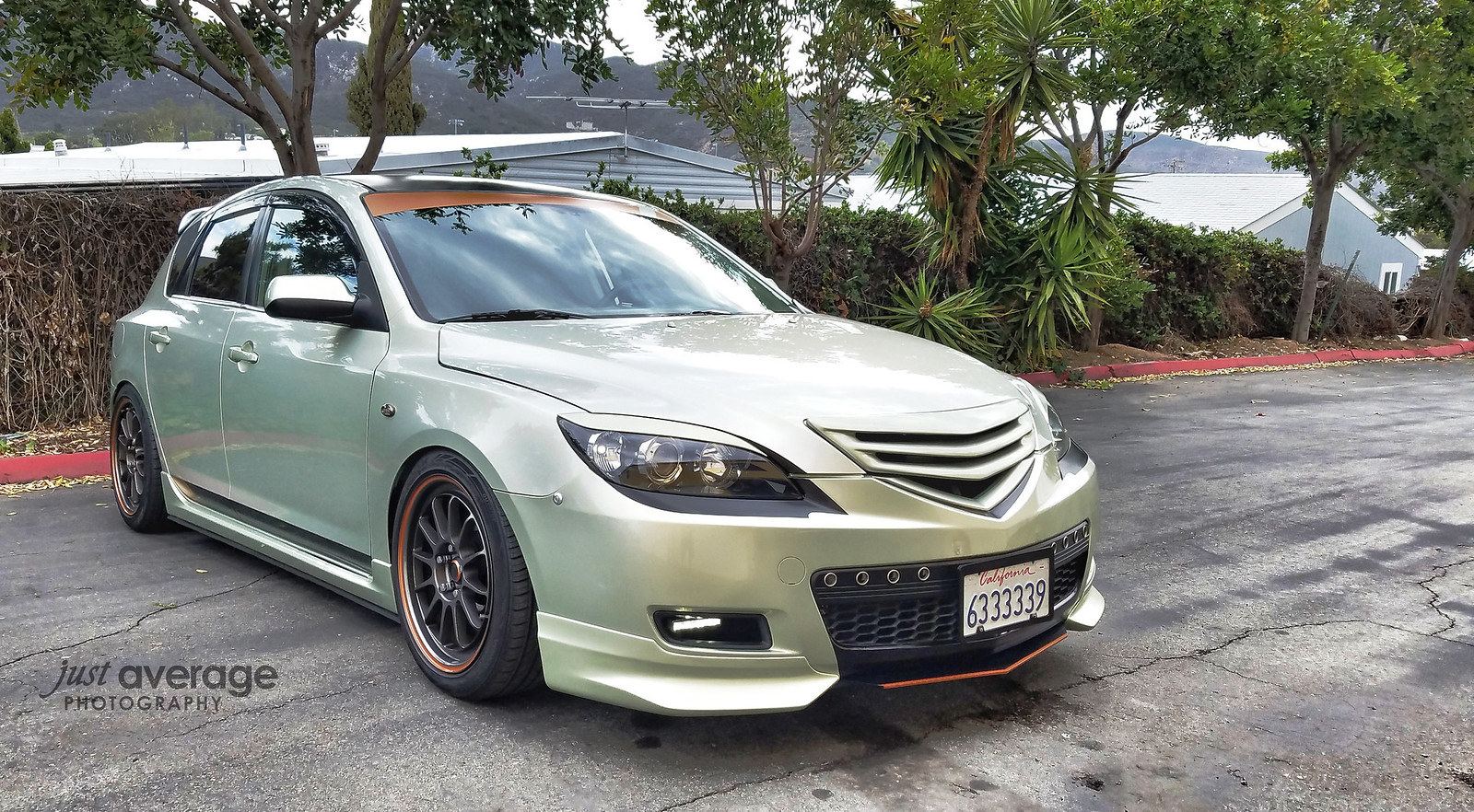

Bought new Lip Kit straight from Mother Russia, I was really surprised how the quality was of these things also the perfect fitment they too!
Installed & color-matched!...Removed the Blk Vinyl from the Bumper as well!...

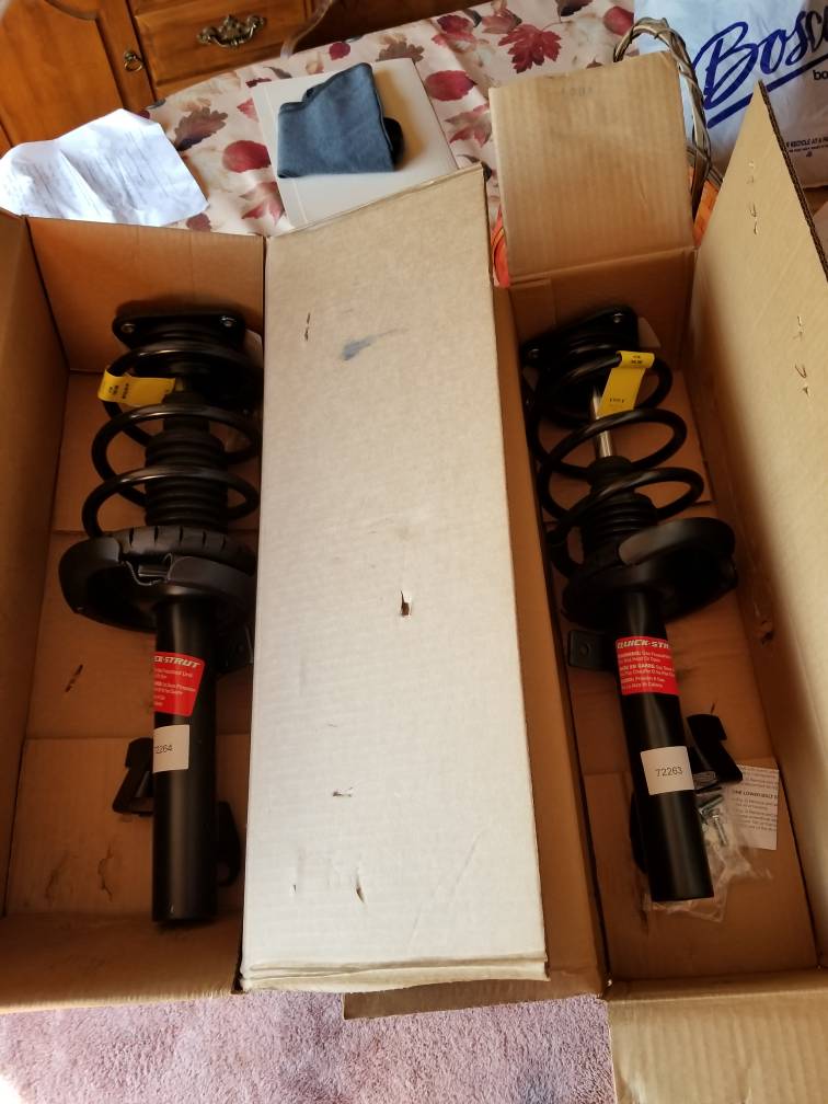

These just came in for the 2008. PS front is leaking so gotta swap them out to pass inspection.

Not much of a big deal....Re-did the Windshield Vinyl banner since the old one was 3yrs old and falling apart....Some other Cosmetic Changes I did, I re-did the Blk Vinyl under-shadow of the headlights to be more straight edge vs. a curvy area...I think it looks more aggressive!.
^^^^I like what you did with the shadow under the headlights and the bumper. Nice touch!

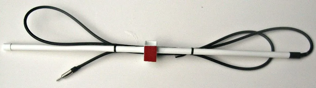

Added this new hidden antenna for the radio....kinda works well...stuffed it into the A-Pillar area for now to see if this is a good spot or not...
