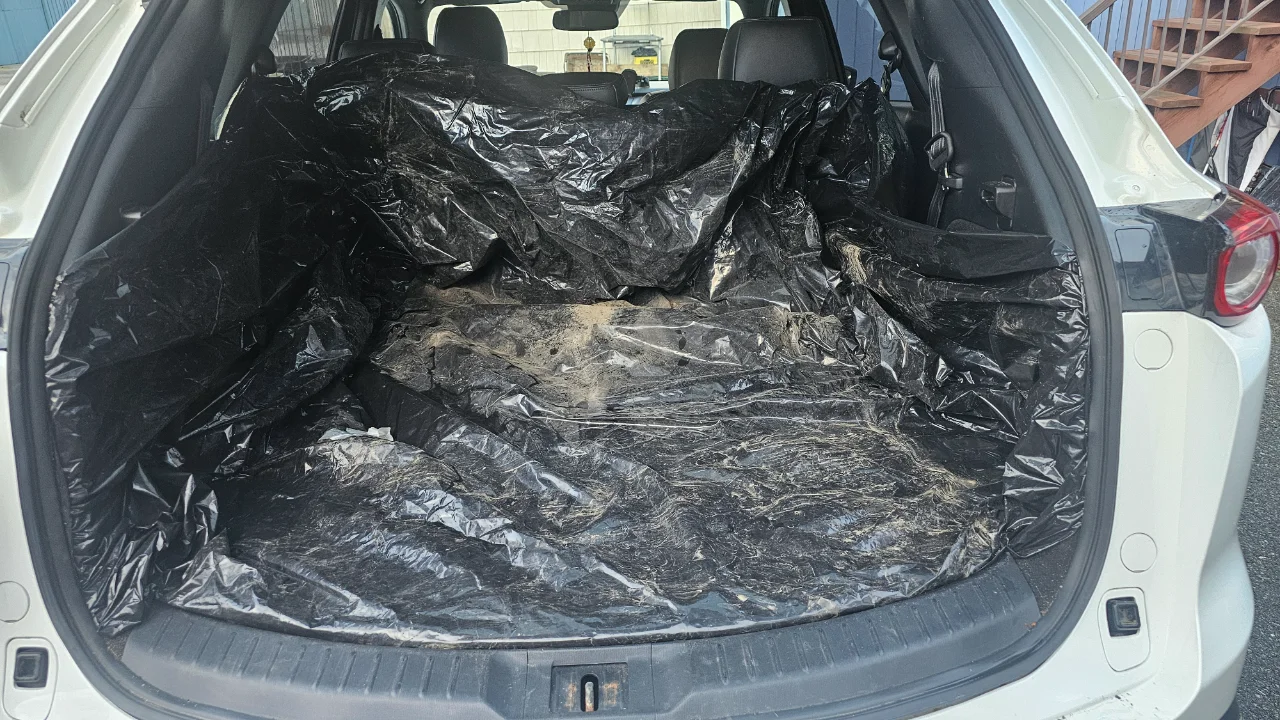

Nothing like a little winter prep haha, how do you all protect the boot?

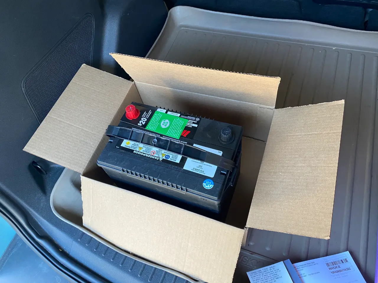

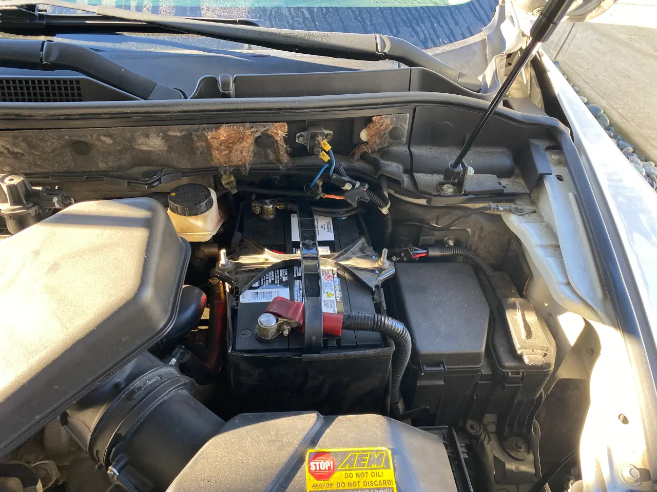

Battery time. The old one is almost 5 years old with just shy of 42,000km on it; it was dropping to 1.7-1.9v overnight.

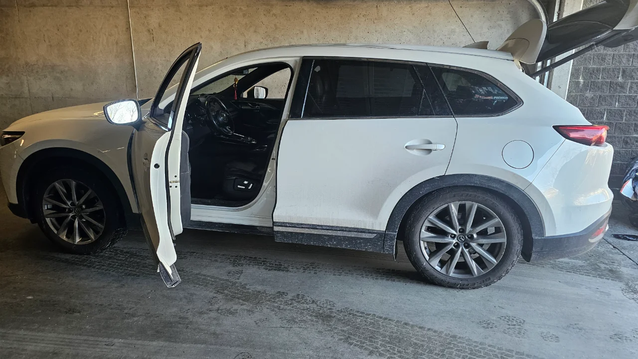

Anyway, they also washed the car for me because I forgot to ask them not to. Oh well, the car was filthy. They did leave some very minor swirl marks but that's ok, I planned to polish the car in the spring. They also cleaned the interior floor mats as well. Here's a pic for your troubles lol

I didn't mind them washing the car though. There is some micromarring but it's very minor. It'll come out in the spring polish no problem.

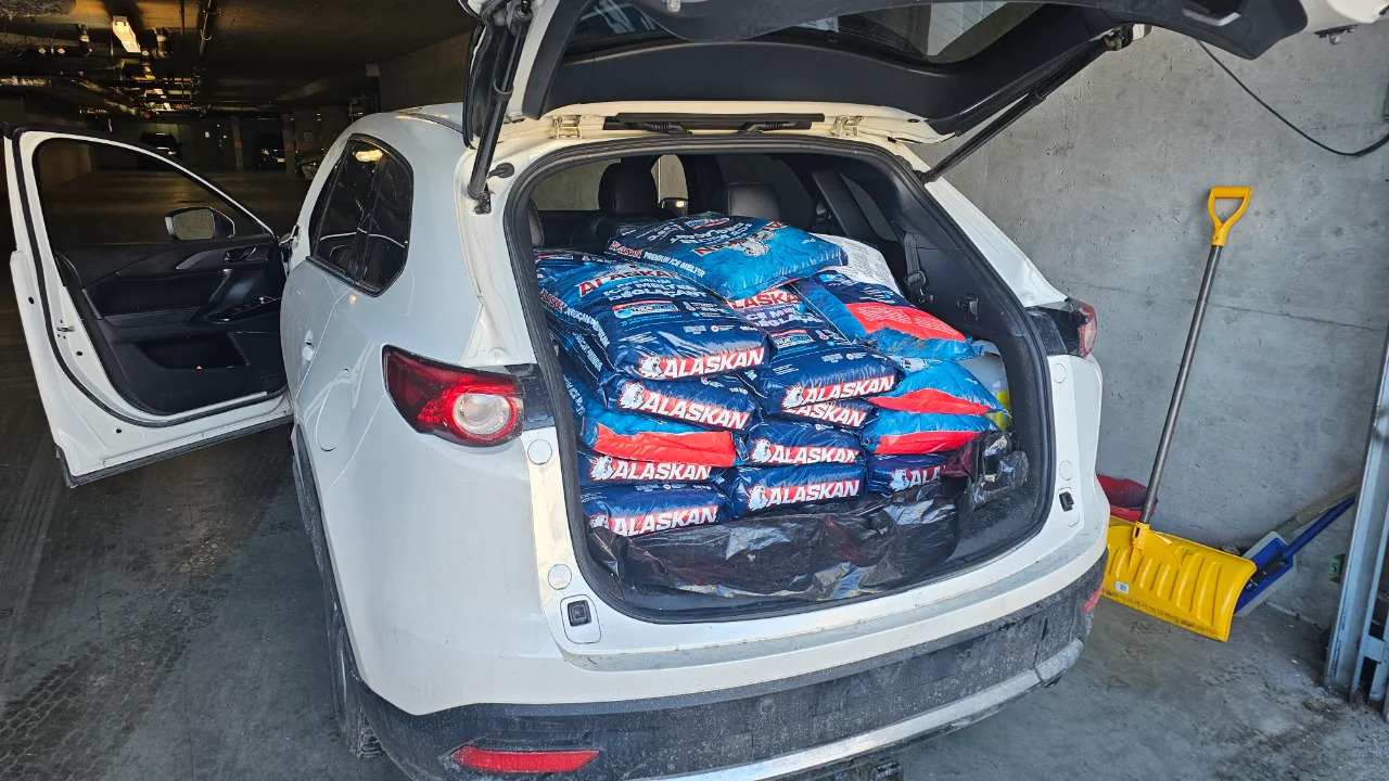

Looks like you're over the 650 kilo capacity. It could be hard on the suspension.
This is one of my lighter loads, insane traction on ice though. Kind of funny the 4runner lists it limit at 835lbs and 2019cx9 is listed at 1433lbs
