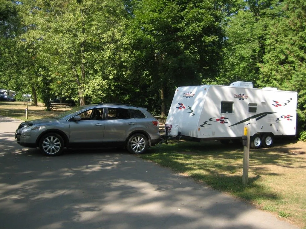

I towed a 21ft travel trailer on the long weekend and the ride was perfect. I set a rule for the trip that I would obey speed limits at all times and I can tell you it was hard to keep my promise, there was enough power reserve for speeding at most of the trip across the hills...

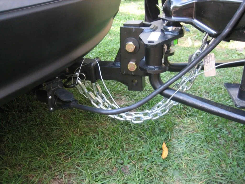

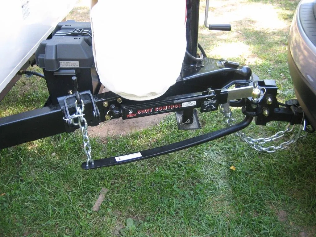

Rig - in bow to stern order:
  • 2007 CX-9 GT AWD with towing package (my understanding is this option is standard in Canada)
  • Hidden Hitch # 87438 Class III/IV round tube, 2 square receiver (Thanks Lexx for the great tip!)
  • Wiring harness: modified Mazda OEM wiring harness to accept brake control wires
  • Tekonsha Primus proportional electric brake control http://www.tekonsha.com/primusintro.html
  • Husky 70210 weight distribution hitch with round spring bars
  • Husky sway control RH#34715
  • 2008 Trail-Lite Crossover travel trailer TLX-210QB (21ft) http://www.trail-lite.com/PDFs/Trail-Lite-Crossover.pdf
I tried to keep the trailer as light as possible: no water enroute in any of the tanks (fresh water holding tank, gray and black water tanks. Heavy things like food, drinks, in the CX-9 cargo area in cooler boxes.
Braking: with appropriate brake controller setting I couldnt tell the difference when I hit the brakes.
Shifting: played around with the manual shifting by keeping the transmission in lower than D gears.
Coolant temperature: Same as without towing.

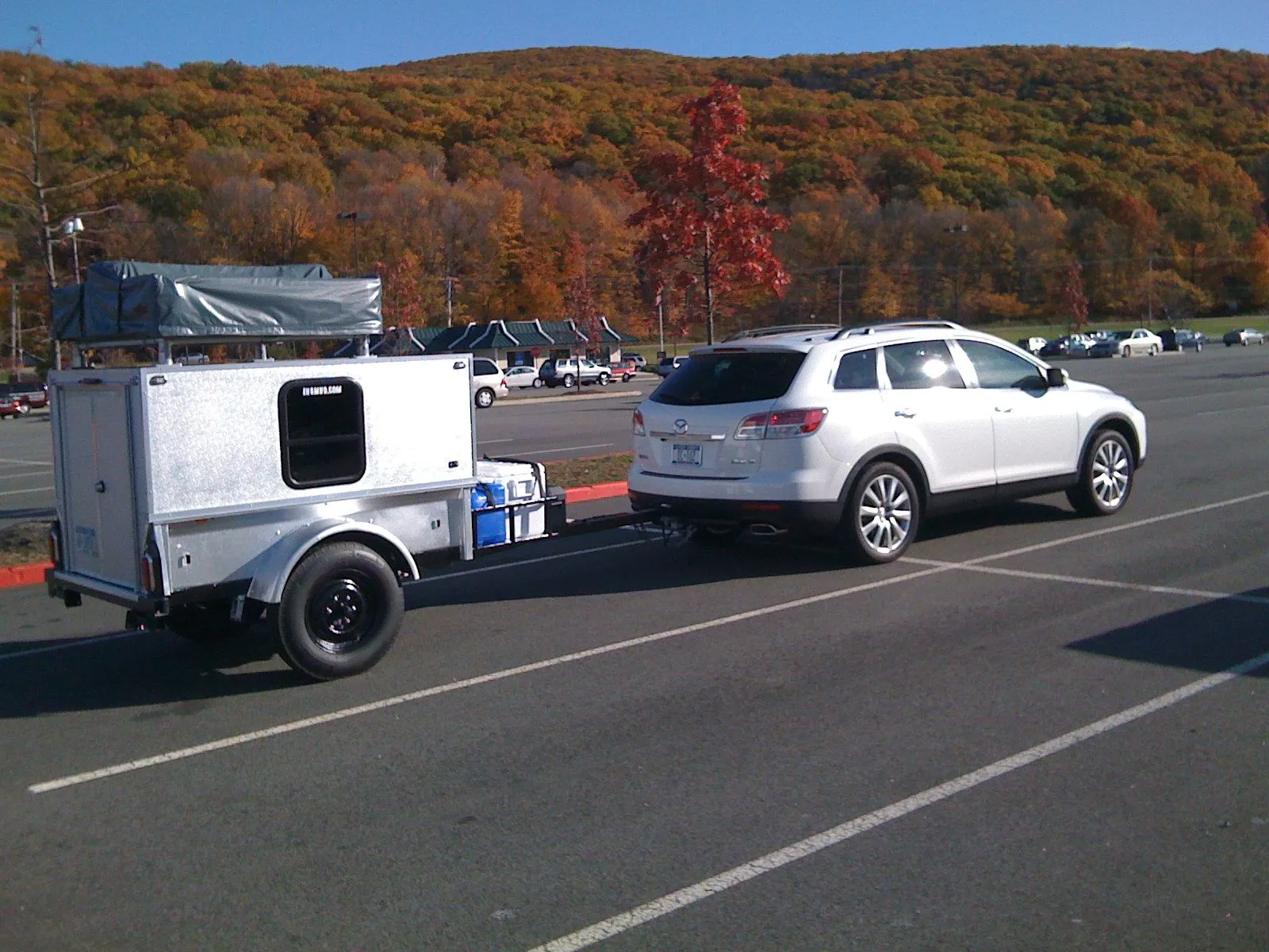

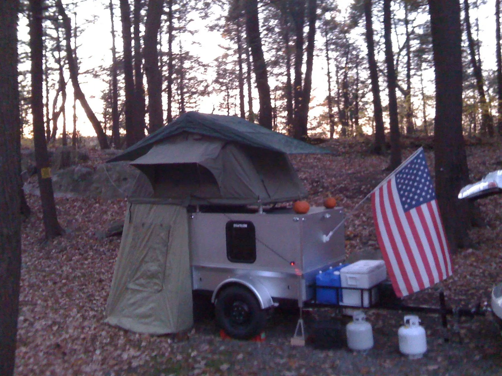

A little homemade jammi...about 1500 loaded with 21 gals. of water, 50 qt. cooler, group 27 battery and 300 lbs of gear inside. Lots of tongue weight..about 400 lbs., and she only went down about an 1-1/2". Very pleased!
