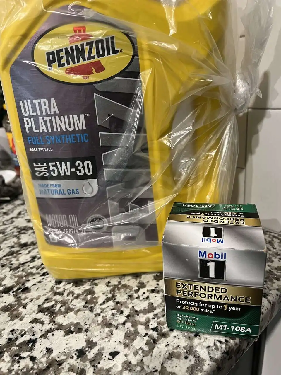

I’m settled on Penzoil Ultra Platinum 5w30 with a Mobile 1 oil filter. I change my oil every 3500 miles max. I drive about 50/50 city and HWY about 5 days a week, a couple family trips a year.
Are you aware Mazda uses a different OEM oil filter for your 2.5T, but Mobile 1 uses the same oil filter for both 2.5T and 2.5L NA?
Great Oil, terrible filter, Use a Wix 57002 or a Mazda 1WPY-14-302, the Wix is the only aftermarket filter that's designed correctly.
Wix claimed its 57002 is specifically designed for Mazda’s SkyActiv-G 2.0L / 2.5L NA which uses PE01-14-302A and 1WPE-14-302 OEM oil filters. Although Wix claimed its 57002 can also be used on the SkyActiv-G 2.5T, but it definitely has different specs to PY8W-14-302 and 1WPY-14-302 OEM oil filters which are used on the 2.5T. I wouldn’t use the Wix 57002 on the 2.5T.
