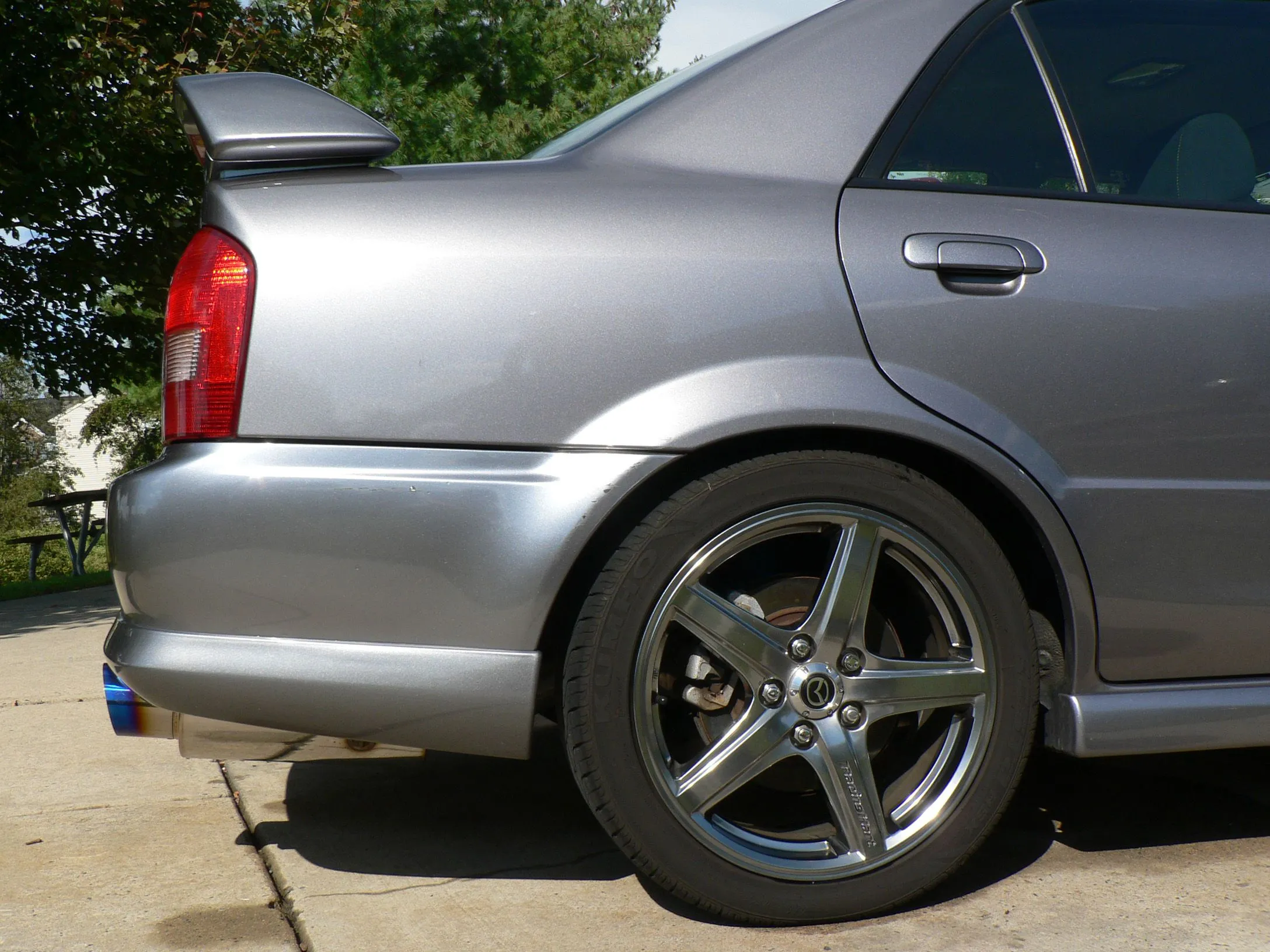

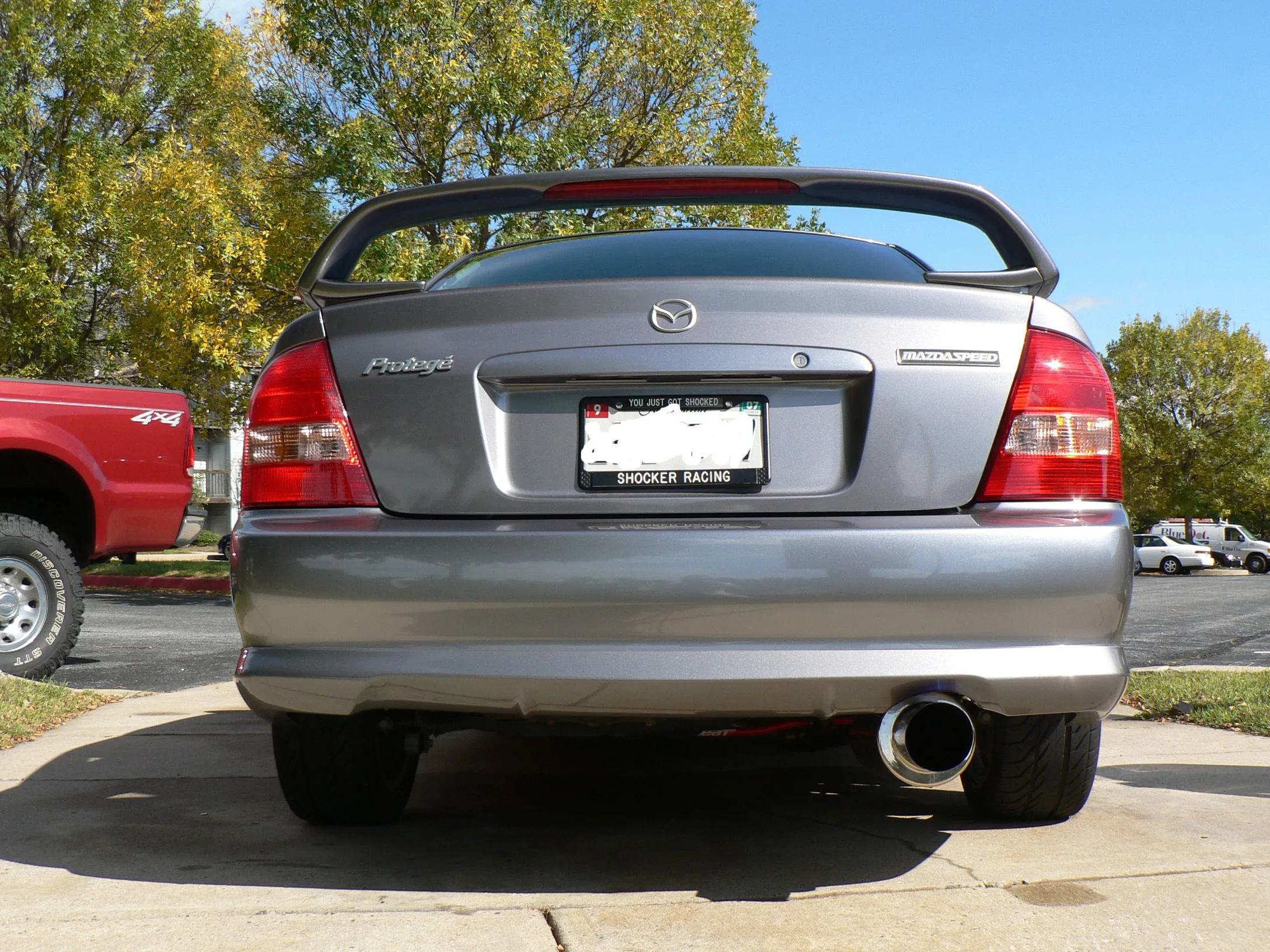

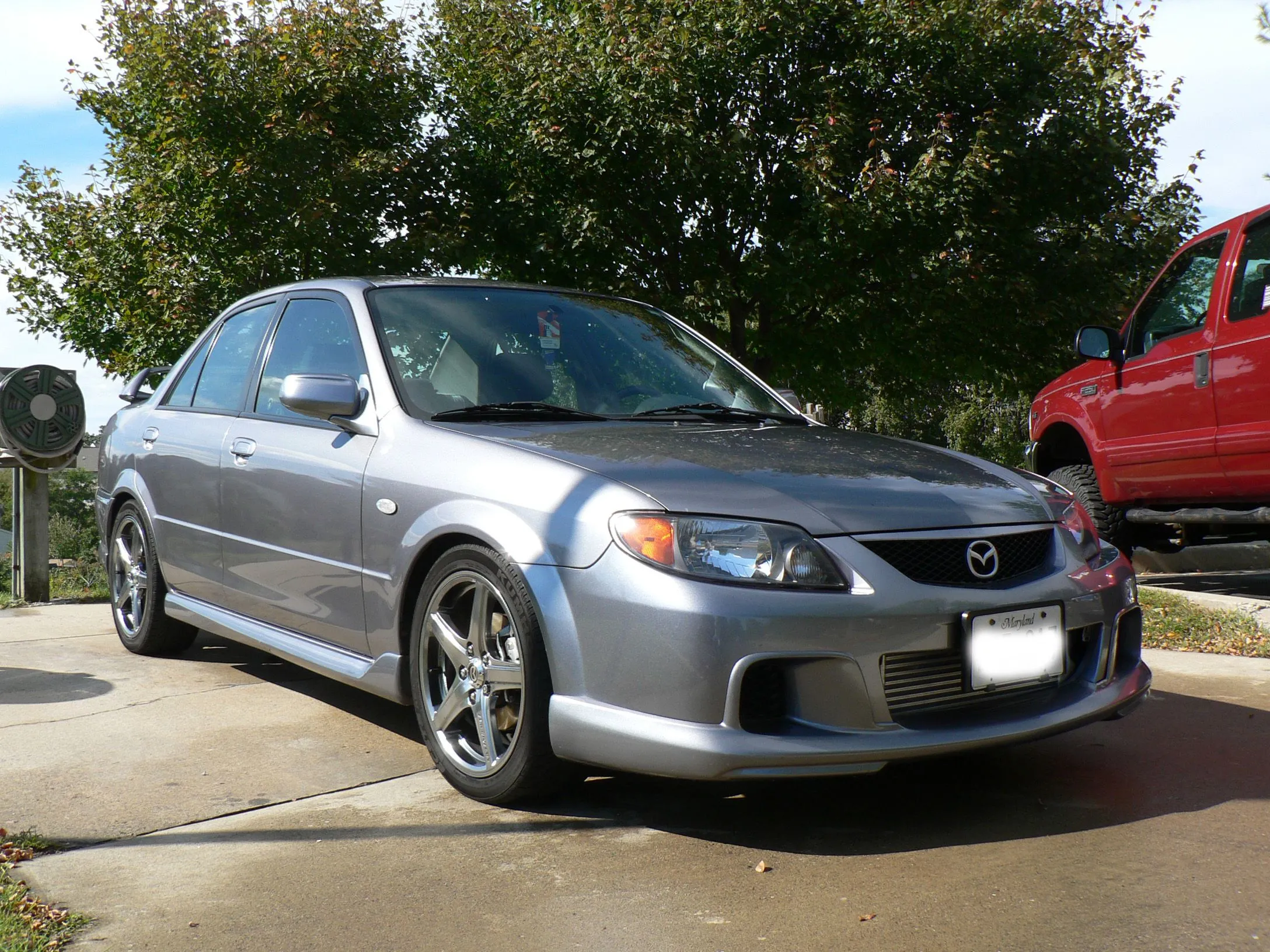

Just like the topic implies, does anyone use water/methanol injection on their MSP? My friend is a VW guy and it is pretty popular with them, it seems like a win/win honestly. I don't want rediculous power but I do want to run some good power (200whp) with some supporting mods and without worrying about my engine popping. Here is what I have done so far to the engine:
- Custom FMIC and Hardpiping
- 3" Full Custom Turbo Back Exhaust with Corksport S-Pipe
- Forge BOV (might switch out soon)
- Denso IK22 Iridium Plugs
I'd like to run 10-12 psi daily and without worry, right now I'm at 8.5 and I haven't adjusted the boost, just from the mods. Thanks for any suggestions and comments. I'll include some pics for views:)
