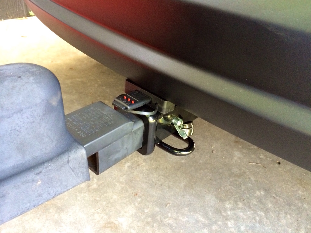

I used the $32 https://www.amazon.com (commissions earned) harness on my 2015 CX-5 GT and everything just plugged right in to the rear tail light connectors. Pretty easy install and didn't take more than about 30 minutes.

Are most of you running the trailer wire out the back door when in use or through rubber grommet in floorboard?
Thanks!!
I might just run out door for now. If I end up towing more than occasionally I might run through grommet and make sure connections are coated well with dielectric grease.
I don't tow often so I just leave it coiled up under the spare tire. Easy enough to just run it out through the hatch when needed. I keep a bike rack on my hitch just about 24/7.
Thanks!!
If you ever decide to run it underneath, you can put a cover/circuit tester on the plug for added protection (in addition to dielectric grease)
