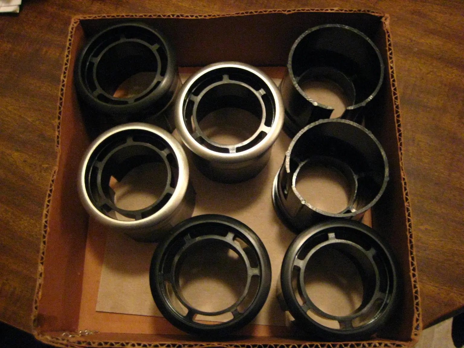

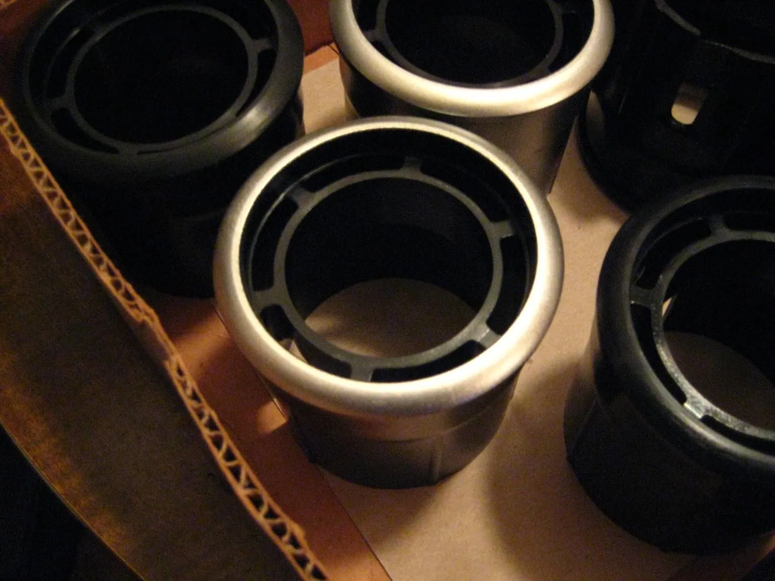

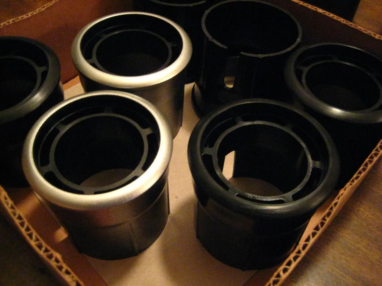

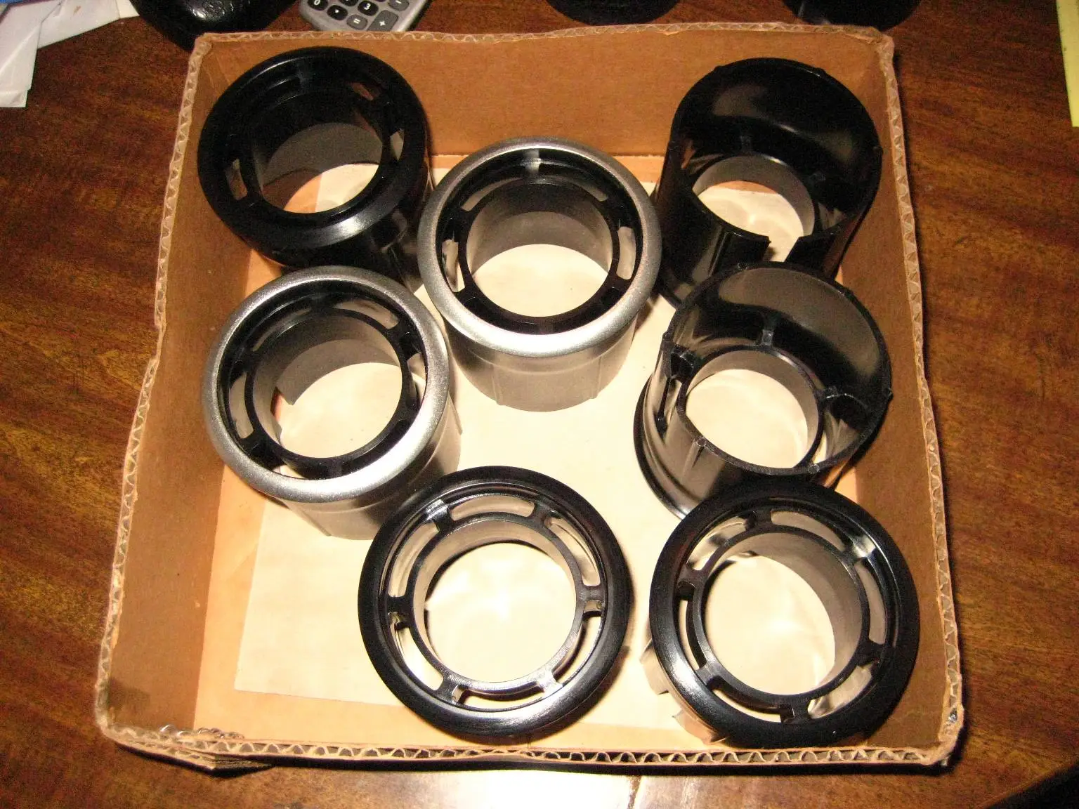

Okay people....here we go!!! I left the shop with 9 very nice samples in my hands. :) Here are some pics....
I've painted a couple just to give you a good view of what you'll be getting. ;)
I still have to check the size of the outer diameter by installing it into our "test vehicle". Once this feature is verified, we'll run the first batch of official parts. YEAH!! In the mean time, I'm sending two parts to The RPMStore for Donny's final approval. I'm very confident that he'll like what he sees. Giddy-UP!
Anyhow, have a look and let me know what you think.

The best part was that we made 15 parts in under 10 minutes!!! None of this waiting around for the resin to set up and all that garbage! They literally came "hot off the press", LOL!
They came out of the tool a bit big, but as they cooled, their dimensions dialed right in. We're seeing a shrink factor of approx. 0.7% (0.007" per inch).
We're going to let them sit for 24 hours and then take our measurements.
