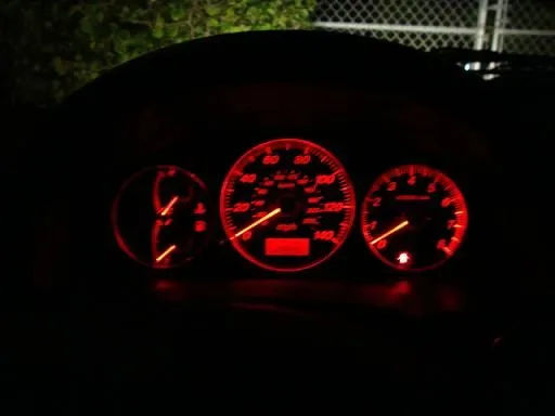

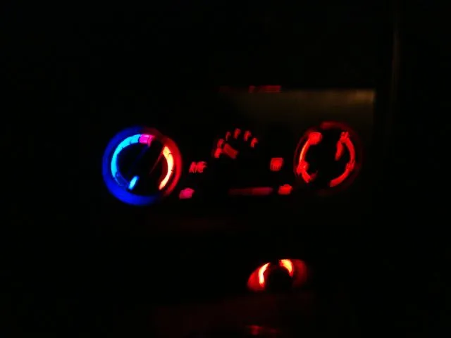

so which lights did you end up using for the gauge cluster that covers everything evenly? looks great man. also any pics of the hvac controls light up?

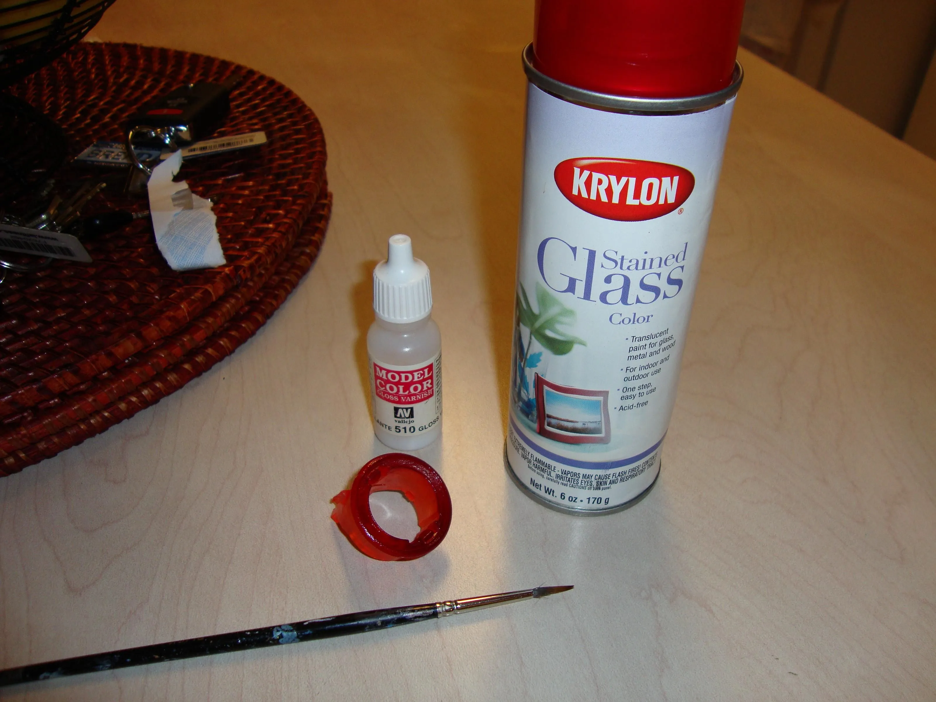

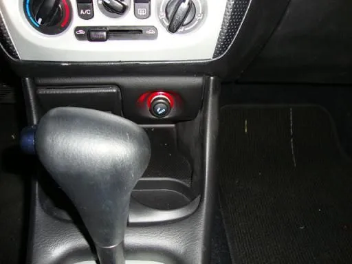

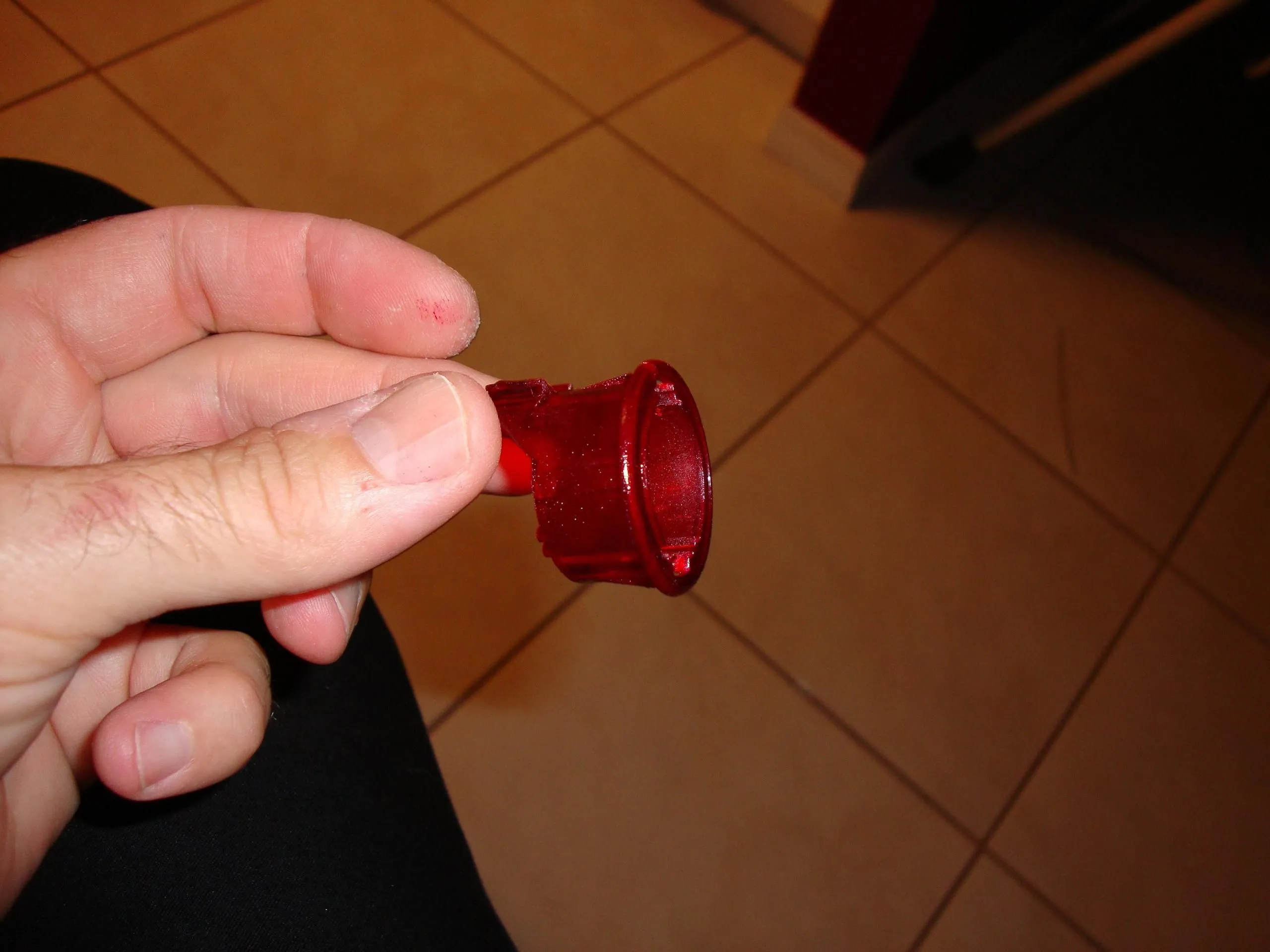

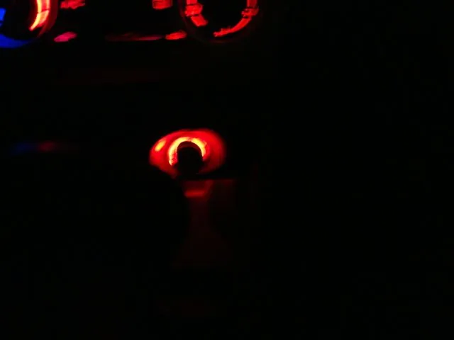

Here's some pics of the lighter surround.
Note that i used a clear adhesive and wrapped the LED stripe around,i have been looking to do this for a long time and only found cigarrete lighter surrounds in green or amber,so i painted the amber to red,i connected the wire of the LED stripe to the wire for the shift plate,also the blue side of the HVAC LED is connected to this shift plate terminal.
I am super happy i did,now i have some illumination down the cup holder too,a bonus.
Ok,i use 2 #194 (red)
http://cgi.ebay.com/ebaymotors/2x-T...ptZMotorsQ5fCarQ5fTruckQ5fPartsQ5fAccessories
2 #74 (red)http://cgi.ebay.com/Red-Wide-Angle-...=AU_Car_Parts_Accessories&hash=item2eb1253839
2 #74 (green) for the turning signals
i tried to add some LED strips and other lights but i just was obsesive with that,ultimatelly decided to leave the way it is,it looks fairly uniform lighted and bright,no need to mod,and if you read my prior posts you will see that i even messed up with the gauge faces and took the "green tint" off with acetone and tried all kinds of mods to make it more bright just to end up leaving the way it is.
really not necessary to go through all that if you put the right LED.
I hope it helps.
