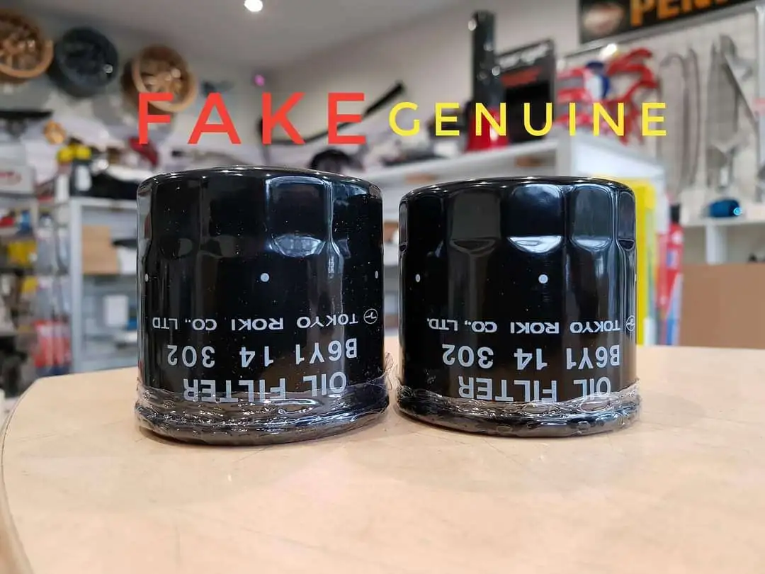

Amazon is selling counterfeit "OEM" parts as well. Check this BS out:
