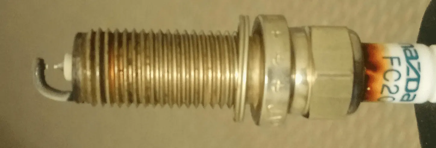

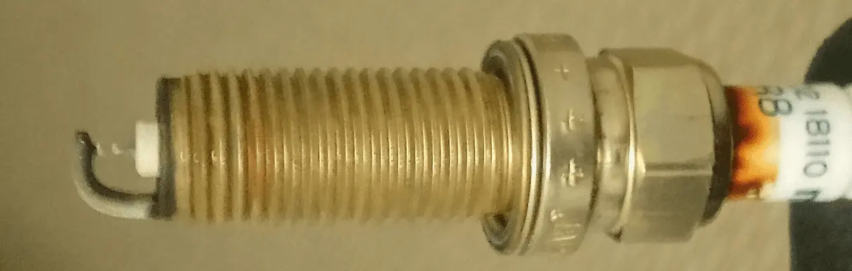

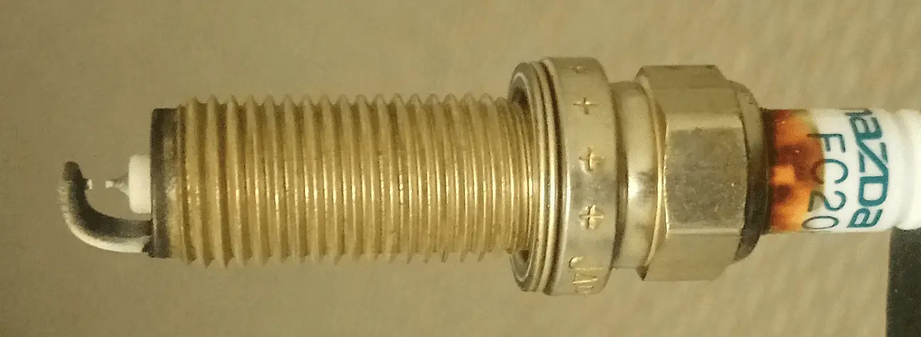

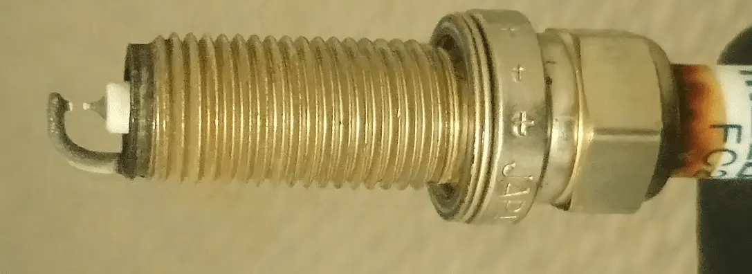

2013 @ 58k miles
OEM plug is PE02 18110 / FC20HPR8
No Oil residue and with normal (light tan) burn at the electrode

Also, WOW! Gene...your plugs look amazing compared to mine. Mine were oiled to hell and back.

I was surprised to see that too. Decided to check first before buying a new set (based on your experience) and not make unnecessary replacement. Ill check back again @ 75k miles (as per maintenance). Oil change are done conservatively in the dealership for this and never used aftermarket oil and oil filter.
And also, am using K&N filter since the day one I took delivery on this, maybe the better air flow contributed to the reduction of the blowby.
