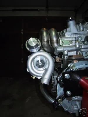

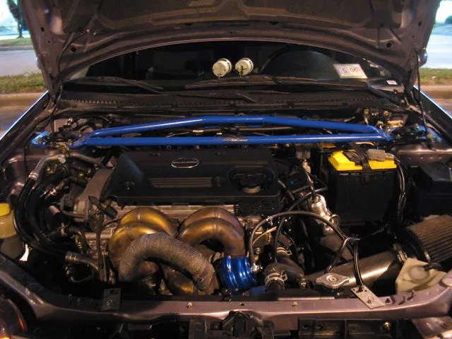

^^ Very nice! And I see your MAF is relocated, too .. Did that cause any difficulties with tuning? Have you run a dyno yet?
