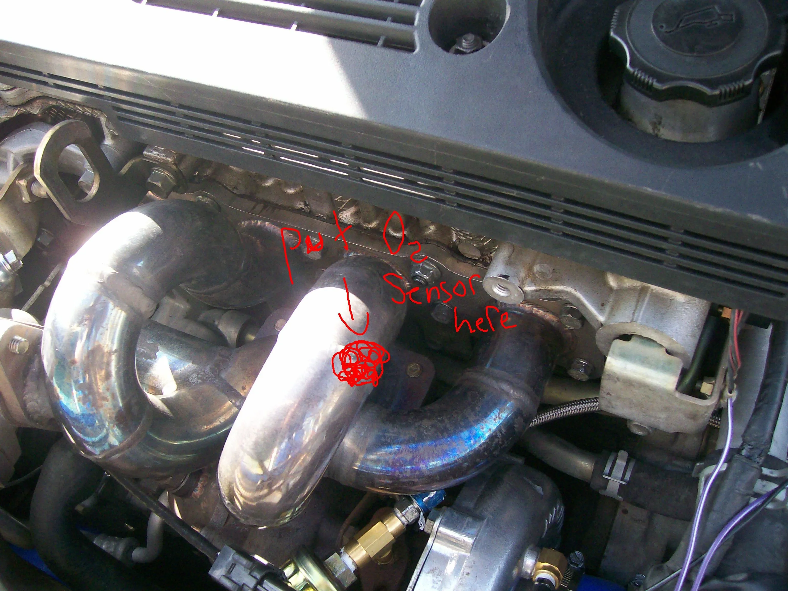

I think it's the O2 location, more than the dump. Where is the O2? Can you post a pic? Custom is running a dump with a thunder mani.
This is the set up, to bad I didn't get a shot of it on his car.
see how the dump is kinda on a isolated runner though i think that the sensors still getting a good reading from the 2nd runner on that setup...

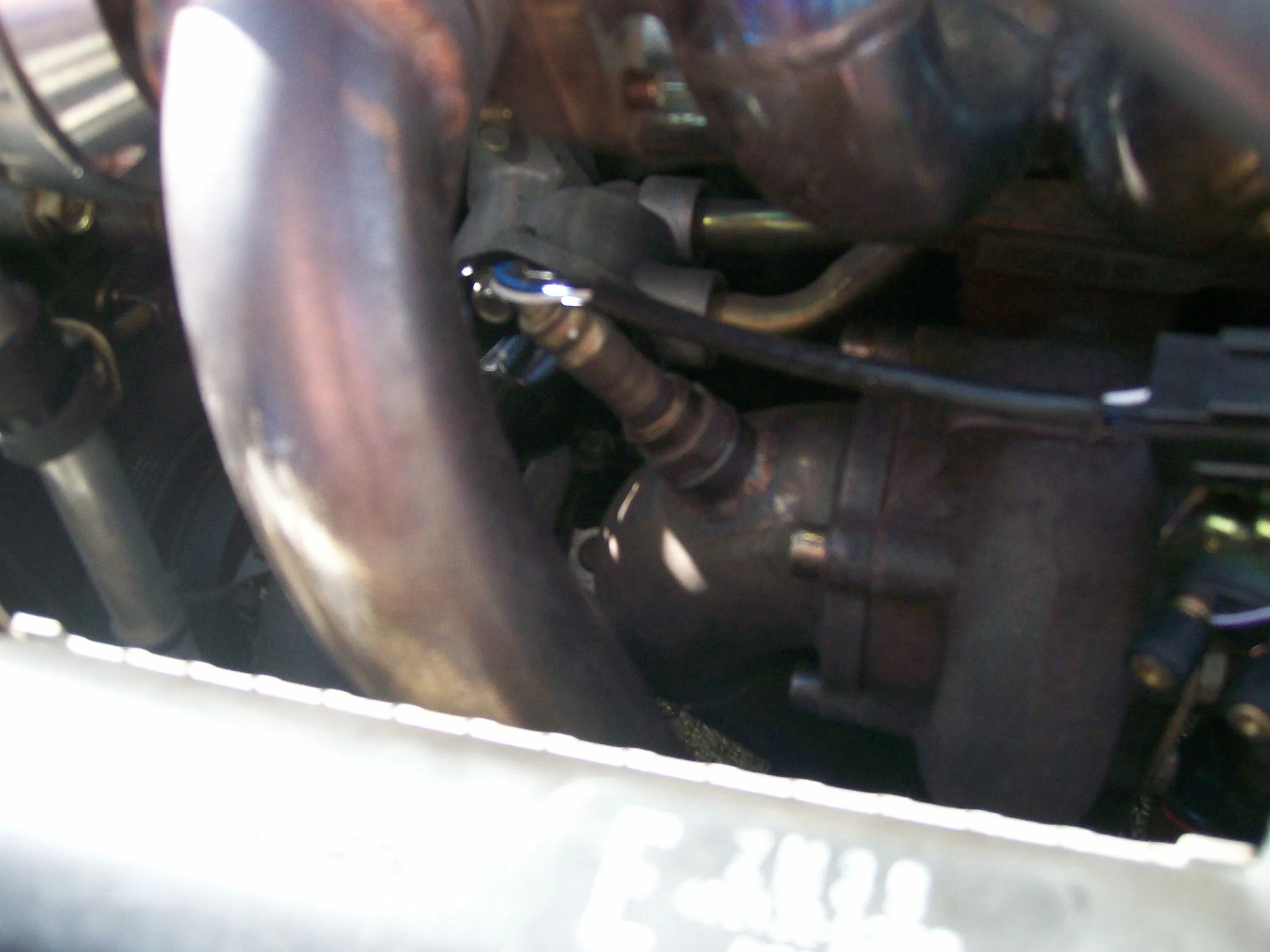

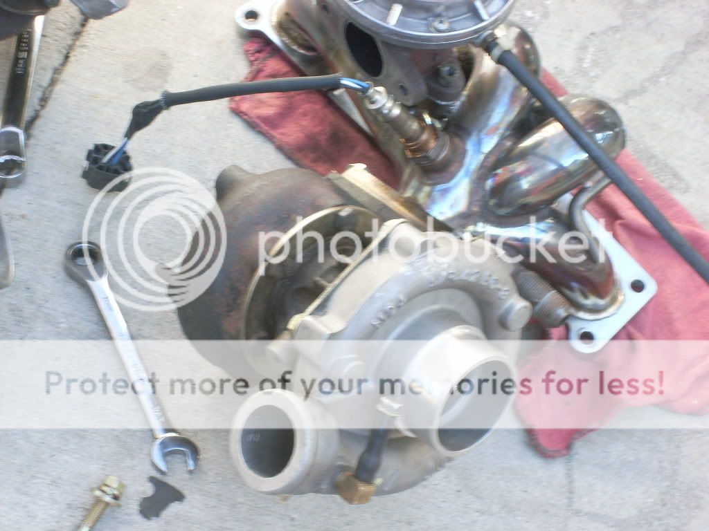

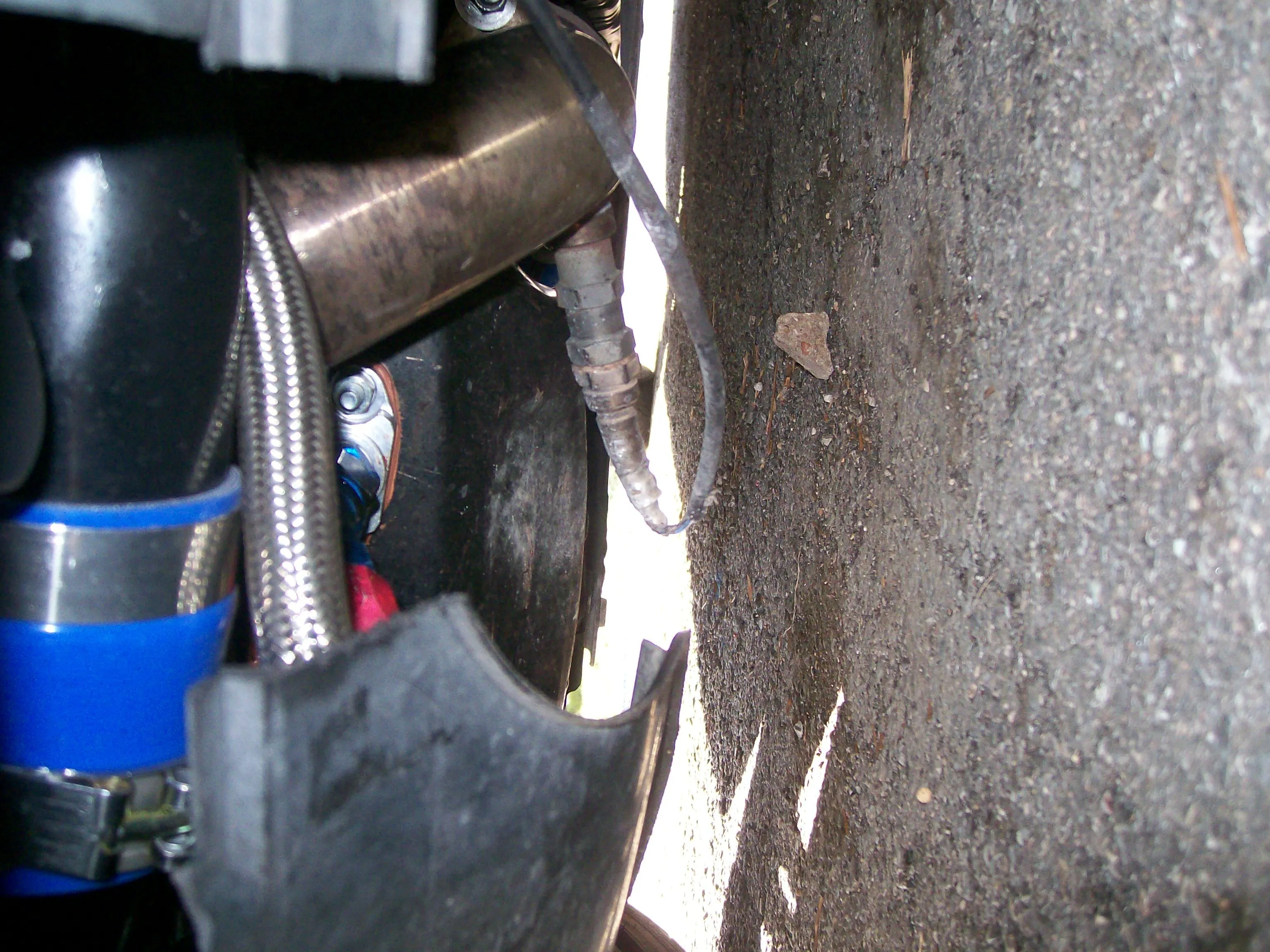

heres some pics..its seems as though i royally screwed up my 2nd o2 sensor last night though...but no cel has came on which is really weird...
I think a good spot to move the o2 would be on the 2nd big runner opposite the dump
PS ANYONE KIND ENOUGH TO DONATE A SPARE SECOND O2 SENSOR? POR FAVOR (I will definitely be moving it to the midpipe bung lol)
