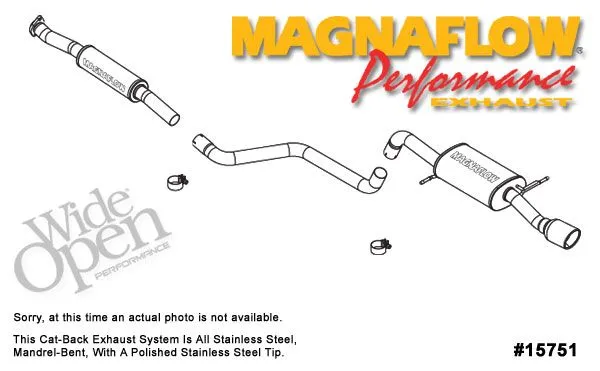

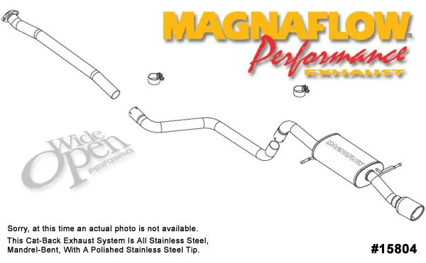

the two magnaflow systems will bolt up the same, but they are actually different. the turbo system does not have a resonator, while the NA system does.
15804 is the turbo system
15751 is the NA system
