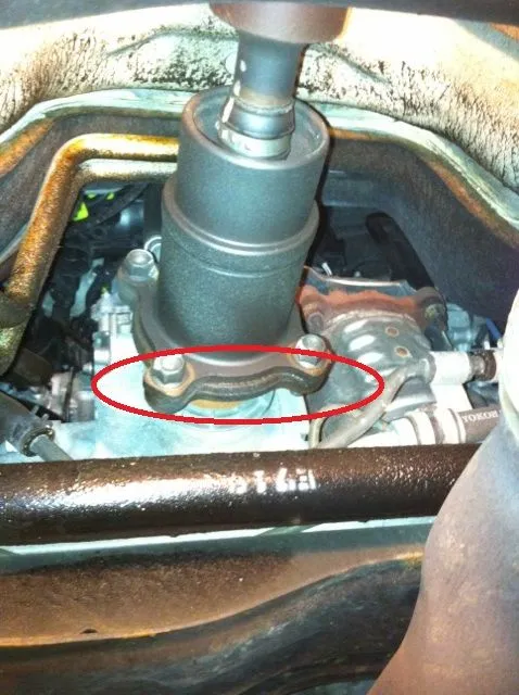

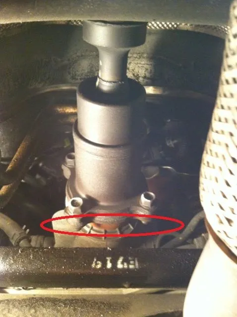

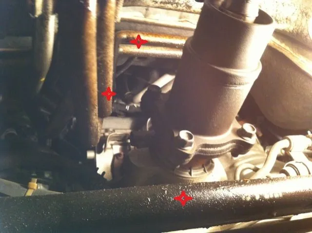

Calling all Mazda Gurus out there! After replacing the busted struts and shocks at 77k miles, my mechanic found another problem. With the truck lifted up, we saw there are oil splashs around the transmission and driveshaft area. He called his parts supplier and ask for a replacement part, but that dude said I have to replace the whole driveshaft?!!(freak) My mechanic said he'll ask around so I want to get some insights from my fellow 9'ers too.
By the way, do you think is this also the reason why I feel "Mild trailer-hitching sensation" once in a while?
The red circle is the place where he found leakage. It's right between the transmission and the driveshaft. The red stars are the oil splashes found. The bottom of each pic is the front of the truck. If any of you knows which part I should replace, please do let me know and I appreciate it very much! *part number would be nice too!

Not familiar with that area of the vehicle, but I see no sign of a leakage source in the area. It makes me wonder if someone was careless with an oil refill or something, and what you're seeing is runoff that hit the shaft and got thrown everywhere. Also, it seems from the shots that what we're seeing thrown around inside looks dry, and the only fresh oil is on the round cross-member. ( ? ) Just a thought.
I agree with drchuck.
"oil splashs" does not mean there is a leak.
From the pics, I don't see any leak source at all.
