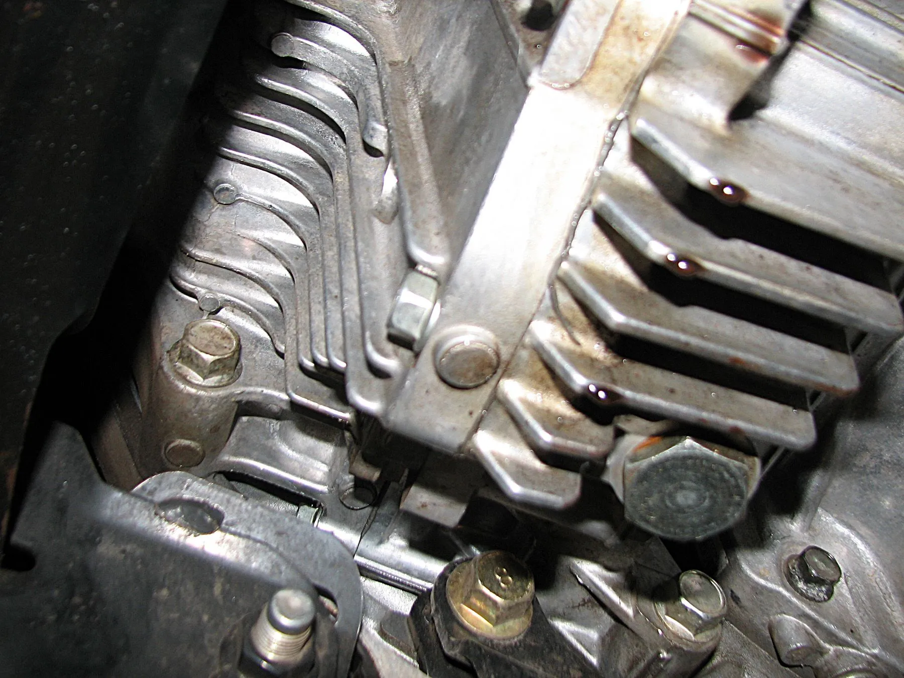

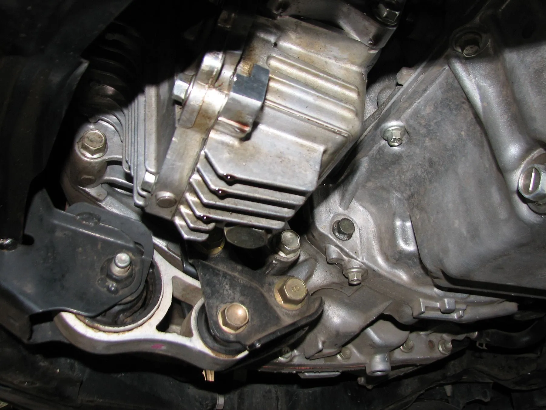

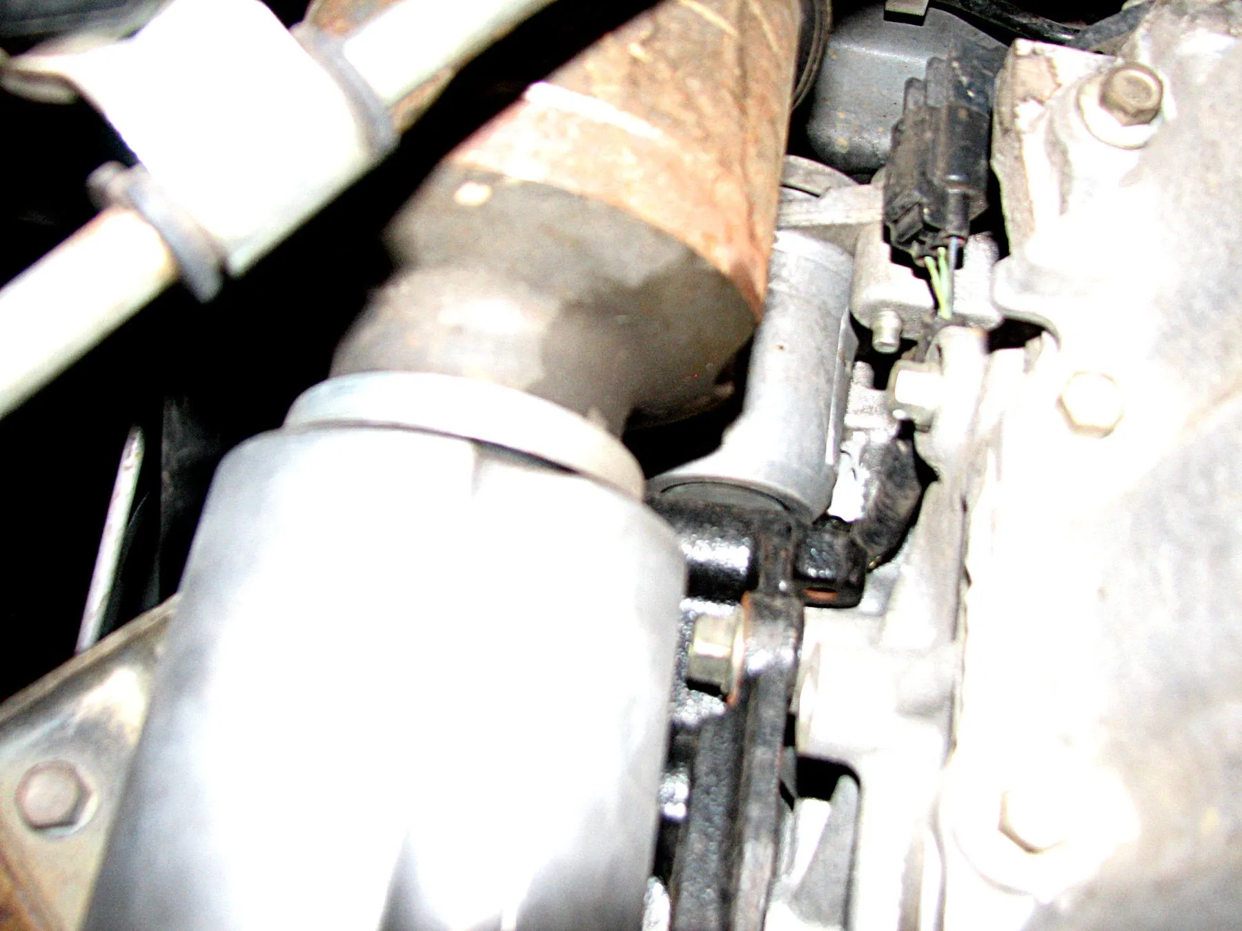

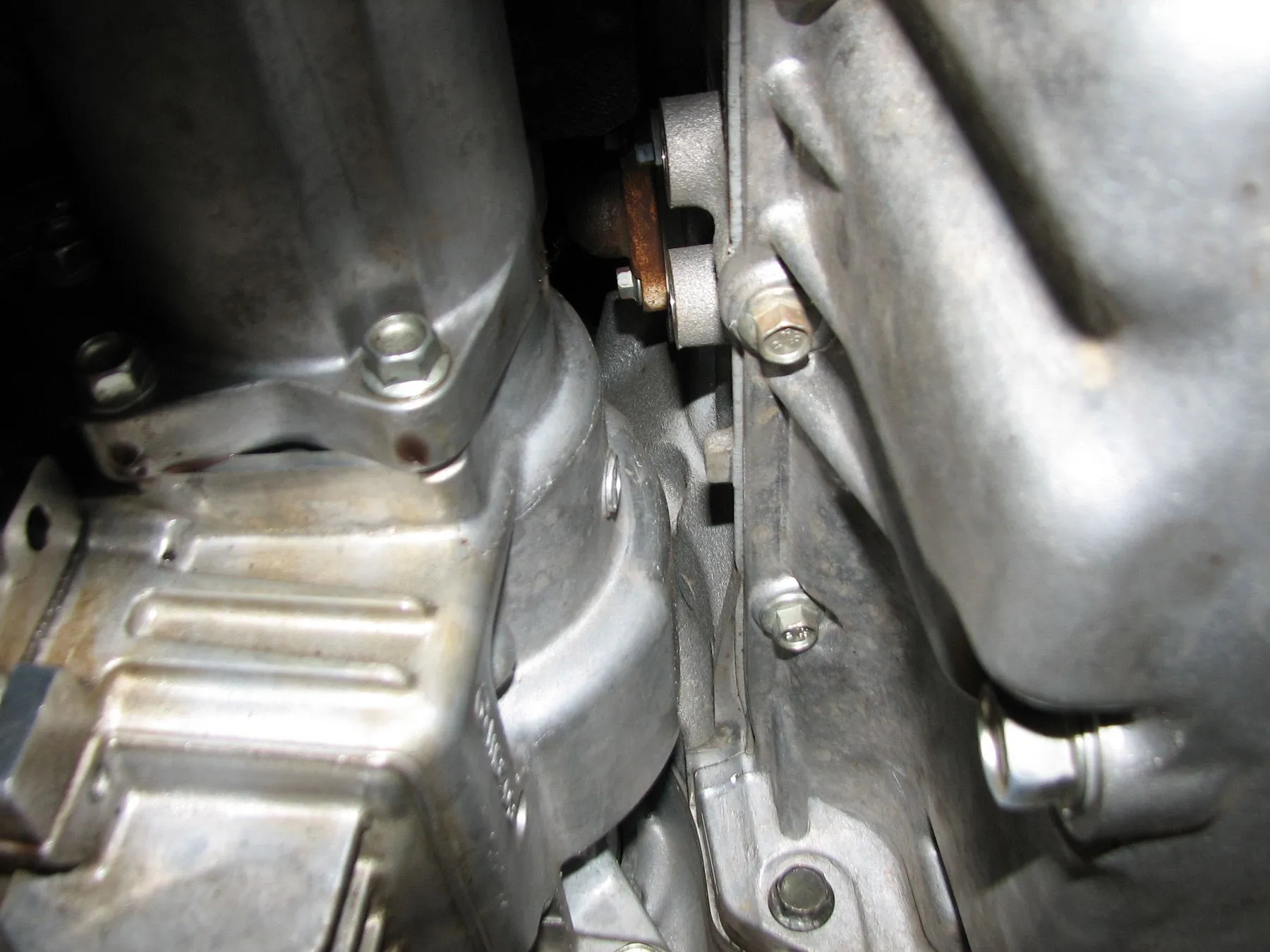

leak pics
pictures of present leak

We had the samething on the transfer case, we were told that when they assembled the car that the fluid was put in before the gasket material wasn't setup. We took it in under warranty and it been fine since.
It takes 2 hours, minimum to have the RTV set up enough so it doesn't leak. I generally wait overnight when I do the sealant on transmissions.
