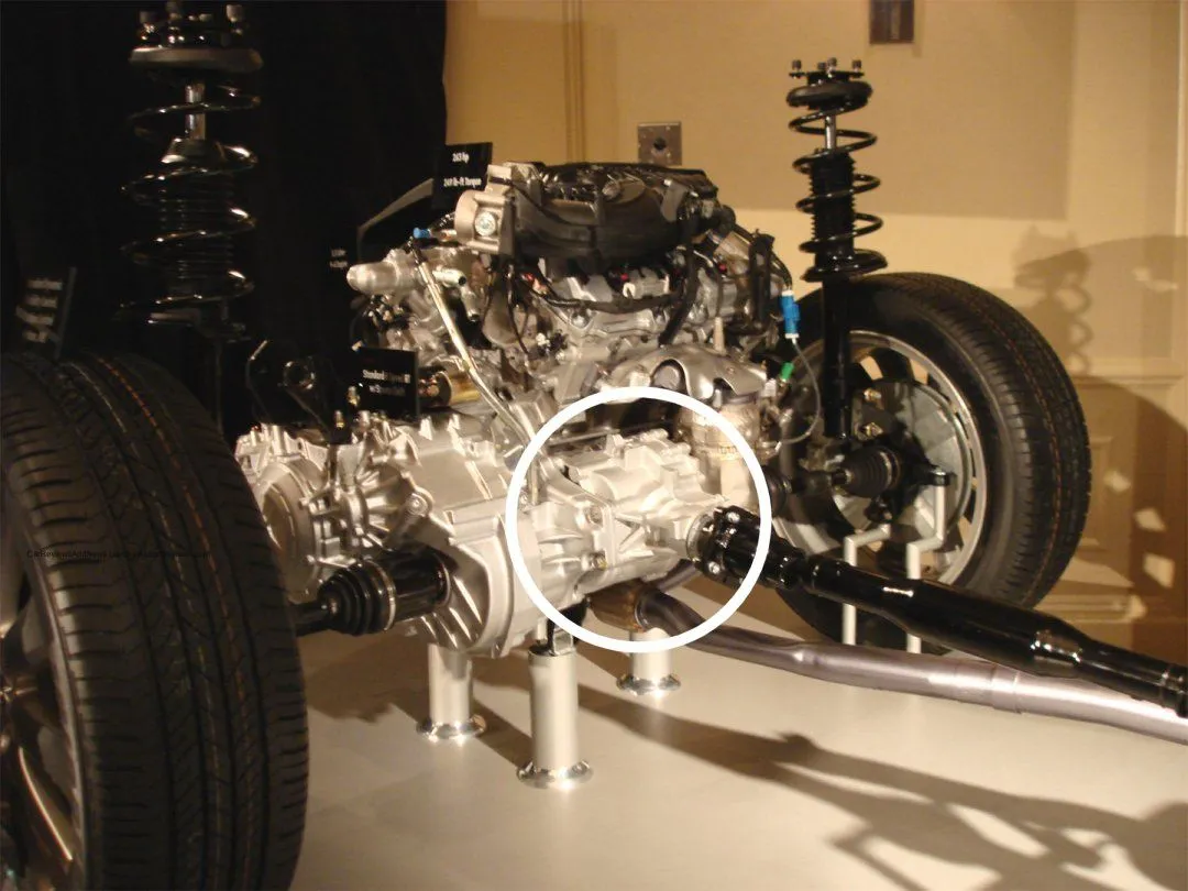

So they replaced the PTO attached to the transmission. Not the rear differential.
If I read my workshop manual correctly, in Mazda terminology, the unit that attach to the transaxle is called "transfer case". It transfers torque to the rear and the drive shaft is always rotating when driving. The unit that attaches to the rear differential (in front of it) is called "coupling component", which is a viscosity based multi-plate coupler. Once electronic signal is sent to it, the viscosity thicken and the plates engage one another, therefore, torque is passed thru to the rear drive shafts. The amount of torque transfer can be controlled electronically (up to 50%).
The one pointed out by sportowner is the transfer case. The one in front of the rear differential is called coupling component. In Mazda terms, that is.
Thats why I asked. Technically, the 'transfer case' is nothing more than a PTO (Power Take Off) The actual diversion of wheel power is done at the differential.

I know. Some people mistakes the rear coupling component as the transfer case, which is actually in the front attached to the transmission. Some people call the transfer case PTO.
