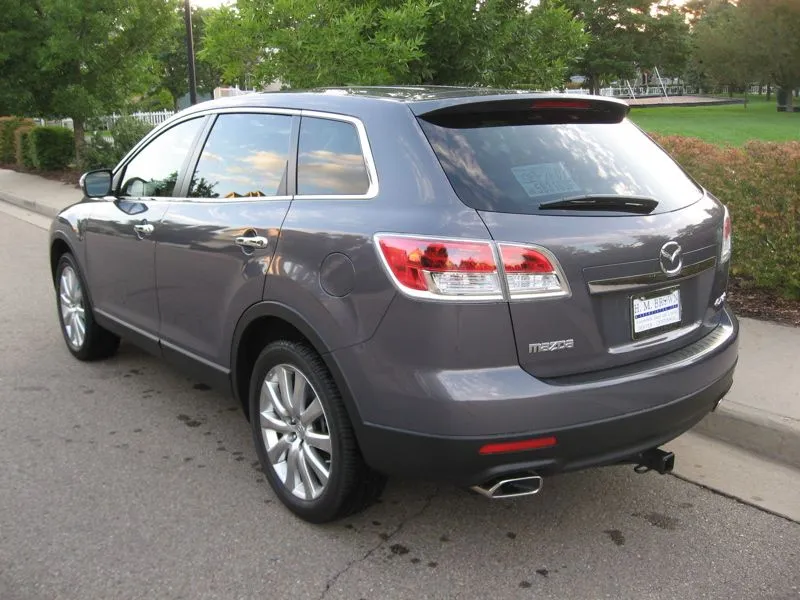

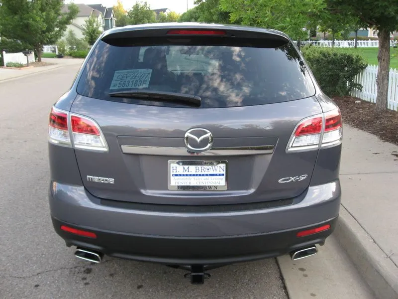

I installed the 2" receiver Hidden Hitch a couple days ago. It's a pretty easy install - just 6 bolts. I've attached a couple pictures. Looks just fine to me...
