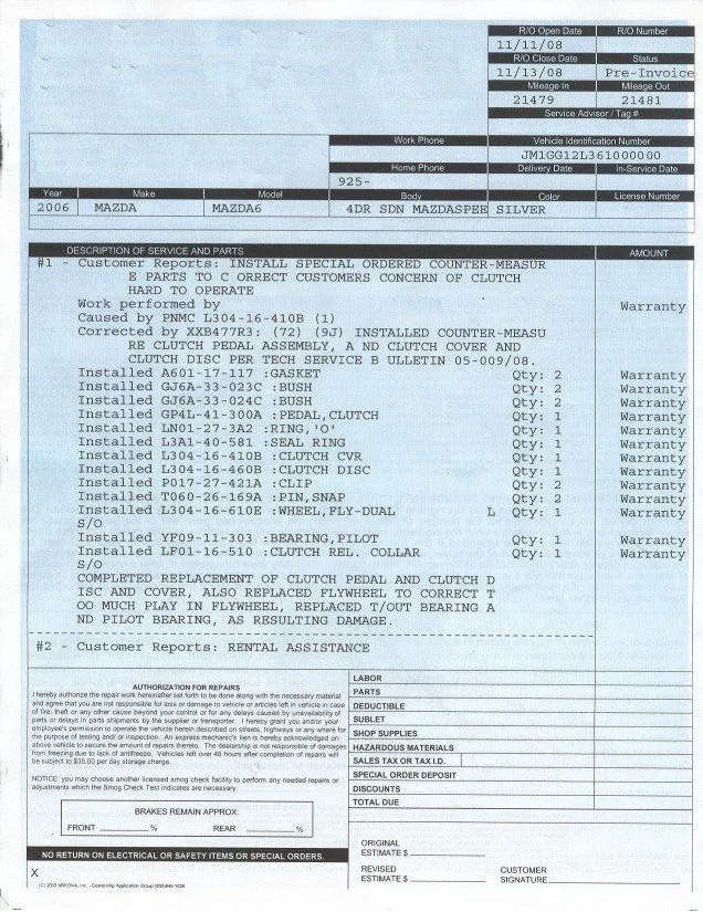

Sorry for the delay. How about a MS6 clutch replaced at 20K miles per the TSB? Hitch receiver on the car. 'nuff said. As time permits, I will scan the paperwork for the h8rs.
Added: Hope to scan the docs by the end of the coming weekend: 11/15-16.
Warranty Work w/ Hitch Receiver on the MS6
Background (fast & loose w/ specifics):
San Francisco Bay Area.
New Owner, Used 2006 MS6 @ approx. 19K Miles.
Early MS6 (VIN is very low).
Clutch was a *big* problem.
Ride to live (not live to ride).. bicycles.
Hitch Receiver added to MS6... customized Mazda 6 pre-fabbed part.
No towing... using a hitch-mounted bike rack.
Post-Hitch Receiver Installation:
Visited dealer to program keys.
Bicycle rack was on the car.
Inquired about the clutch.
The Service Manager agreed there was a problem.
The clutch was replaced (see attached). The flywheel was loose!?
The only comment that was ever made about the car was with respect to the flywheel being loose. "Hard driving?" was the query after the fact. Actually, the car was never driven hard because the clutch was so darn awful to use.
The new clutch is over-the-top excellent. The car is so much more fun to drive. It is so easy to use the clutch, a new driver could learn how to handle a stick (manual tranny) with this car.
The work order / receipt has been edited for privacy reasons. Of course, you can always find me by looking for a MS6 with a hitch-mounted bike rack.
For good measure, it is worth noting that the clutch replacement was for exactly the reasons stated in the TSB. This car was a pain to drive. It was fun, but now it is a blast.
Everything here is on the up & up. The Service Manager was extraordinarly professional and a pleasure with which to do business.
