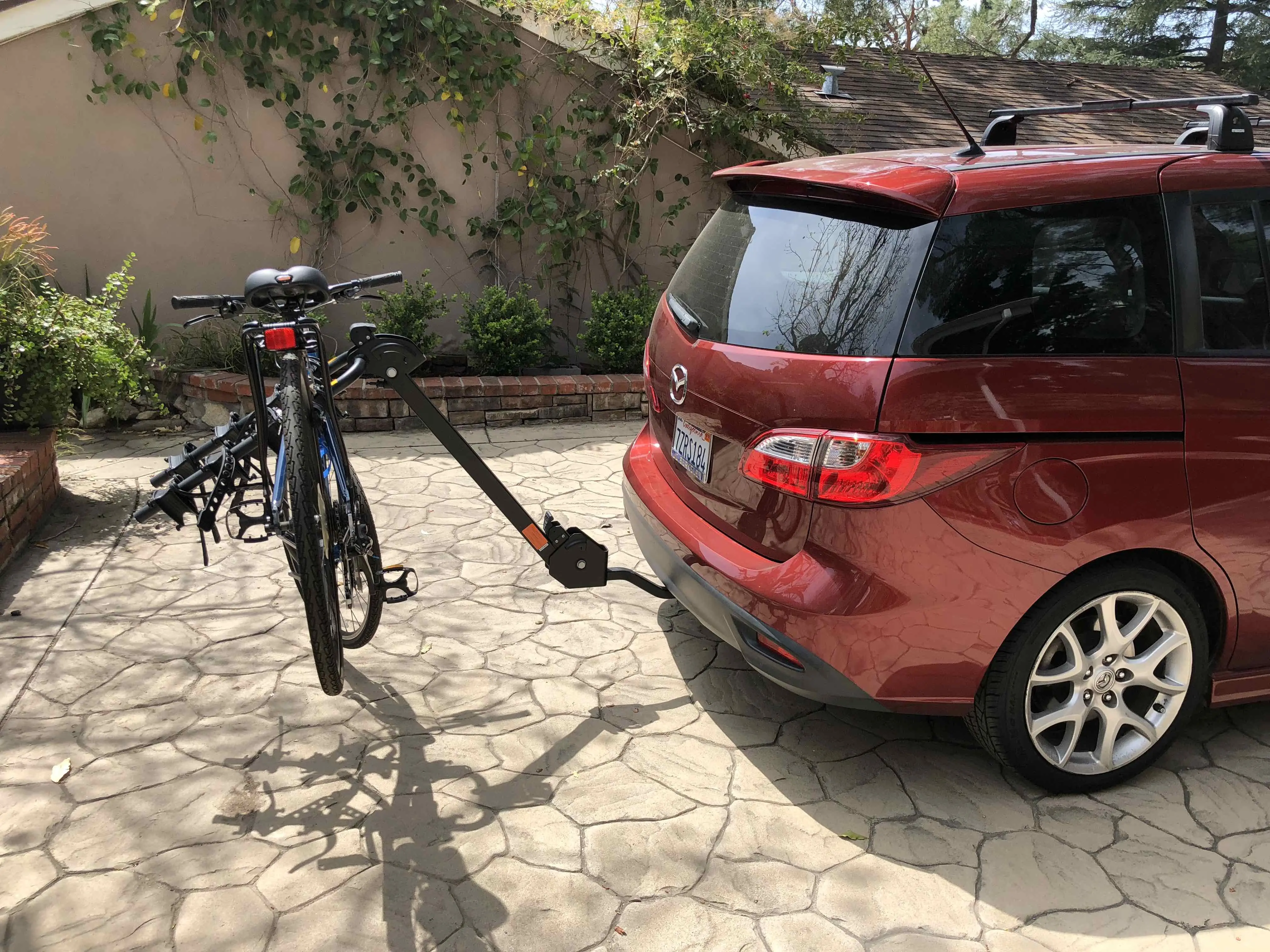

So how did this work out for you? I want to do the same thing: carry 4 bikes (2 adults and 2 kids) with my Mazda5.

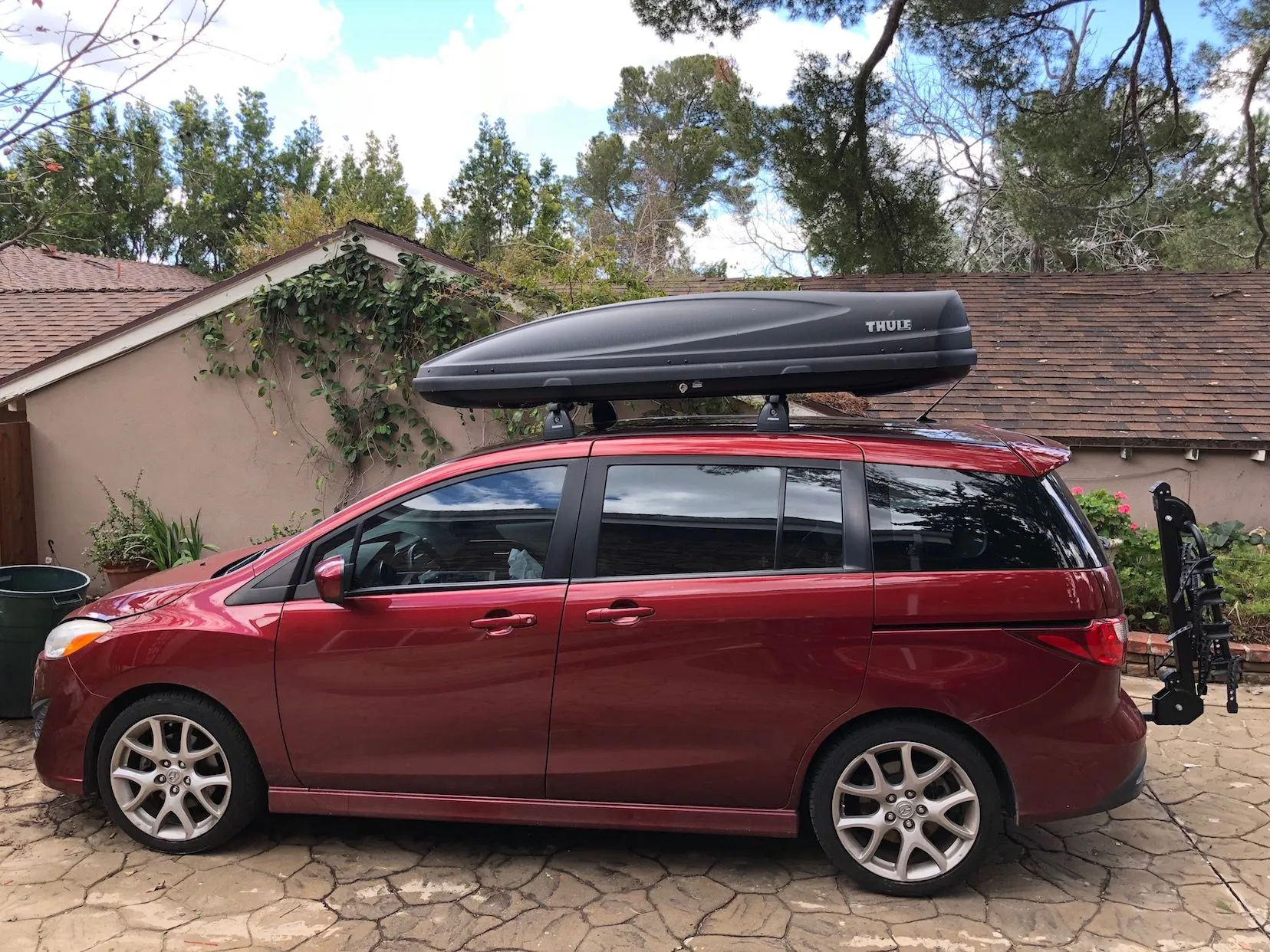

Just got home from 2200 mile road trip through mexico. 6 people. Full loaded roof rack and roof box 21 cubic feet. 24 MPG. Pics attached per your request

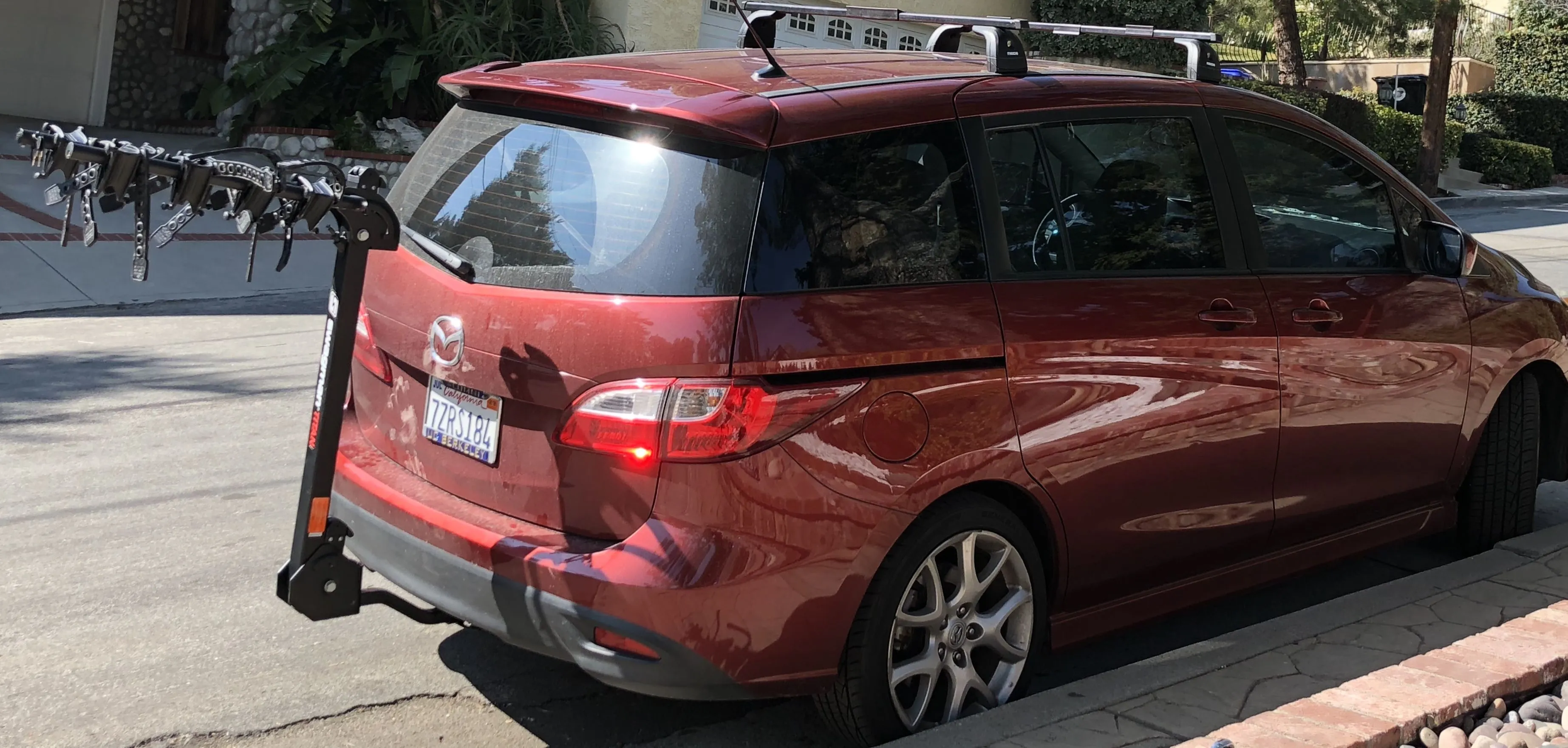

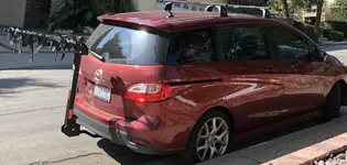

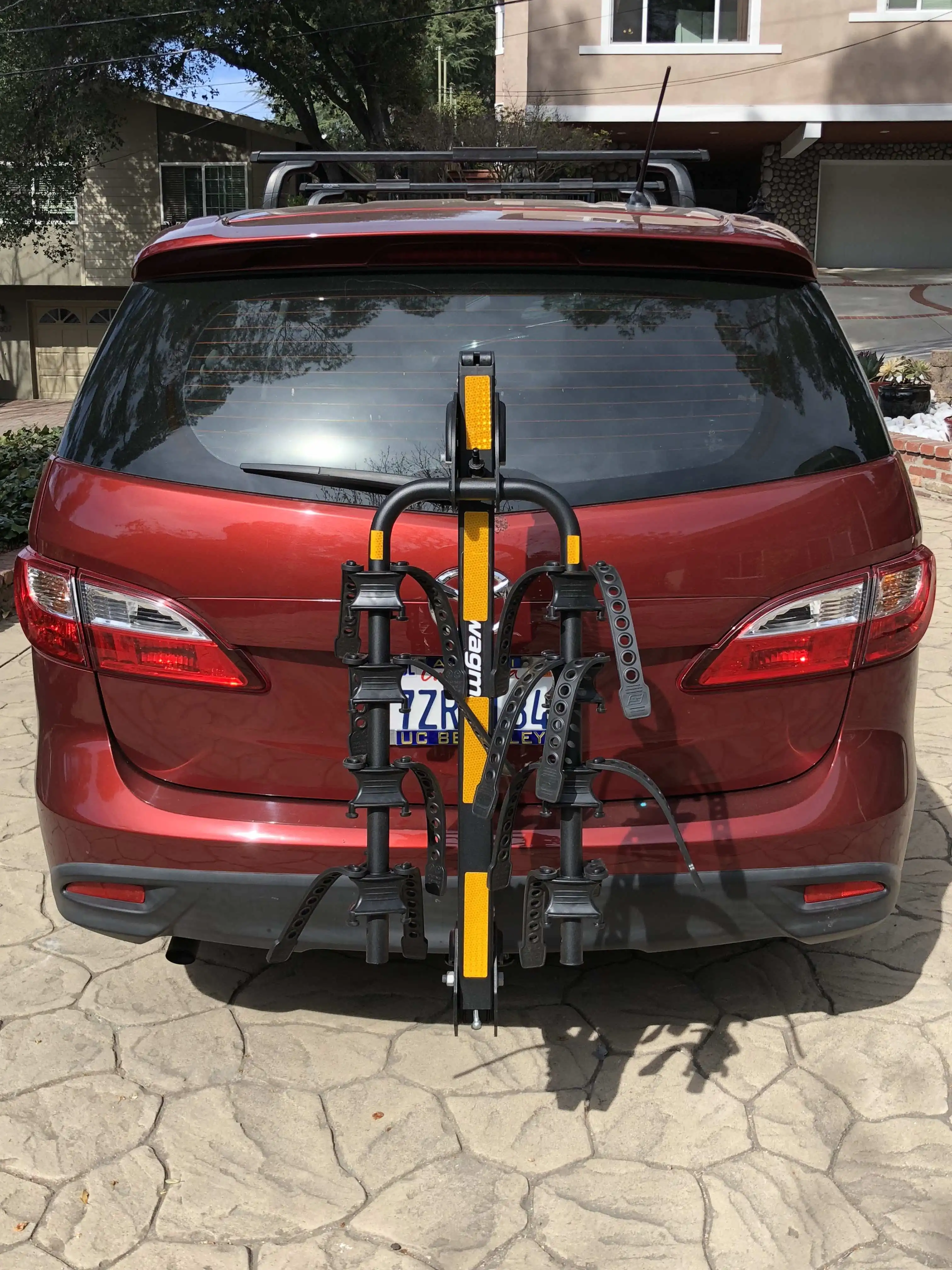

I had my wife take some pics before her bike ride.

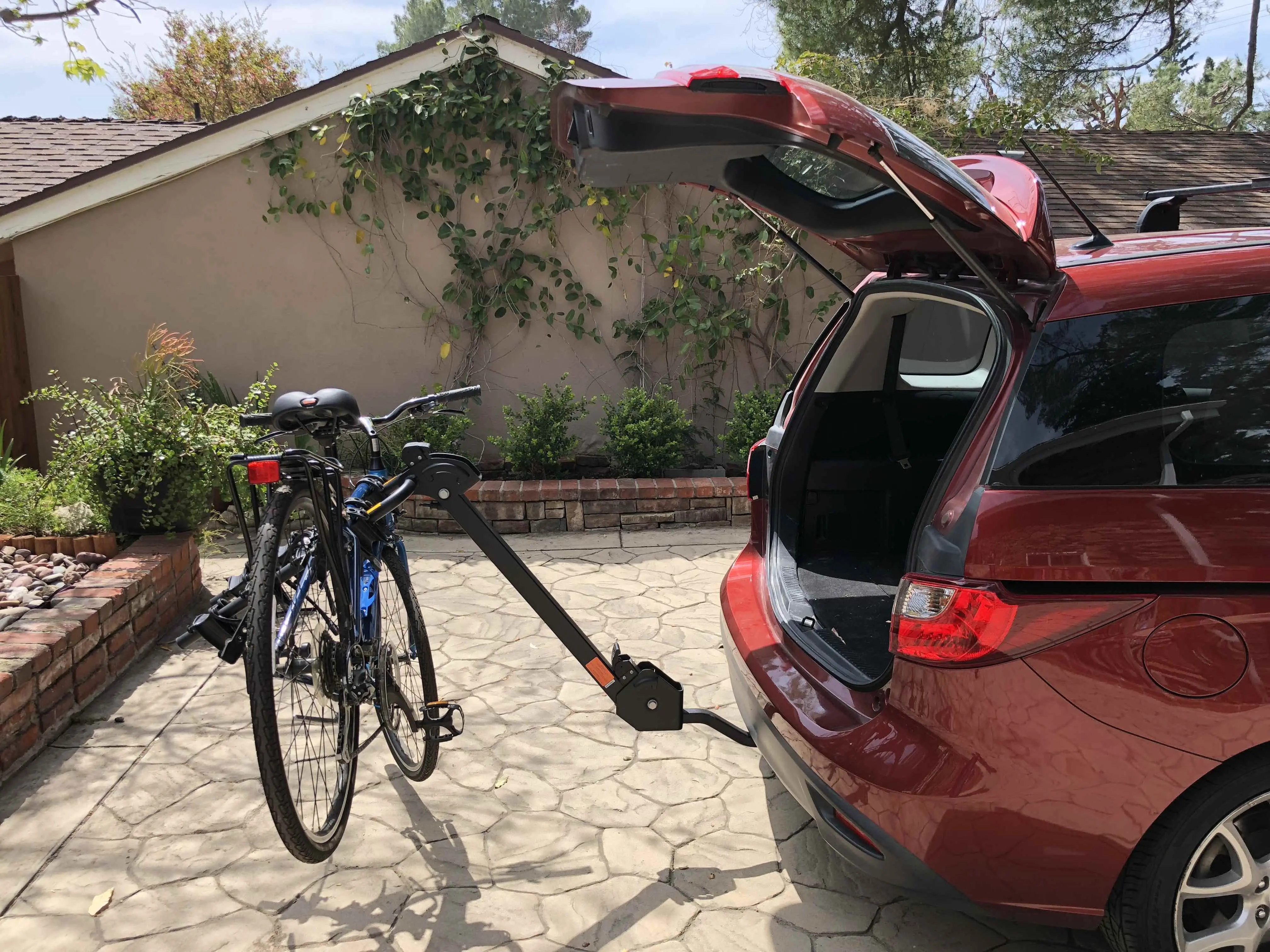

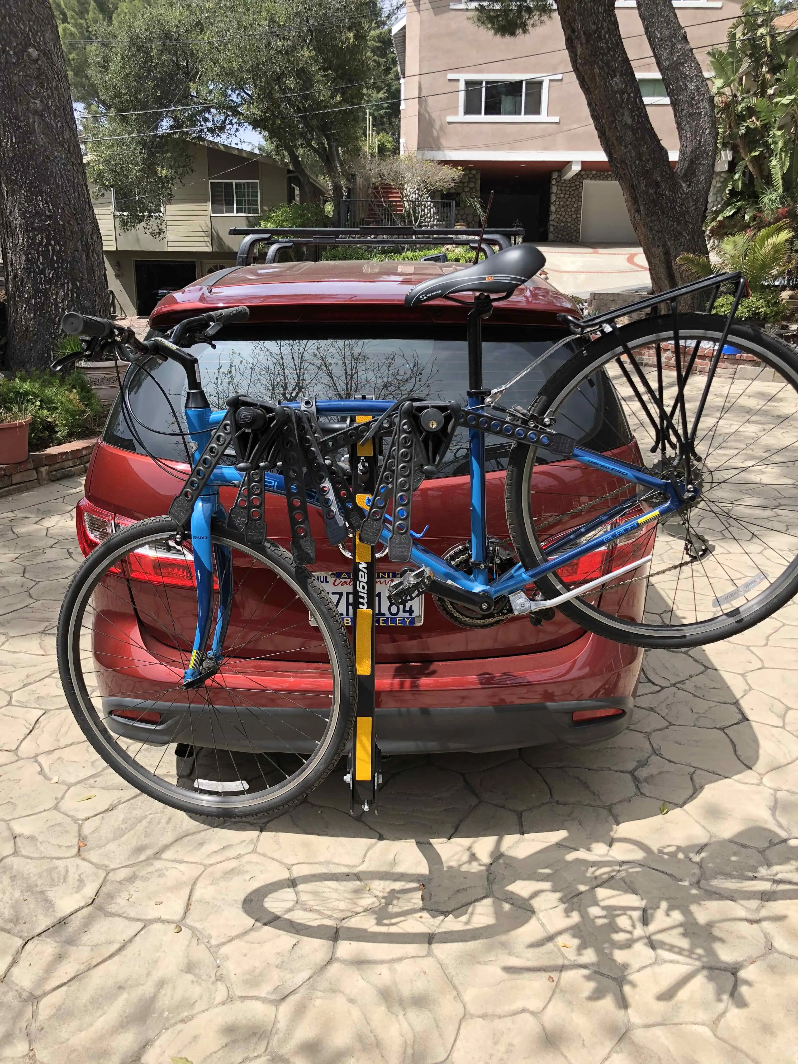

Thank you, and your wife, for the pics. The rack tilt pic is what I wanted to see. The 4 cradles on the arm seem to be fixed and have straps for the top tube and vertical tube to keep it from swaying. The pic here shows the bike has rotated ~45 degree and stays perpendicular to the ground but the rack and cradles titled...? I expected to see the bike tilt with the rack. How does that work? Do you undo the vertical strap when you want to tilt it? Also, it is hard to lift it up and down with 4 bikes to access the hatch?
I am in HK, on a project, otherwise I would give you all pics you asked for.
To answer your questions:
1) Yes the arms have straps for top and vertical tubes. Bikes don't sway at all. We did 2200 miles to Mexico and back with bikes, and it was fine.
2) The bike actually hasn't rotated at all. See the pic titled "Rack with bike" and you will see what I mean. Her bike frame is not straight. In order to put this bike on the rack, the bike is already titled in the regular rack position. When the rack is titled down, the bike stays in the position you hooked it up in, in this case, it was originally higher off the ground in the rear. In a regular mens frame bike, there is no tilt when you lower the rack.
3) If you undo the vertical strap, yes it will tilt perfectly, as you are suggesting. I don't think wife undid that at all. She did a quick pic, as I requested.
4) It is NOT hard to lift up and down with the bikes on. Of course it depends on your weight of the bikes. These bikes are pretty light and we haven't had any issues at all. We had to constantly access the hatch.
I was expecting to see the bike tilt along the green line if you secured both horizontal and vertical straps, which would keep the bike parallel to the rack as it tilts down (bike would be slanted). Looking closer at the pic "hatch open", I see your wife did not secure the vertical strap (red circle) for the quick pic, which would explain how the bike is able to maintain perpendicular to the ground when the rack is tilted. Ultimately, if it is easy to life up/down, that is what matters most.
correct
She didn’t use vertical strap
