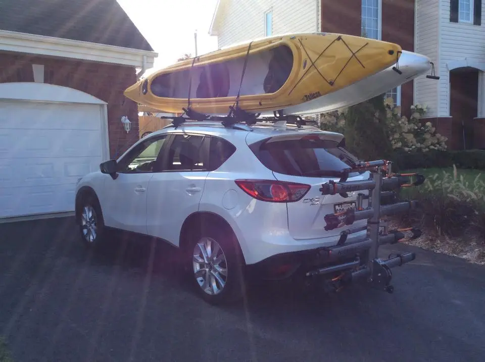

I would definitively go for a 2" (less than 200$), very easy to install yourself, I did it alone and it took less than 30min. If I had someone with me we could have drop this to 15min (easier if someone hold the hitch while you place the bolts)
attachment.php
The tray style racks are nice as well but require you to remove the bikes to get to the rear hatch. Personally I like the swing away so that I can gear up with shoes, helmets and what not while sitting in the rear bumper and the bikes are nicely hanging on the rake and not on the ground or leaning against the car.
This Thule rack tilts down for access to the hatch. It is also expandable to carry 4 bikes. The advantage (for me anyway) of the tray style is that there is no stress whatsoever on the carbon fiber frame of my bike vs a rack that the bike hangs from. Had 1.25" draw bars, etc. from my previous ride ('02 Escape) so going with 1.25" made sense for me. Not saying it makes sense for everybody. I do love this rack though and it comes as either 1.25" or 2", so it works no matter what your hitch preference.
