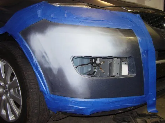

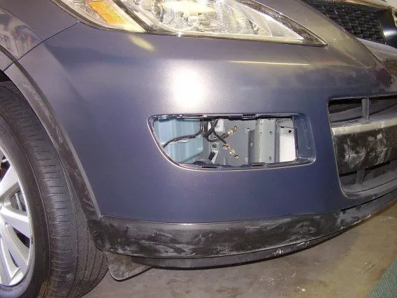

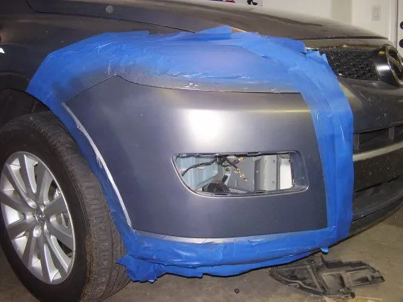

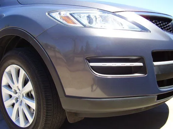

Here is my bumper repair...
Thanks. I did some small touch up work on my truck, but that's a white work truck and I did a quickie just to make it look a little better.
Never did such a large visible area, and not on a car this nice, or with paint like this. Pretty good match from Paint Scratch, and nice rubbing compound and lacquer. I'm ordering more of the rubbing compound just to keep the clear coat looking good. I used it on some minor marks and scratches and they disappeared.

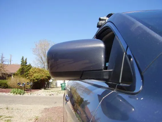

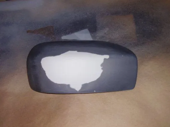

I found out when doing the mirror that they had the same problem as the interior trim pieces that peeled. You can see the big bare spot in the middle. Once I breached the clear coat, everything dissolved the paint; Windex, primer, even the new paint. I ended up having to totally strip the piece and start from scratch, so that is all new paint.
There wasn't primer on the mirrors, so I'm guessing they used a plastic bonder right in the paint that didn't work.

As far as the paint repair, if you are a little patient it's really easy to do. The two keys are knowing how to spray paint (particularly with the mica paint), and identifying your mask and feather lines.
I did this in an afternoon, except for polishing the clear coat, which has to be done at least 3 days later. We also avoided driving the car on the highway until then.
