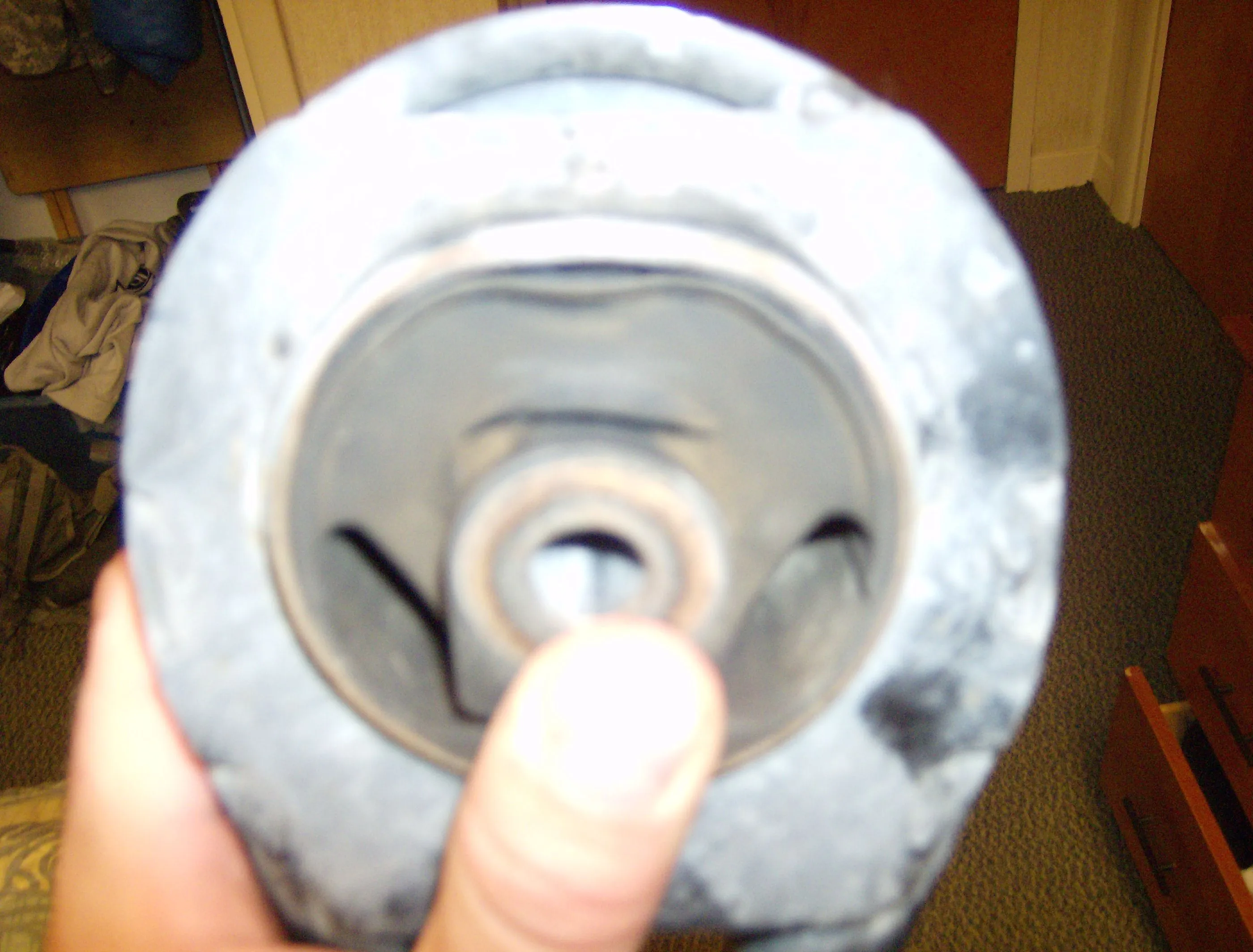

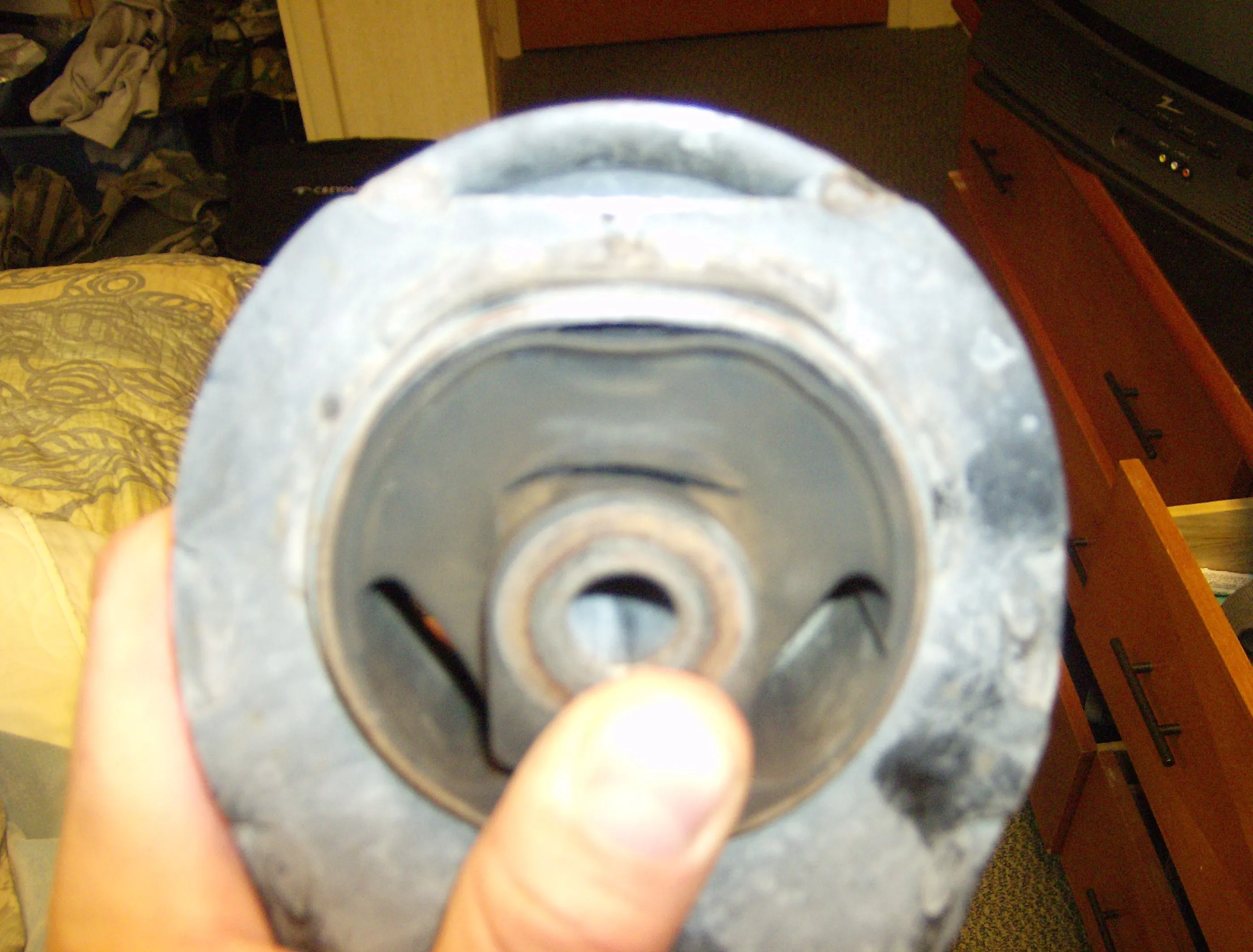

Tonight after I found out that I was given the wrong brake pads and cooled down a bit I replaced the stock motor mount. Very easy to do. As you can see in the pics there is a tear in the motor mount. Hmmm no wonder I was getting horrible wheel hop.
I put in a TRZ Derlin mount. Wholly s*** the car has vibes like my 1982 Ford F100.
Now I can say that it grips much better, I am on the right track, my tire and wheel weight is *** Ooops I could not do proper math. 41lbs on 235/45 -17 But I will be fully bolted soon.
