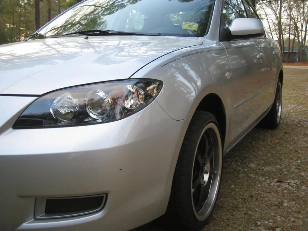

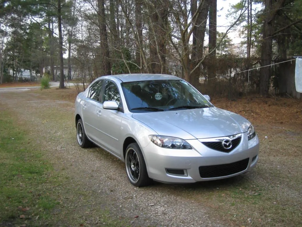

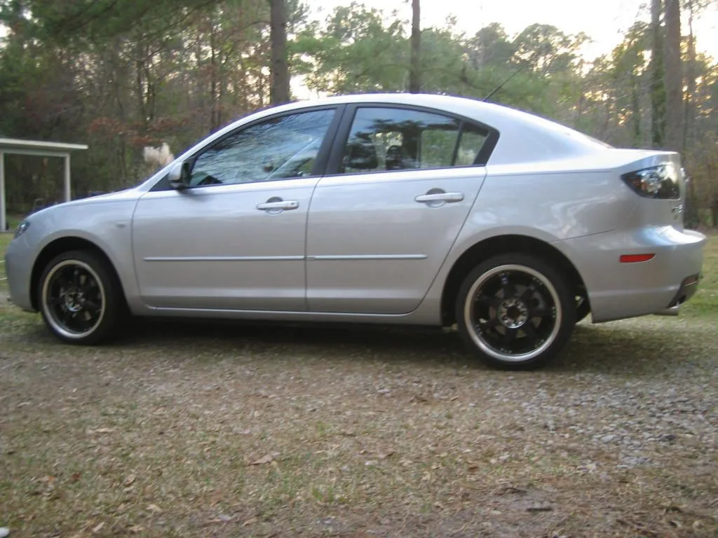

Day Pics, I know I need new tires, thats why I took pics, to see what size ya think I need.
205/40/17 is on there now with a 17x7.5 wheel with 45+ Offset.
