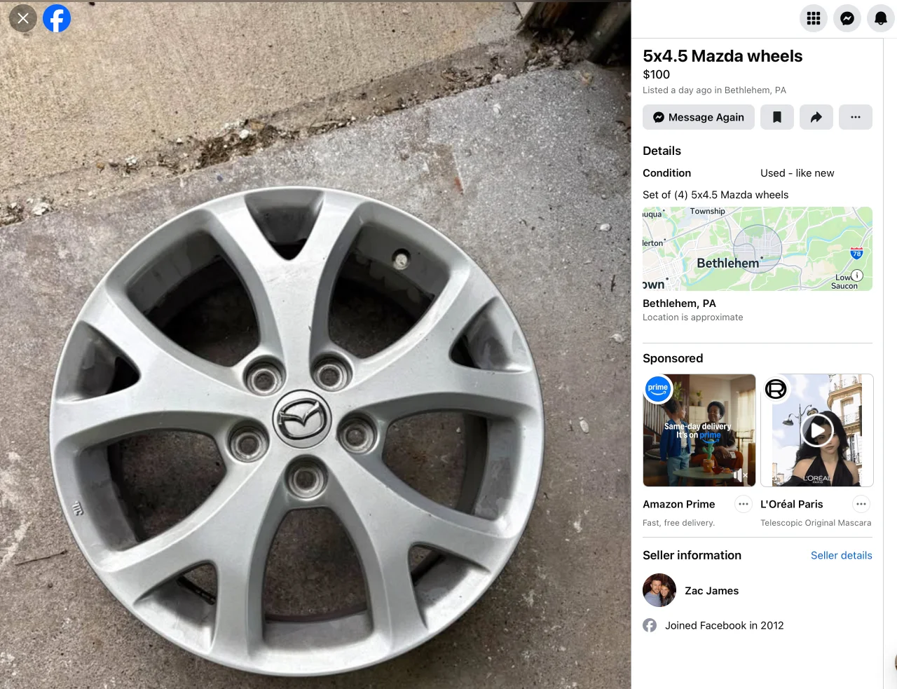

I have a 2009 Mazda 5 Sport so it has the 17" wheels and stock tires are 205/50 R17. All 4 of my tires are shot and I've been putting it off for too long so need to get this figured out. From what I am seeing 17" tires are more expensive and way harder to find used around me. I am considering putting 16" wheels on. I found someone on Facebook Marketplace selling (4) 16" Mazda wheels for only $100 so I'm thinking about picking those up because I know I can find some good used 16" tires or worse case scenario I'd buy new.
Are there any downsides to switching from 17" to 16" wheels? I'm not worried about the speedo being off but I can't find a straight answer as to how it will affect the handling. In my opinion it's a pretty rough ride so I def don't want to make that worse. If I do get these 16" wheels what would the "optimum" tire size be that would give the best ride and handle well? Any help would be a huge help as I need to get this figured out this week hopefully. Thank you!

Switching to 16's is fine, as long as the new tire diameter matches.
etc. 205/55r16 would be perfectly fine.

If you get smaller rims, make sure they fit, have the correct bolt pattern, backspacing, etc.
As suggested by Lazy2.5, get new tires with an extra inch of sidewall. Your speedo will still work right, your MPG won't suffer and your ride will be much improved. A taller sidewall is the enemy of a rough ride.

Yea I'm not worried about where to get the tires themselves or where to get them mounted. I typed up my post in a hurry but I'd only get used tires if I found a full set that were like new and worn evenly. More than likely I will get new just trying to decide if I should get these 16" wheels from Marketplace or just keep mine and get 17" tires. The tires on there now are 205/50 R17 so if I did the 16" wheels I'm trying to figure out the best tire size for those. Should I up the aspect ratio a bit and if so how much?

I should have mentioned in my post I'd only get used tires if I happened to find a full set that were all worn evenly and like new. My main question was about the wheel size and if I should get these 16" wheels from Marketplace for $100. He still has them 10 minutes from me and they are in great shape and only $100 for all for. I guess I'm trying to understand if there are any advantages/disadvantages to going with the 16". From what I can tell tires are a bit cheaper but is that the only difference? Also wondering if I should up the aspect ratio or not when looking for 16" tires and how much. Thanks
Yea more than likely I will be getting new tires I'd only do used if I found basically new ones worn evenly. I'm just trying to figure out if I should switch to these 16" wheels or not for $100. If I do what do you think the best tire size (aspect ratio) would be? Original 17" tires are 205/50 R17. Thanks!

I would go for whichever wheels and tires are in best condition, but my preference would lean to the added aspect ratio of the 16's, if you drive on bad roads. If your roads are smooth, doesn't matter as much.
Like Lazy2.5 said, 205/55r16 is your closest tire to what you have now. At 60mph, this profile for 16" wheels will be off 0.5mph on your speedo.
Will he let you mount a rim (without the tire) just to verify the brakes or something else dont' rub?
