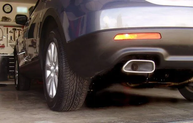

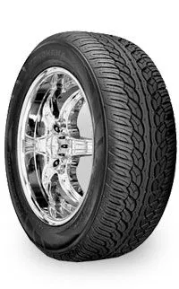

As an owner of them, I'd suggest just getting the Yokohama Parada Spec-X in the original size. Fantastic tire for this car.
Improved acceleration (reduced torque steer), cornering, braking, and wet traction. I got them because we get ice here (more than snow), and I didn't want to buy snow tires.
They also have the rim guard, like the Nokians. A nice feature.
Too bad Nokian doesn't make the 245/60R18. It is a nice tire for all around. You could just get the 255/60R18, though, and be close.
