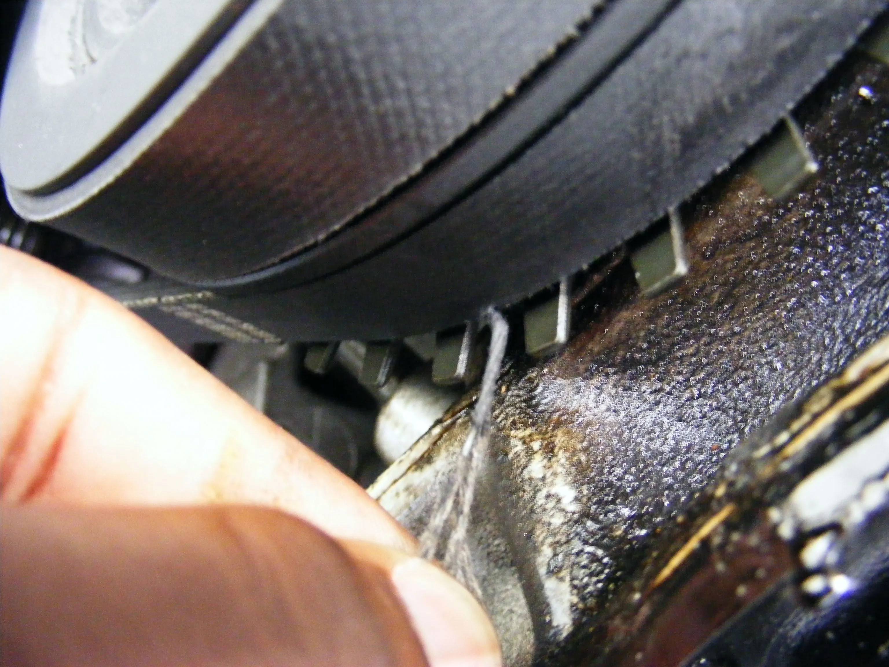

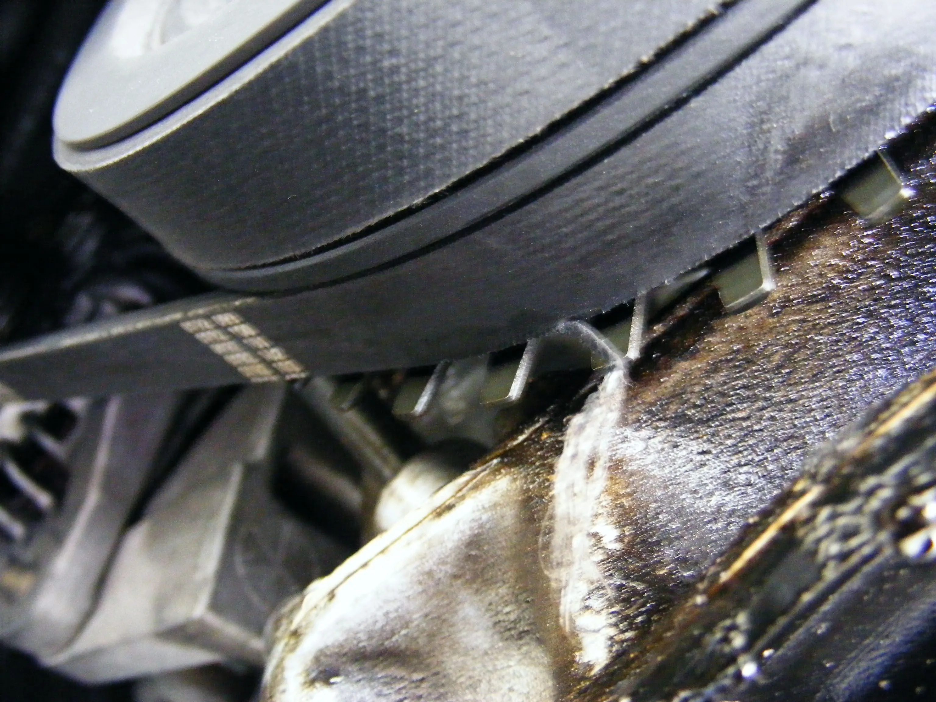

well I finally got out there to look around to see whats up. I removed the bottom cover that allows you see the alternator and the compressor and the I think its called drive pully...anyhow the belt that goes to the alternator and the ac compressor has a fray piece that is unraveled but yet has a hard piece still attached to it. So everytime it goes around it hits something....making noise. I just changed the belt not that long ago...so I dont know what is going on here. I did notice how ever that the alternator puller has some build up in the pully grove closest to the alternator.... Attached is some pics of what I'm talking bout for the belt....
That is the crank pulley. The ecu uses those teeth to control ignition timing. If you look there is one missing.
But I don't think the frayed belt is causing your problems.
