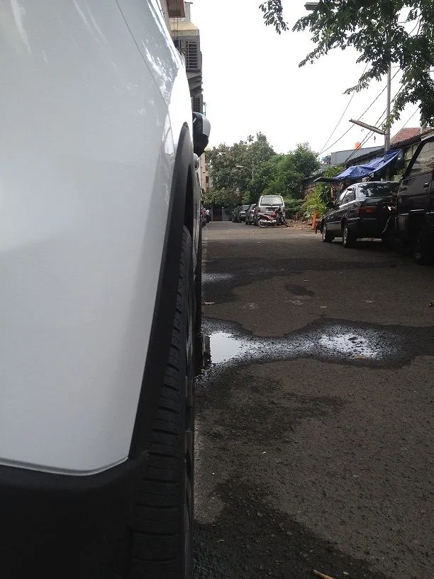

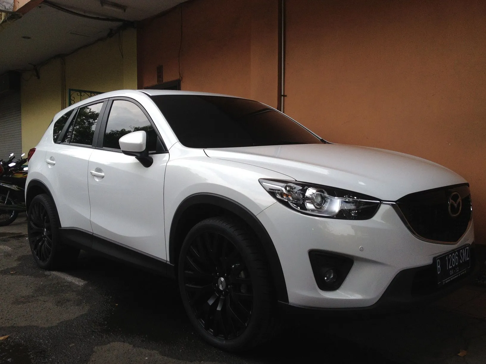

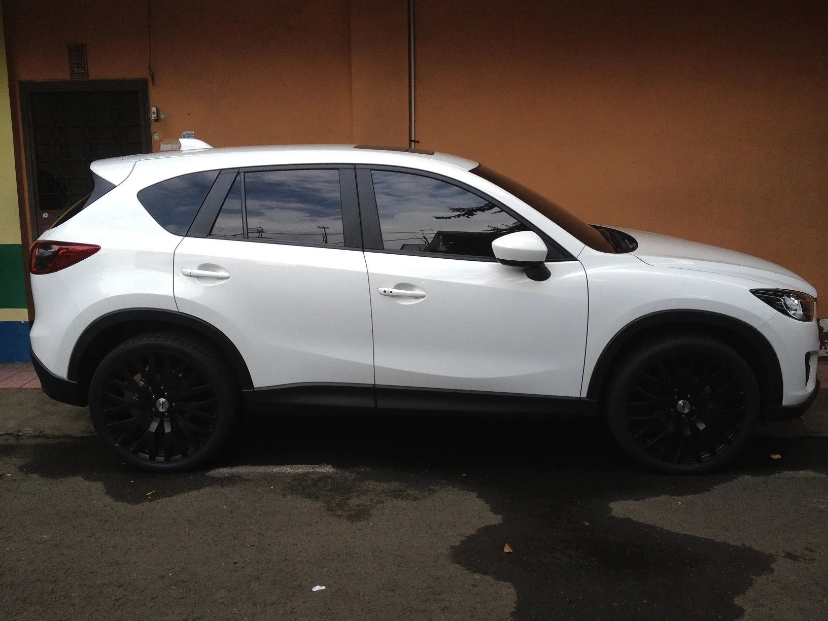

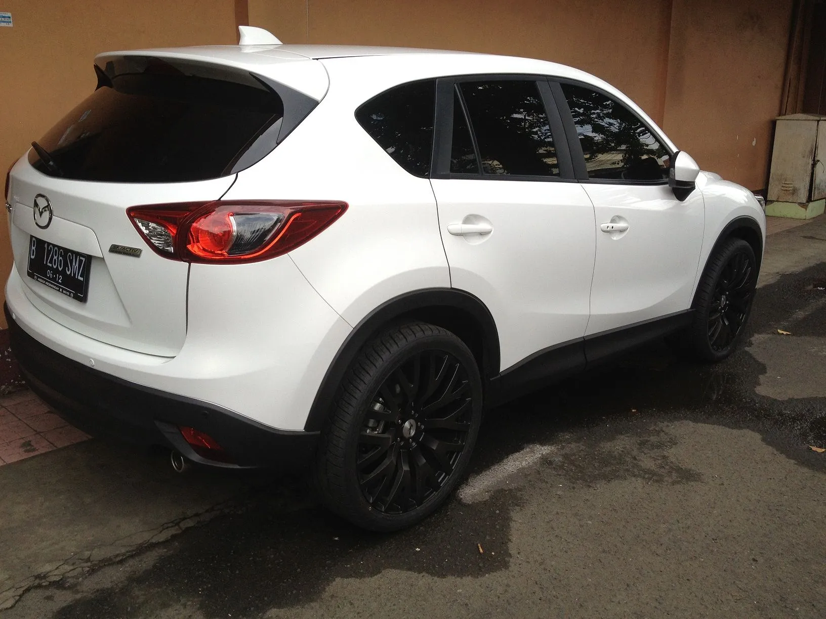

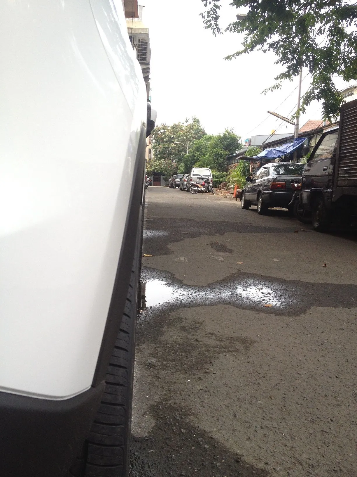

Here are some pictures of different angles.
sorry for the bad shots, I am no professional photographer.
Let me know what you guys think.

I think it looks great! Would love to see more shots of the rims from different angle. Any rubbing issues in front or back? If this were me to keep the 22" rims I would try to squeeze more rubber than lower it unless you have some nice smooth roads and this is primarily a show/town car. It would look pretty sick lowered if it fit.
Similar size overall to what you have for 20" rims would be 255/50r20 with 1mm less width being the most significant difference. MA

I am currently trying to find a way to lower it. The H&R spring for the CX-5 currently only supports the AWD not the FWD.
I dont think you could squeeze in more rubber because it would look really weird as the overall diameter would get really big and would not be proportional to the body.
I do not have any rubbing issue right now at all, but it might be different if I lower it. I hope it will not though.

Wow looking good!!! The tires are really flush... nice !

One more request can u take a pic of the back but a little further, just wanna see the width of the tires

These are Project Kahn Cosworth.
it drives really great and i could barely notice any difference and I too, don't feel any lost of power. If I do anyway, I am sure it will not be that much that you could actually feel it.
My only suggestion is that if you are going for my setup, use 265 profile tires rather than the 285 because when I turned my steering wheel till it's maxed out, I could hear the tires brushing the plastic part. But if I turned 9.9/10 of the steering wheel, it is just fine. Only when I turned 10/10 then I could hear the brushing.
I am sure with 265 profile tires would eliminate all that totally.
As far for the rear setup, everything works flawlessly.

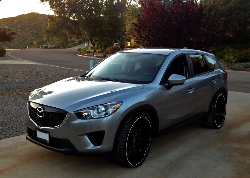

Ir's rl dark so I gots to wait until tomorrow or tha pics won't rly look good. TwentyFoh by 9.5. Rubs wheneva I do errthang but playa gon play.
Looks cool but goofy LOL. I love the look of 20's on the CX5, but anything bigger is only for gangstas... and I think that's not me LOL.
I almost pulled the trigger on a set of 20's, but couldn't do it. Pretty sure I'll do 18's because I bought it because of the mpg and I plan to USE it like a mule, not just cruise around town. :) Running 150-200 miles a day, it's hard to justify hurting the ride and mpg that much.
BTW, I took off a tire and weighed it just to know what we are working with... 17" tire/rim was 47 lbs. Most of the 20's I've looked at will run 60 lbs... give or take a couple. Some combos are 65+. Umm... I don't think adding 20 pounds per corner is a good idea. I found a set of 18's that will check in at 44 lbs... that's what I would like to see on mine. That should improved handling, ride, and mpg, vs the stock treads.... and would be light years better than 20-22s
