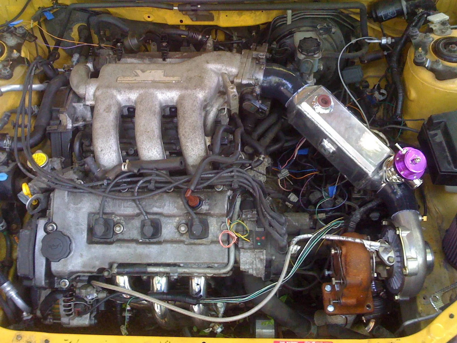

Got a lot done today - I'm finally in the home stretch. I know the engine is filthy and the wiring still needs cleaned up...
