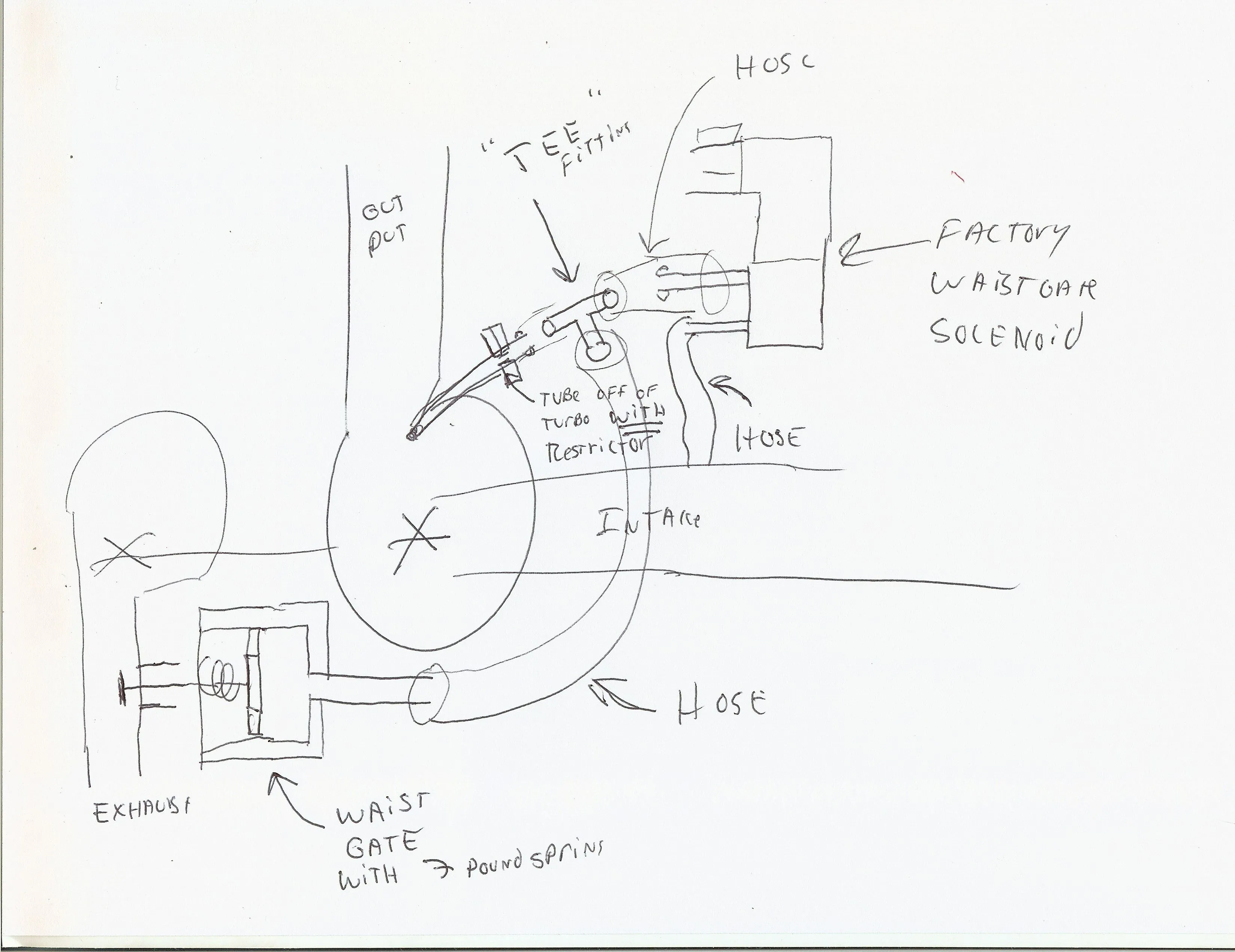

I want to do this too! can you please tell me what you did to change the wastegate!
If you want the EMS to regulate your boost, do this.
attachment.php
I think a 0.051" NOS nozzle works pretty good to use in that location I have marked as 'Restrictor' to mimmick factory BC setup. I tried .041 and .047, didn't work too well.
No restrictor, or too big a nozzle will result in crappy boost buildup.
attachment.php

O my god bro you are the man!
thanx a lot I been having so mucth problems with that!
by nos nozzle you mean this?
