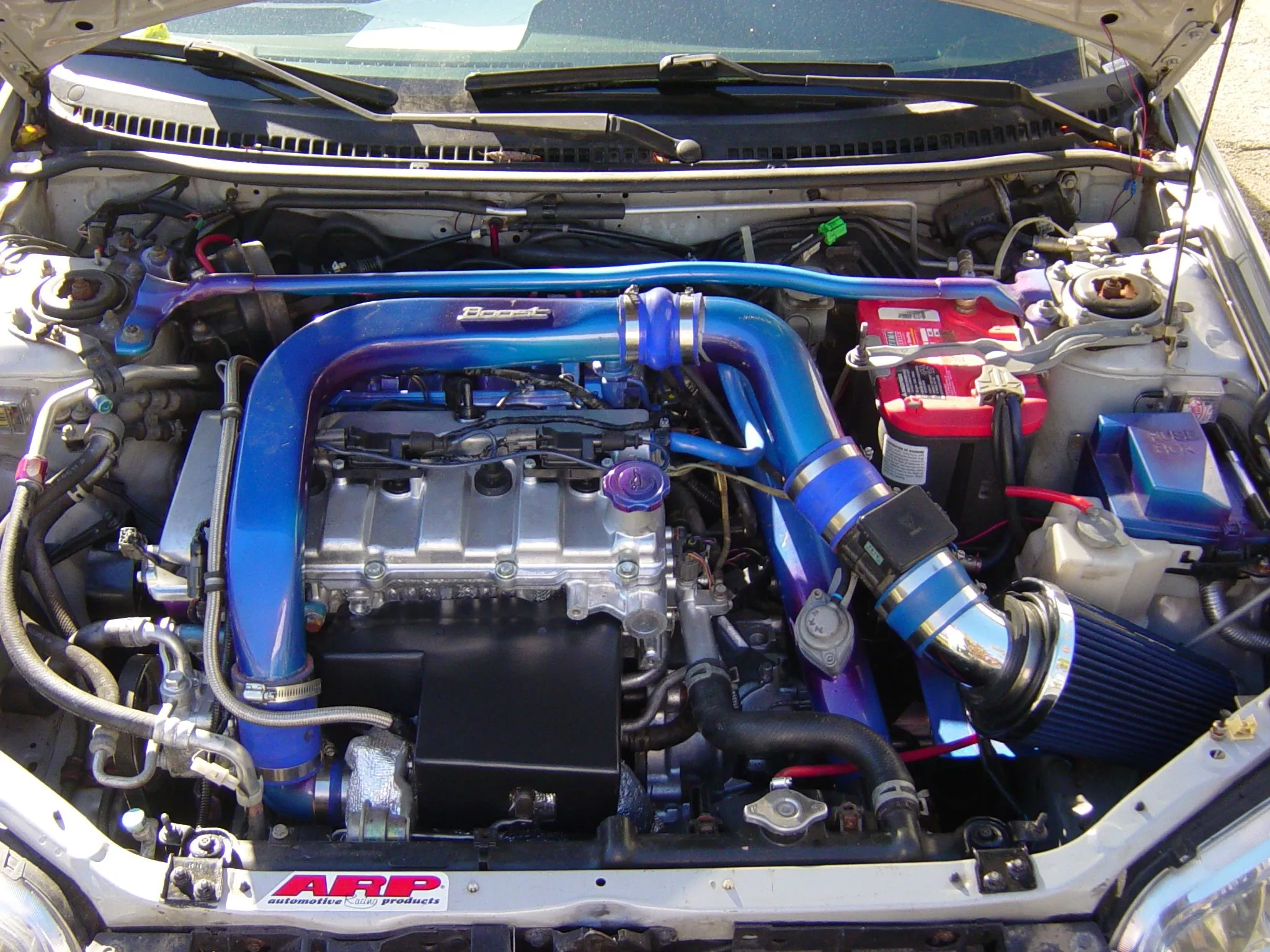

i have the Haltech E6X, 440 injectors, fully ported stock head, jdm cams, Pauter rods, CP pistons 9.0:1 std bore, new MSP block, MSP oil and water pump, ARP studs, new IHI turbo w/ internal wastegate, -6 turbo oil feed line, removed vics and vtcs, 3" exhaust, hi boost fmic, haltech boost controller, MSP updated LSD, walbro fuel pump, AWR oil pan, stock cols and upgraded wires, NGK bkr8es plugs, fidanza flywheel, ACT clutch, AWR motor mounts, stock MAF, and a really bad piece of crap blow off valve that came with the hi boost kit (sounds cool, leaks bad and no one has ever seen one like it! check out the photo. WTF???).

Your car looks great men, lots of s*** done to it. well i can e-mail you my haltech e6x map, but remember i have 1000cc injectors i dont know if that is going to be good for your injectors size. as soon as i get my car ill e-mail them to ya. PM me your info.. one thing i dont understand is why if you are using a Haltech E6X which control Air/Fuel and Timing you are still using a MAF sensor and o2 sensors, my car doesnt used those parts anymore, i dont use MAF or o2 Sensors anymore. i love the Haltech E6X men, is just the best EMS out there for my opinion
