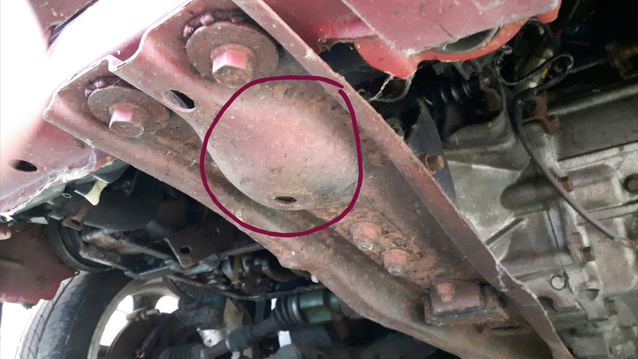

PS.
If you you get a Jack this is the lifting point. That point fits right into the cup on the Jack.

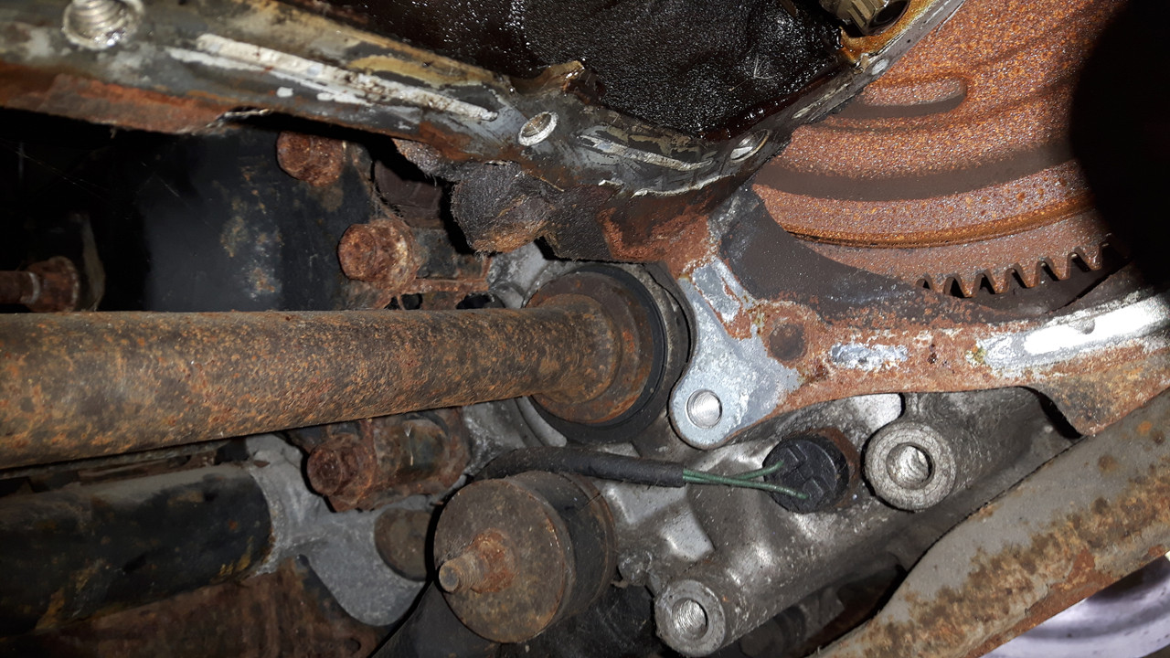

I took some pictures if my parts car...
Just Thinkin..
If your axle comes out of the joint shaft and it's all rusty, it probably means your joint shaft hanger bearing is shot..?
I figure if water got in it probably wrecked the bearing too.
Fortunately, no rust that I see, I live in Western Washington so rust is generally not an issue for us and my green cup still looks quite good for an old part.

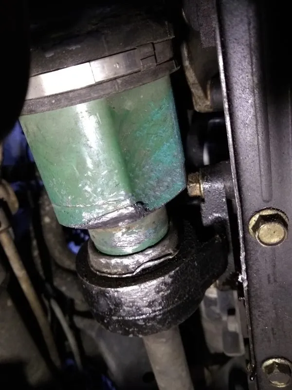

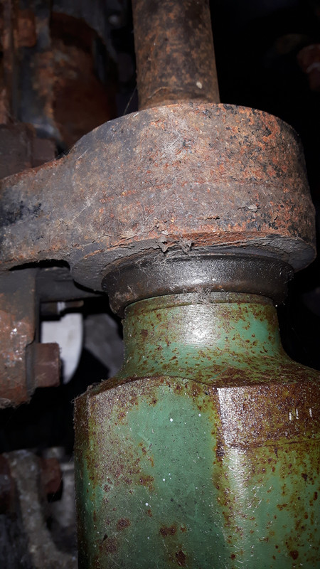

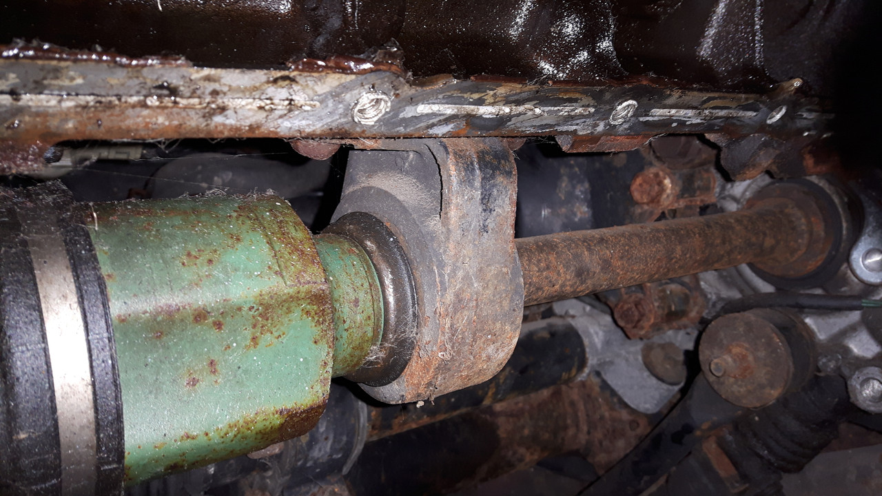

The closeup of the CV joint cup at the jack shaft looks to be about where mine is now. When I began, that recessed ridge that slides into the jack axle bracket is now showing roughly the same as yours is in that photo, though sans the rust.
It's green like yours but neither boot was torn.

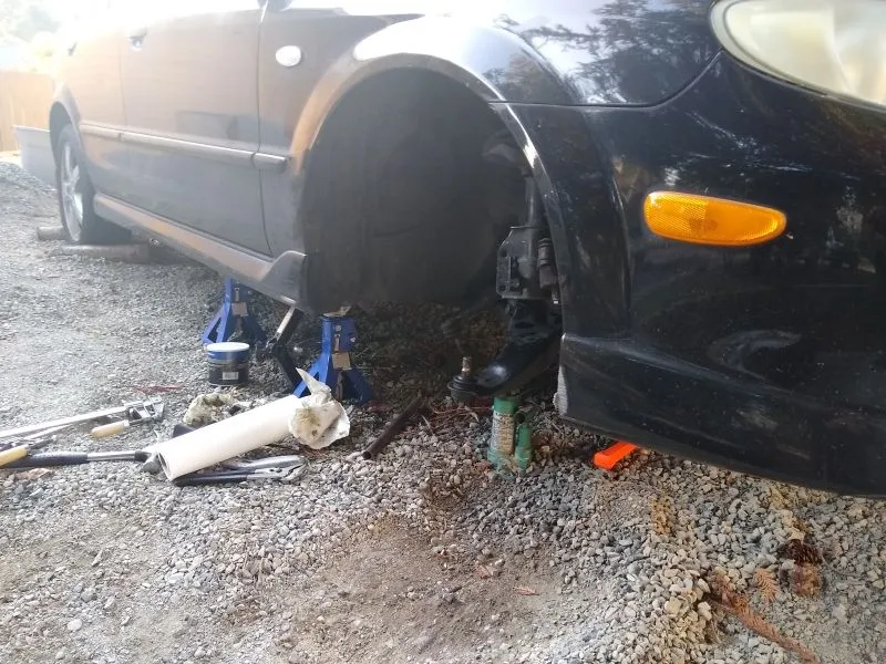

That said, here is a shot of the car as it sits.

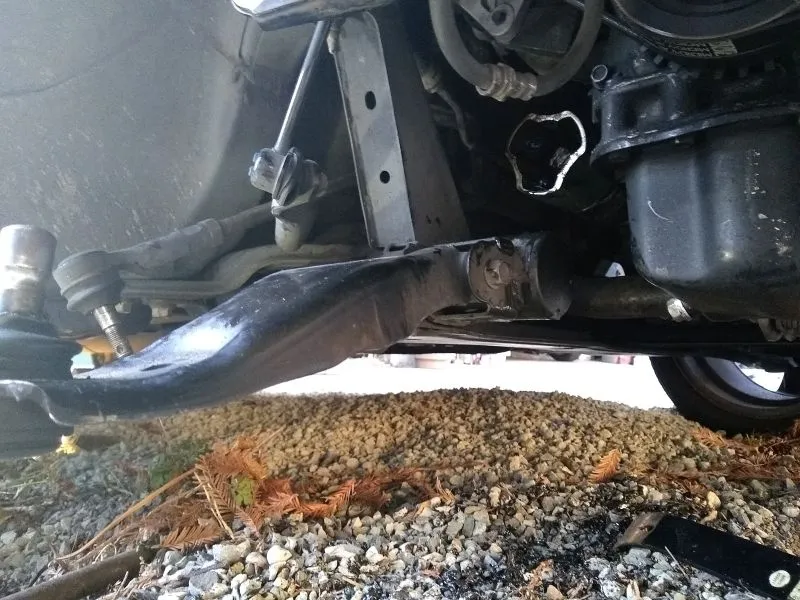

Here is axle shaft with the CV cup left to take off

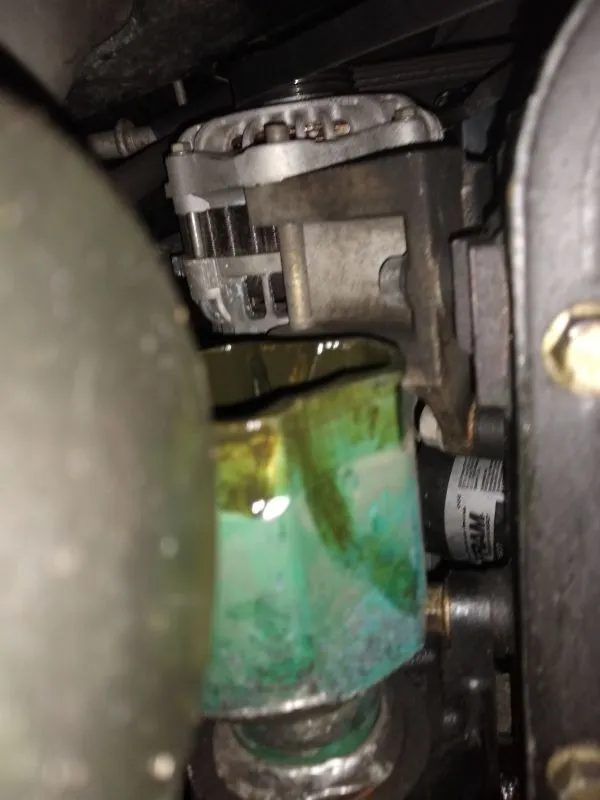

And here is the slightly out of focus shot of the cup itself and how far I've gotten with it.
And finally, how much clearance under the car.

I think you should remove and replace the joint shaft.
Three bolts and it will slide right out.
There's a good chance the splines of the joint shaft will be all buggered up and then the new CV joint won't simply push in and you'll have to hammer it on from the knuckle end of the shaft which could damage your new CV shaft.
If you remove the Joint Shaft from the car and then pull off the cup, you can test the Joint shaft on your new CV joint to see if they couple up nicely. You could leave the c-clip off the CV joint just to see if the splines slide in without binding.
