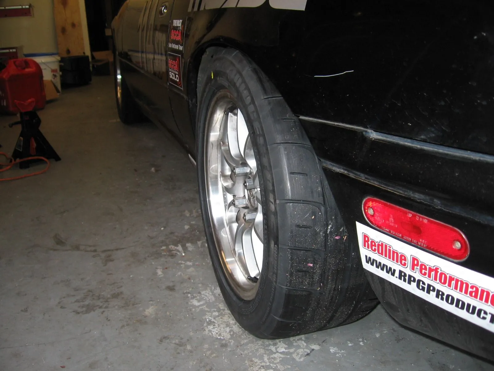

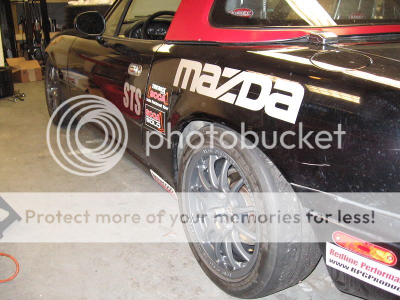

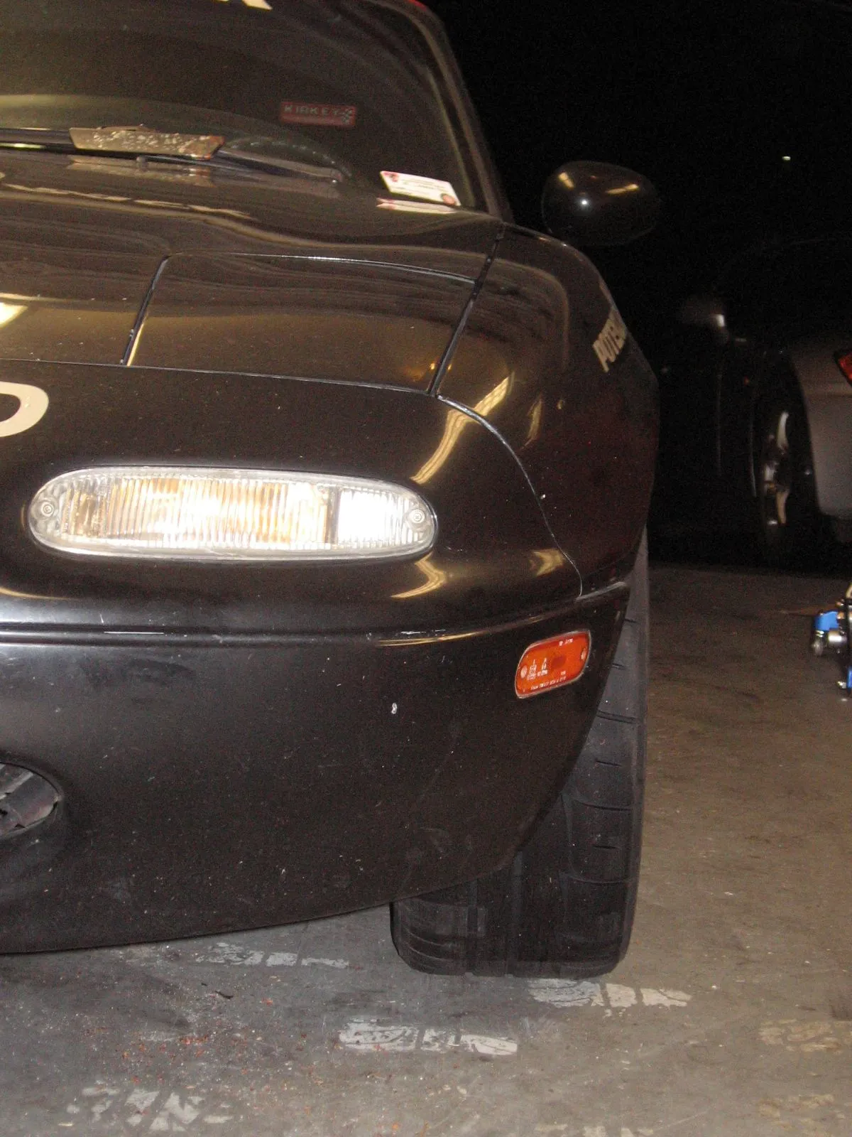

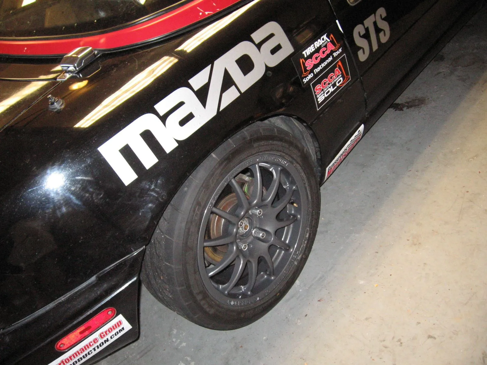

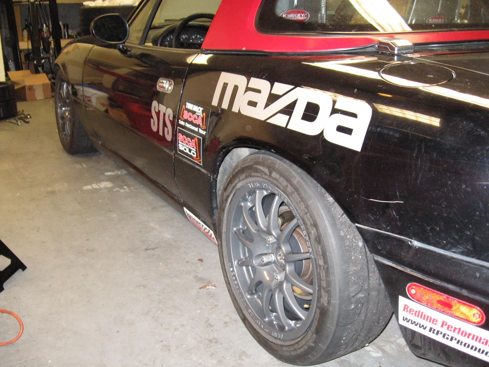

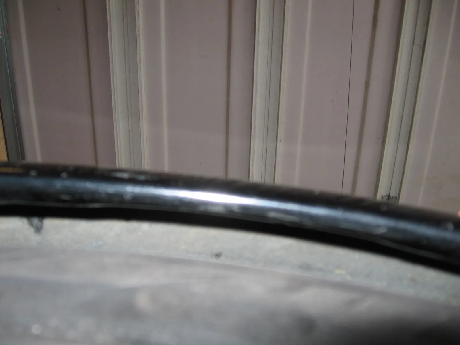

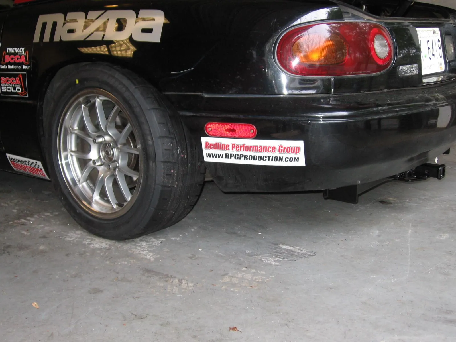

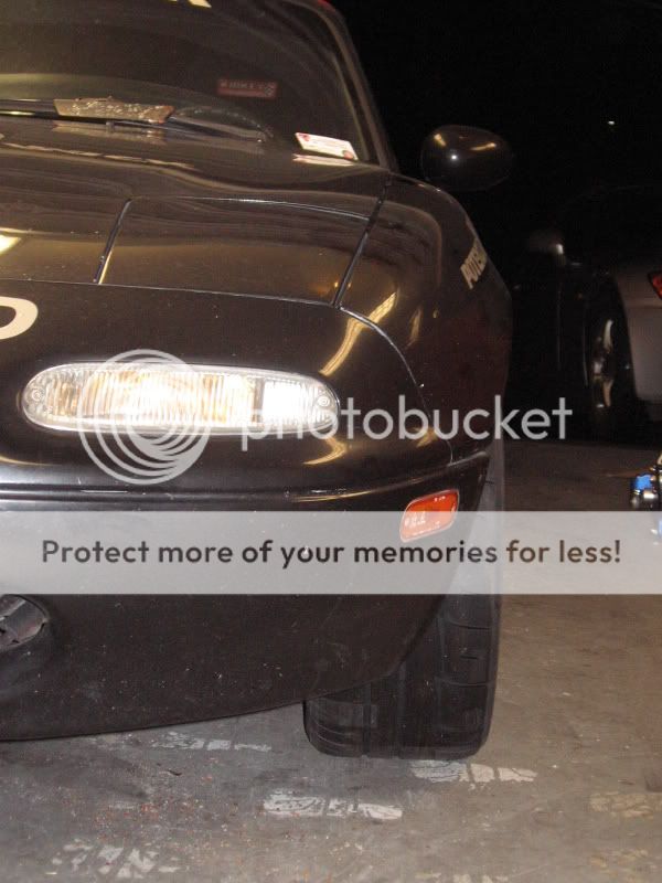

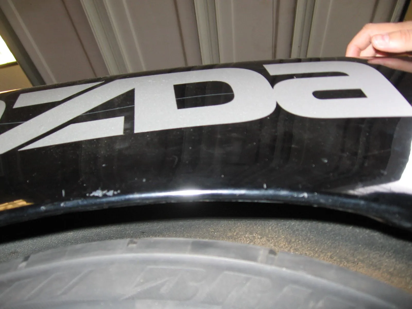

Rolled fenders, got my shaved RE11s mounted. They're about .8" wider than the 195 RE-01Rs, but for whatever reason (I think due to the tread pattern or lack therof once shaved) they look like steam rollers by comparisson. Fortunately they're only .3" taller.

So, if you were wondering what a buttload of tire looks like on an STS car...

the way the flash hits the tail lights makes it look like you have ricer "euro" altezzas

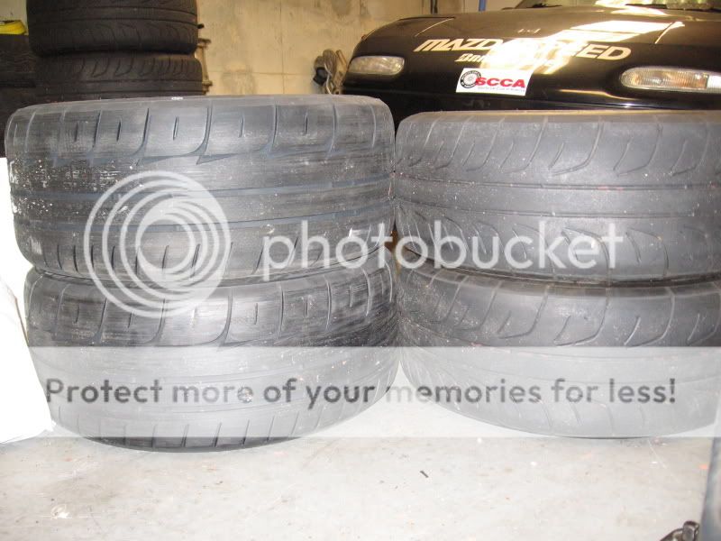

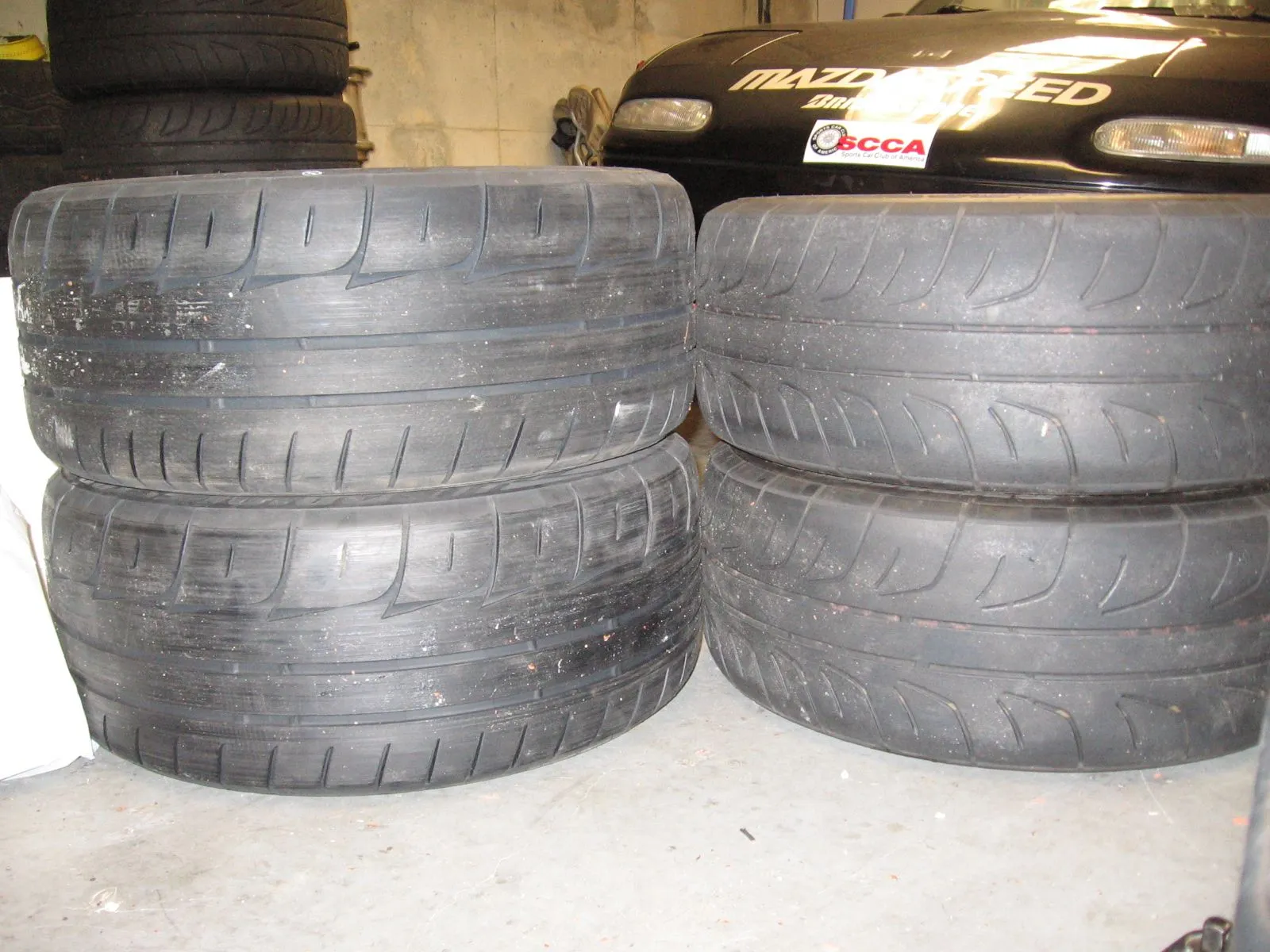

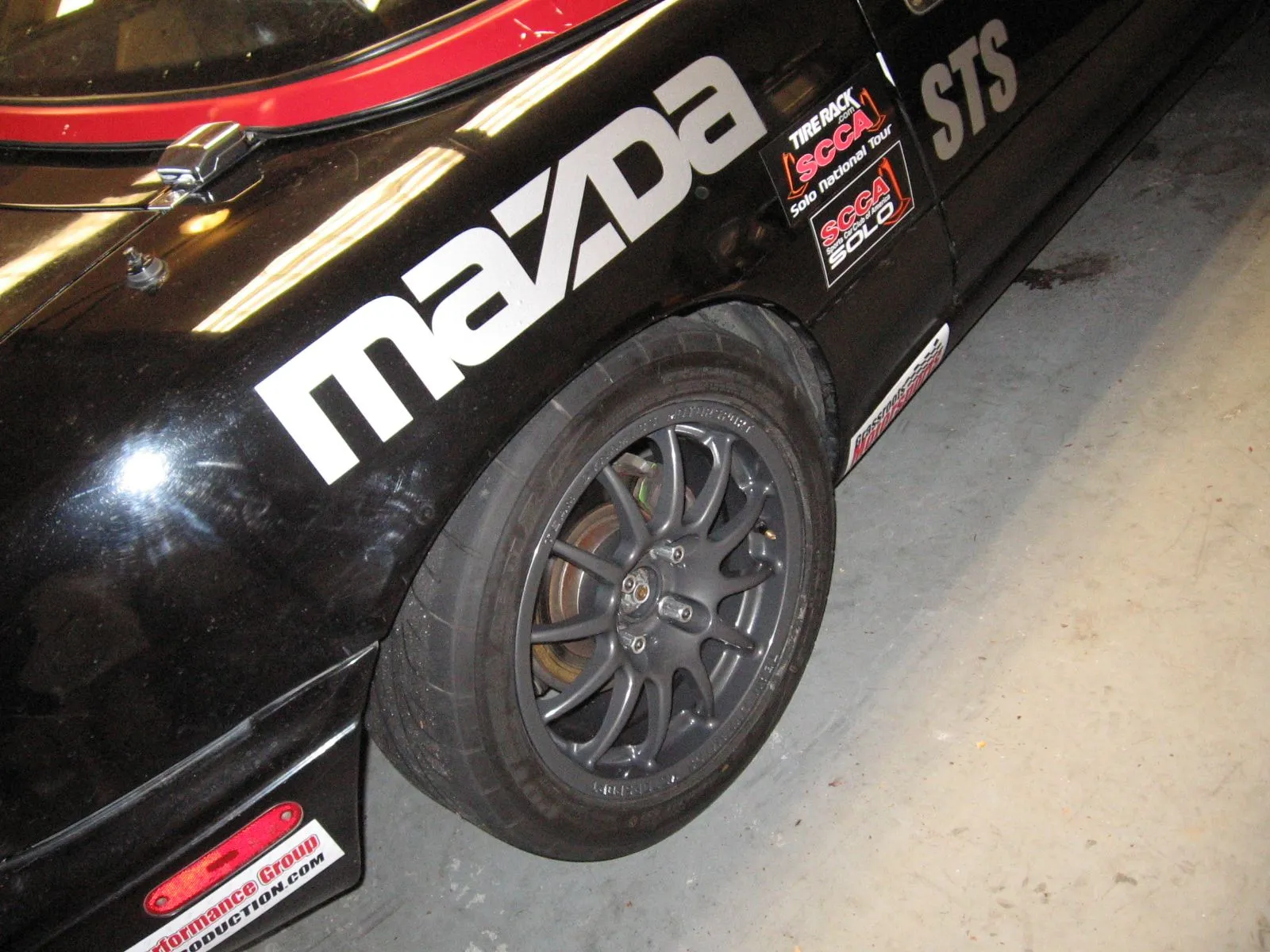

Comparison: 195/50/15 RE01R on a 7" wheel vs the 205/50/15 RE11 on a 7.5" wheel:
FWIW, the RE01Rs sit pretty flush w/ the rim on a 7" wheel, where the 205s are actually a little pinched on a 7.5" wheel, so the difference in height's not in the wheels

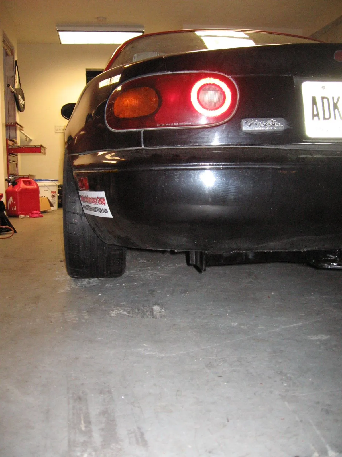

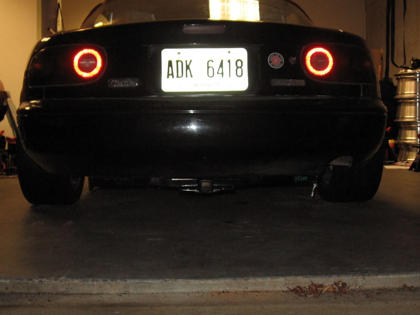

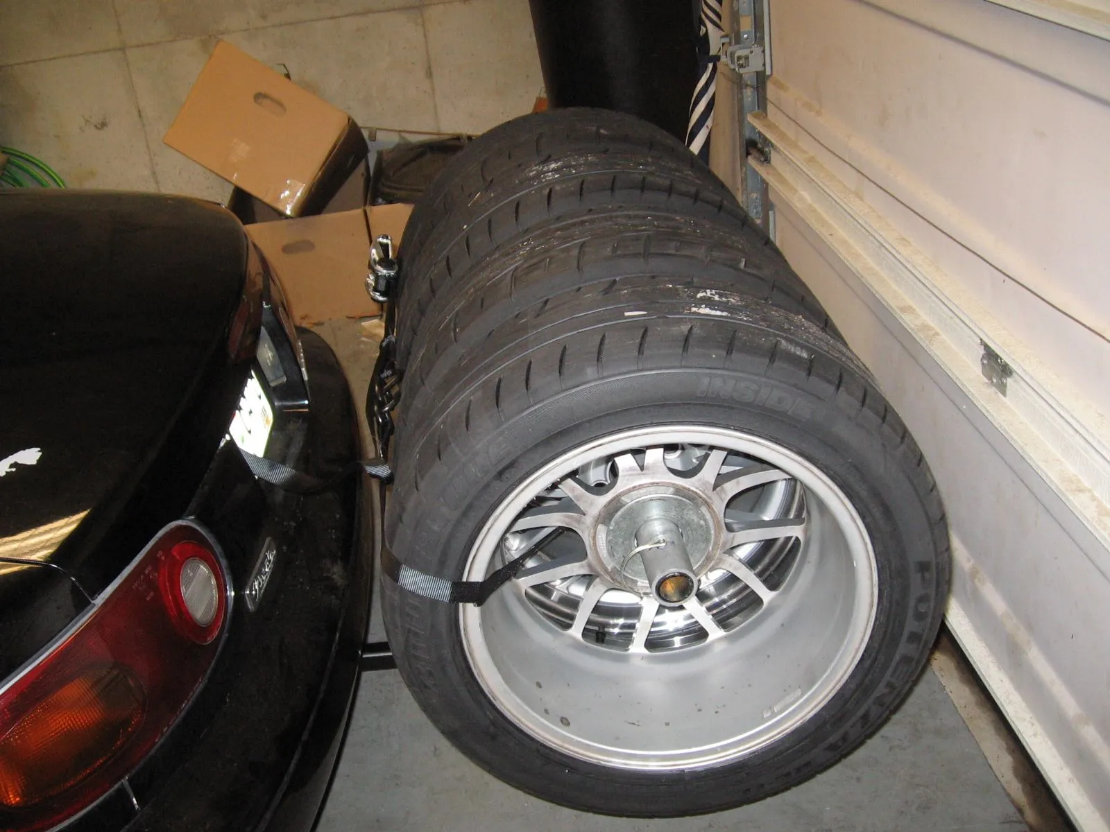

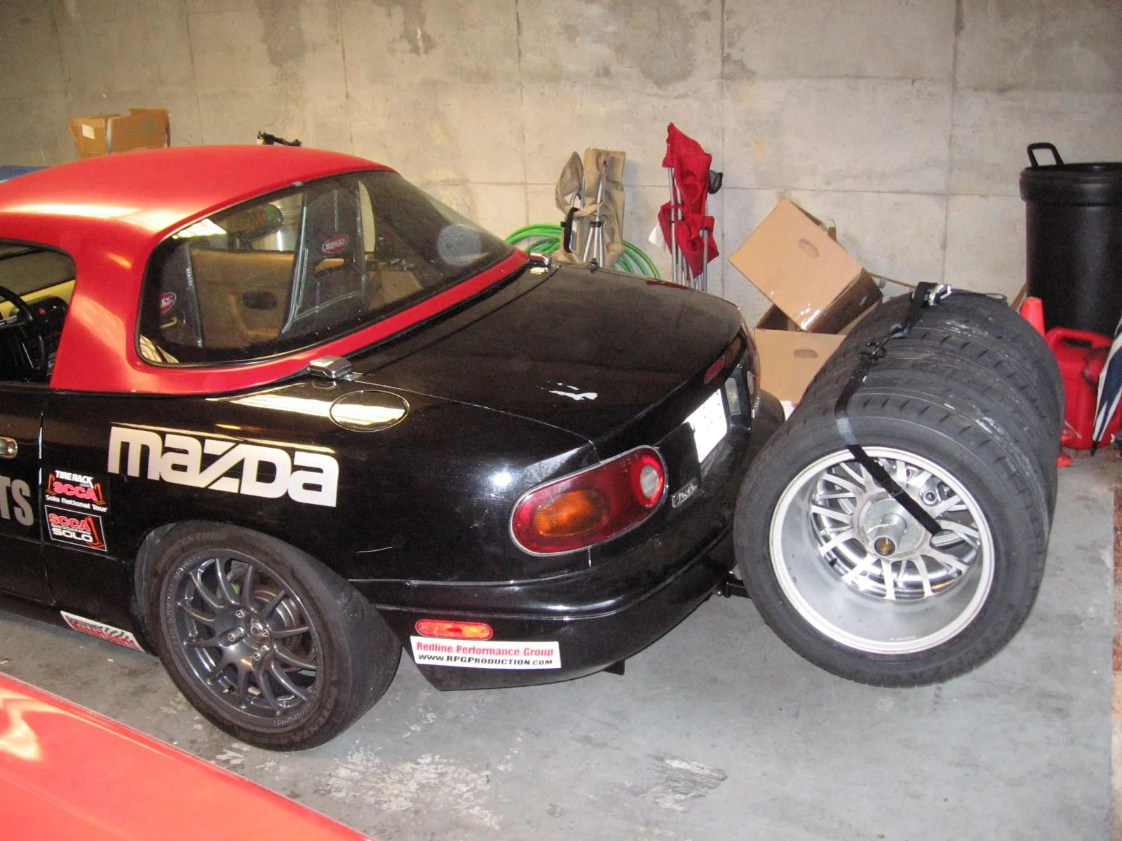

And since everyone wanted more pics of the TD wheels and the tire tail (I'm out of town tomorrow so I packed up the car so it'll be cocked locked and ready to rock Sunday morning):

Is the strap on the tire tail going to work like that? Looks like it could easily slip. I know it's there for insurance, but wouldn't it make more sense to have it strapped closer to the wheel/tire than across like you have?
What you can't see is that it actually goes around the bar of the tire tail itself in the middle of the wheels. That'll stop them twisting and keep them together. The tire tail's also got the end plates held in by pins to keep everything secure:

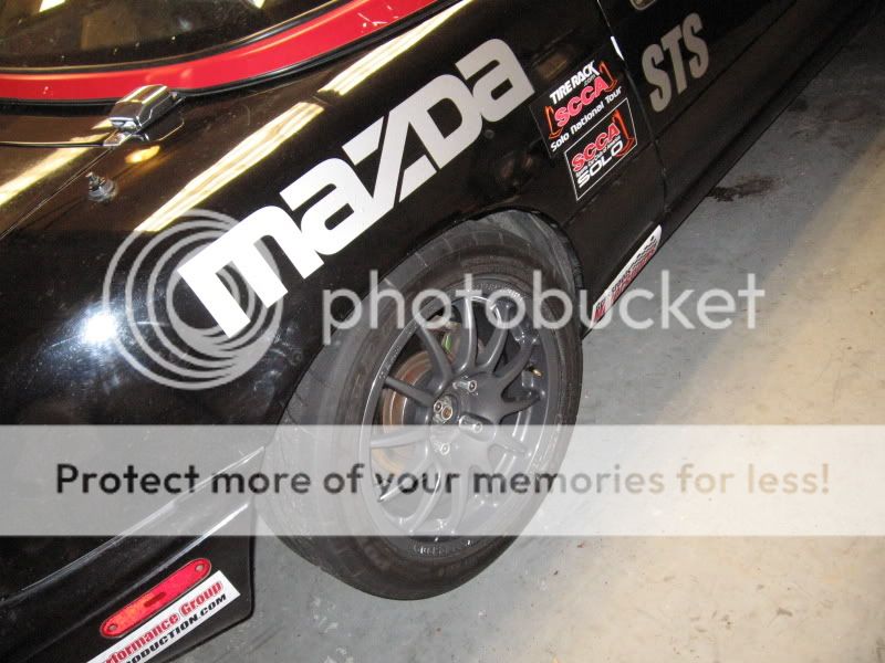

http://i12.photobucket.com/albums/a247/amaff/Miata/IMG_1600.jpg
EDIT: I see what you're saying now after looking @ the pics again. I'll probably re-do the strap before I head out sunday morning.
Damn. I thought I might finally get a chance to make a FAIL pic. Spoiled again... ;)
The new 'street' wheels look great on the car. I dunno if it's the lighting or what, but everything, including the red top, look quite good together.
lol I did some very scientific testing (pulling/pushing really hard on the tires lol) and they're not going anywhere. The goal isn't to prevent them spinning (which isn't really a problem), just to keep them together so that if 1 or both of the pins for the end-plates fail, the wheels on either side will keep the opposite ones on the bar.
