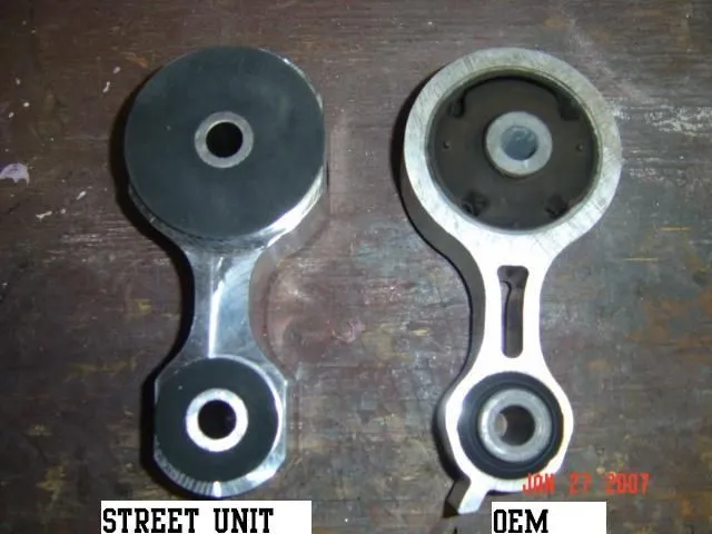

Here it is

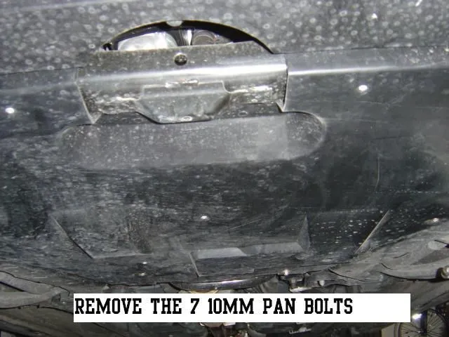

Remove the 7 10mm undercarriage pan bolts and pull the pan out.

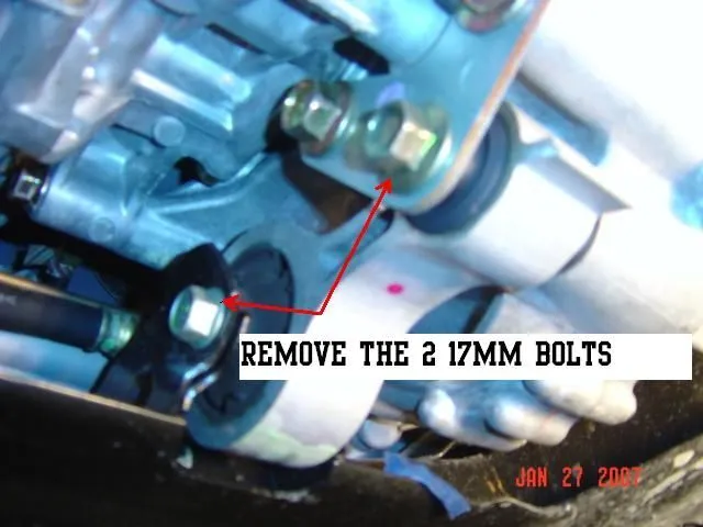

Identify the two motor mount bolts and remove them with a 17mm socket.You might have to use a break bar to get the bolts loose, but try not to rock the car back and forth due to it being on jack stands.
Which ever is the last bolt you remove, it helps to pull the motor back to get the bolt out.

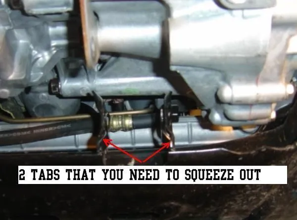

Using vice grips/pliers squeeze the rear mounting tabs together on both sides. It helps make it easier for the mount to fit into the area. I installed the mount in the front first and then pulled the motor back. While holding the motor slide the rear of the mount in and then the bolt.

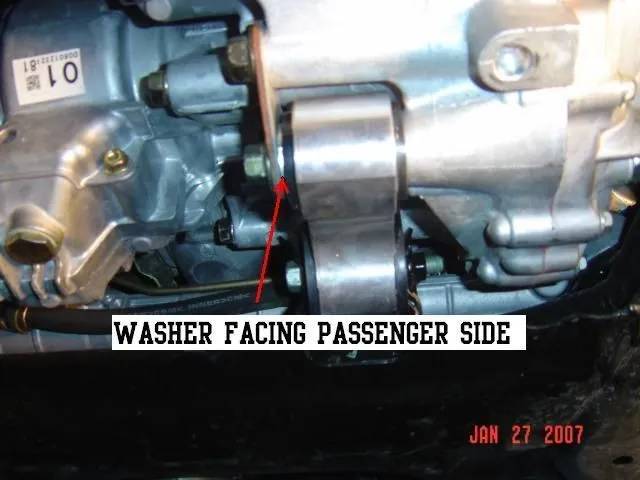

Place washer on passenger side and torque bolts to 75ft lbs.
