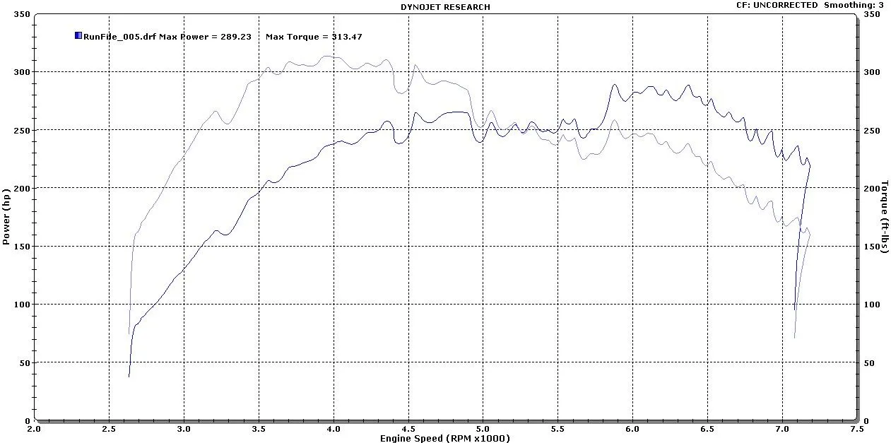

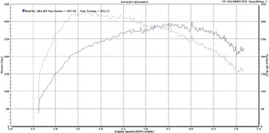

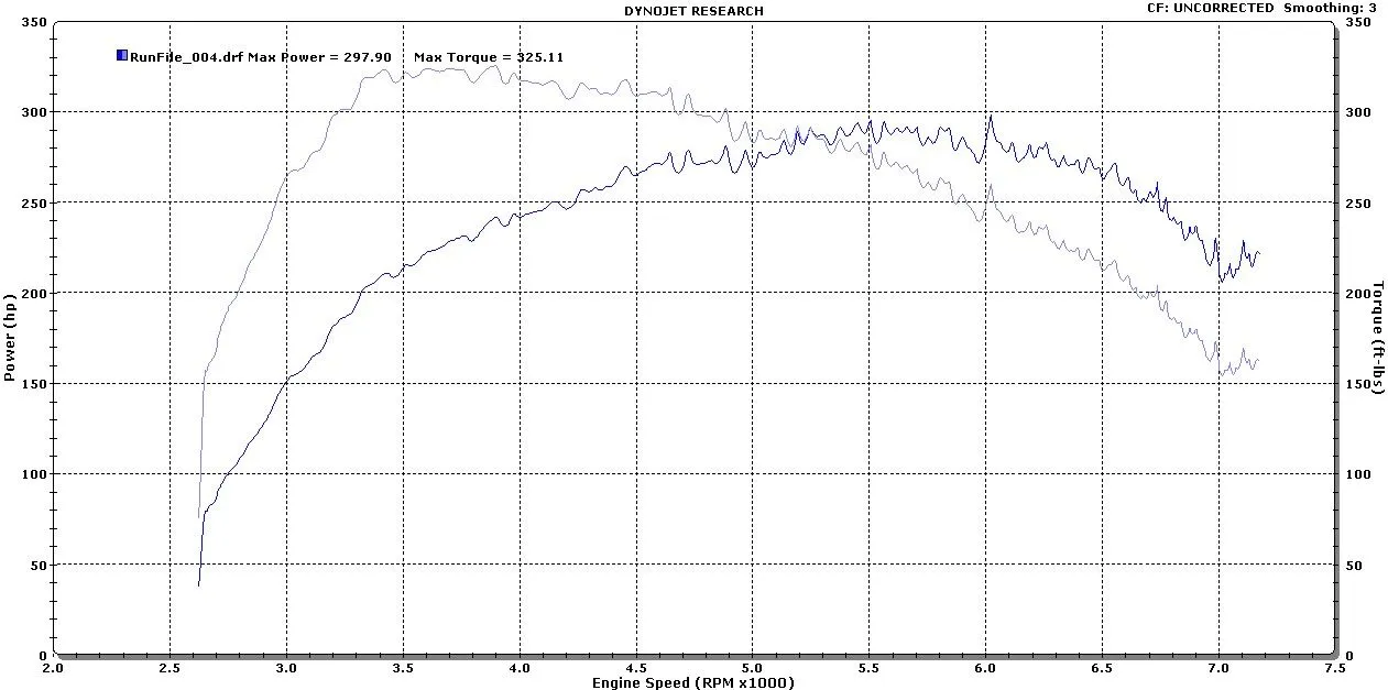

I (re)posted my last two dyno sheets so you can see and compare. You can see the high-speed oscillations in the first pull as the VVT was trying to maintain cam timing and in the second pull the VVT actuator failed internally and "lost" control of the cam position. The sudden spike in cylinder pressure as the cam advanced at high rpms blew the #3 injector seal. Also note that I was revving the motor all the way out to 7k rpms to see how the power held up. Note that this was my first experimental dyno runs right after the turbo install, so they are not the "final" numbers by any means. You gotta break a few eggs to make an omelet....
