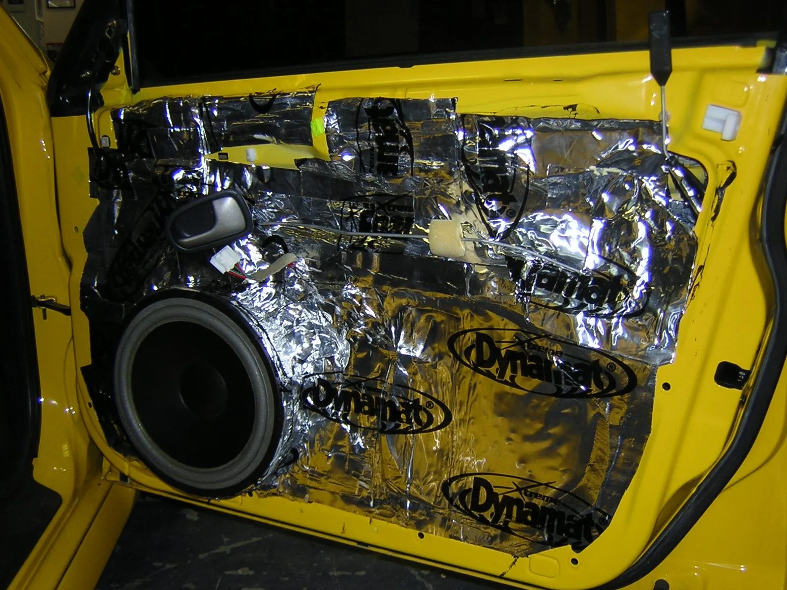

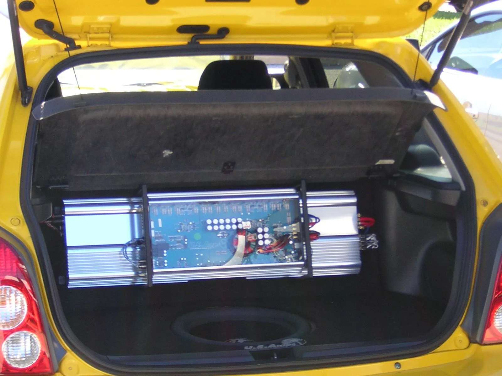

Well I finished the install finally. I thought Id share a few pictures with you on how it came out.

sounds awsome, just need to do some more tuning, the stage is a little left inside the vehicle. Other than that i can't complain!
Joker_Fl said:
here are some more pics

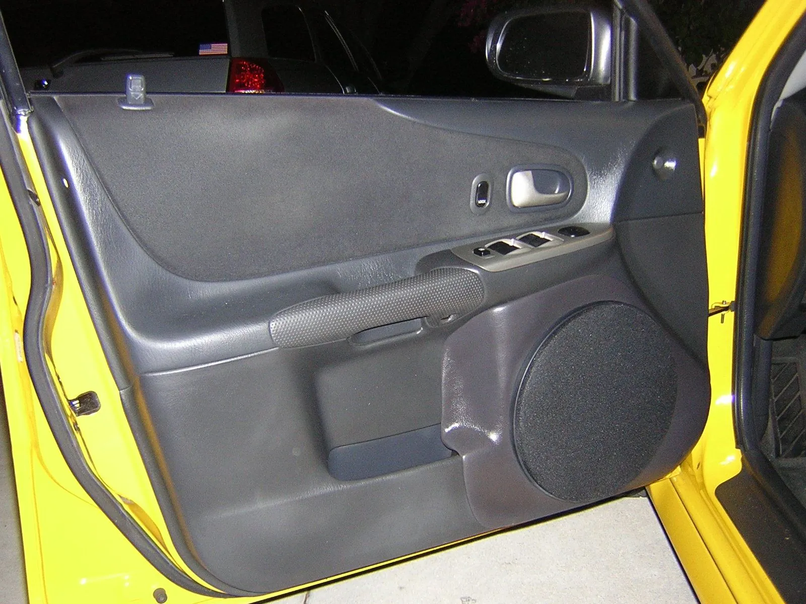

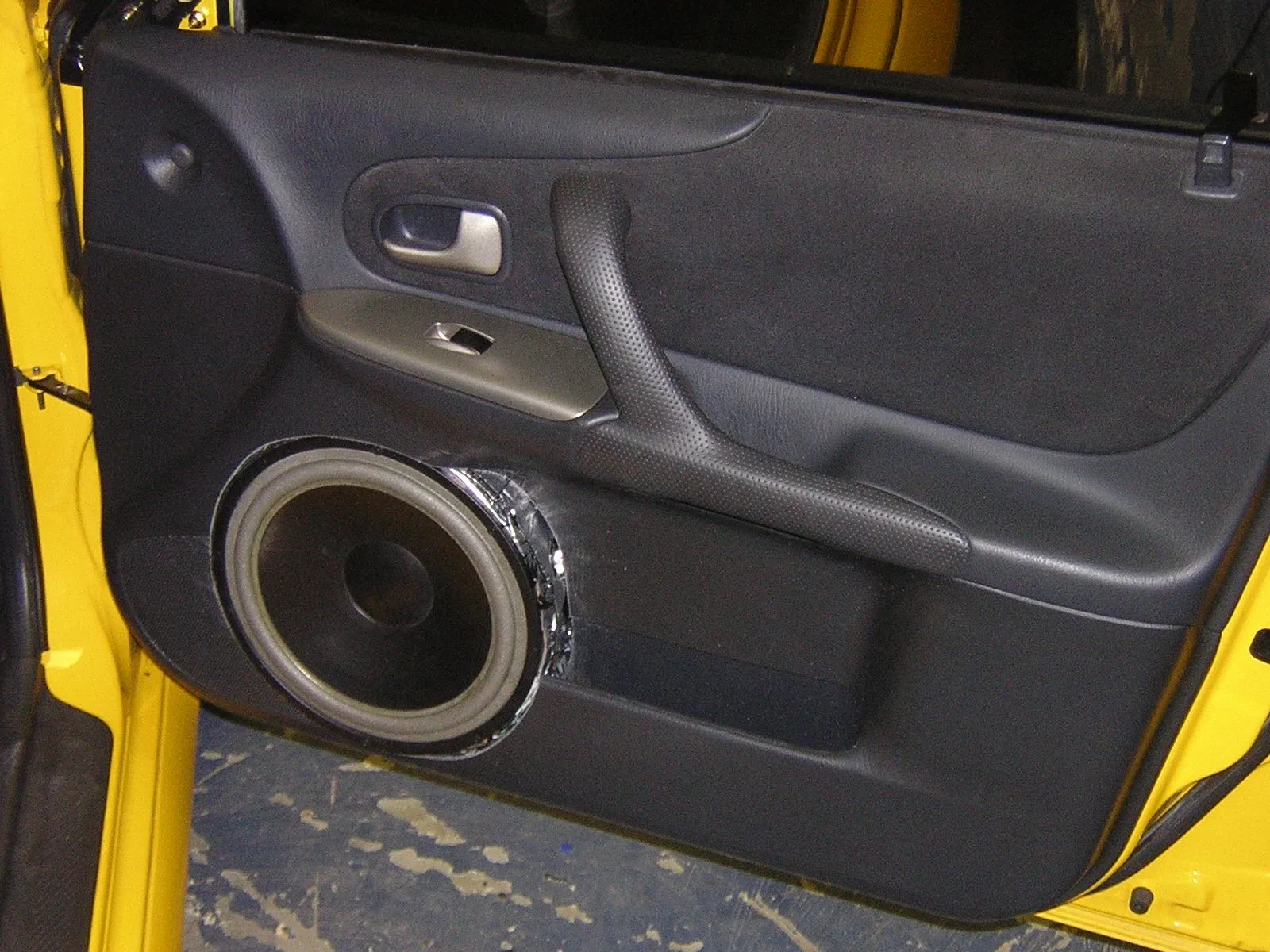

Dayuuum, there's some serious mid-bass in the doors, 8"? Wish I could listen to it and see how it sounds. Anyways, nice work man. (headbang)
Holy crap, that is a hot install. Those look like 10s?! in the door. Very impressive :)
yes those are 10s in the doors. The picture shows the morel mw1077, which is a morel usa home audio 10" woofer (8ohm). These have allready been replaced with Morel Israel Elate 10s subwoofers in the doors. Although they are subwoofers in the doors im using them for midbass, they play 450hz to 50hz, I let the OZ Audio powermatrix 15 in the wheel well enclosure do the heavy stuff. And before someone asks the amps are as follows a hybrid tube amp (tu4360) on the mids and highs, a 600x ran at 4ohm stereo to the elate 10s, and a 1000x bridged to the powermatrix 15. All US AMPS. (headbang)
It is a sound quality vehicle, but for you bass heads, with 1000 watts going to that powermatrix 15 in 3 cubic feet....143.4 spl.

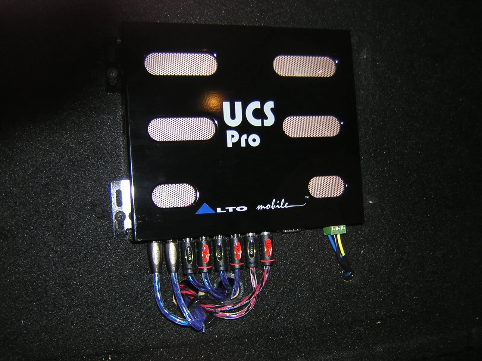

The alto mobile ucspro does all the equilizing and time correction, also has noise gates built in for each channel and stores up to 50 configurable eq and crossover points, all controlled by software on a laptop.

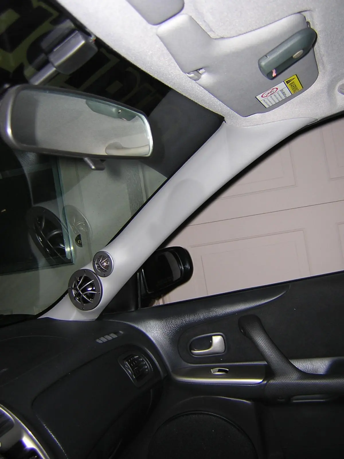

the wires don't rattle at all, they are all secured and wiretied behind the rack. Then held in place with the lower 2 amps. Actually the whole amprack is very solid and doesn't rattle. The only mechanical rattles I have are the b-pillar covers and the front door locks.
Sorry my bad you said a-pillar. No they don't rattle at all either, they are wiretied down. And both of those speakers are sealed speakers...they hold their own airspace.
The alto mobile ucspro sounds like a nice unit, especially for those carputer guys (hint hint).
How much does it run?
retail on it is just over $1000. Yes a carputer would be key to controll this device...I just wish there was room to put one in this car.
