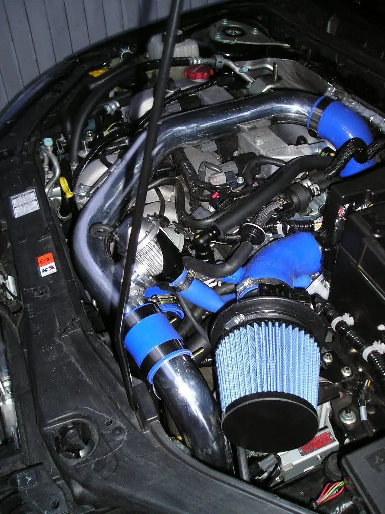

Hey I did most of my FMIC install today in the 40 degree misty rain. It is a Turbo XS kit. I didn't do the power steering fluid cooler yet, and I am leaving my bumper off because it has to go for paint now. So all the zip ties you see are temporary only so don't get in a tizzy about the ghetto look.
The install is pretty damn simple. I had to remove a few of the original power steering cooler brackets and air shields that the directions made no mention of. I also trimmed a wire bracket on the front of the transmission because it was touching the lower pipe which runs along the bottom of the radiator. Yeah thats about it...Later.

Looks really good, I assuming from your HKS adapter that the stock BOV will still work with this kit.
Yes the stock base and hose did fit sort of. I had already hacked and slpiced my hose so more adjusting and trimming made recirc possible. I will run VTA once I start tuning the maps.

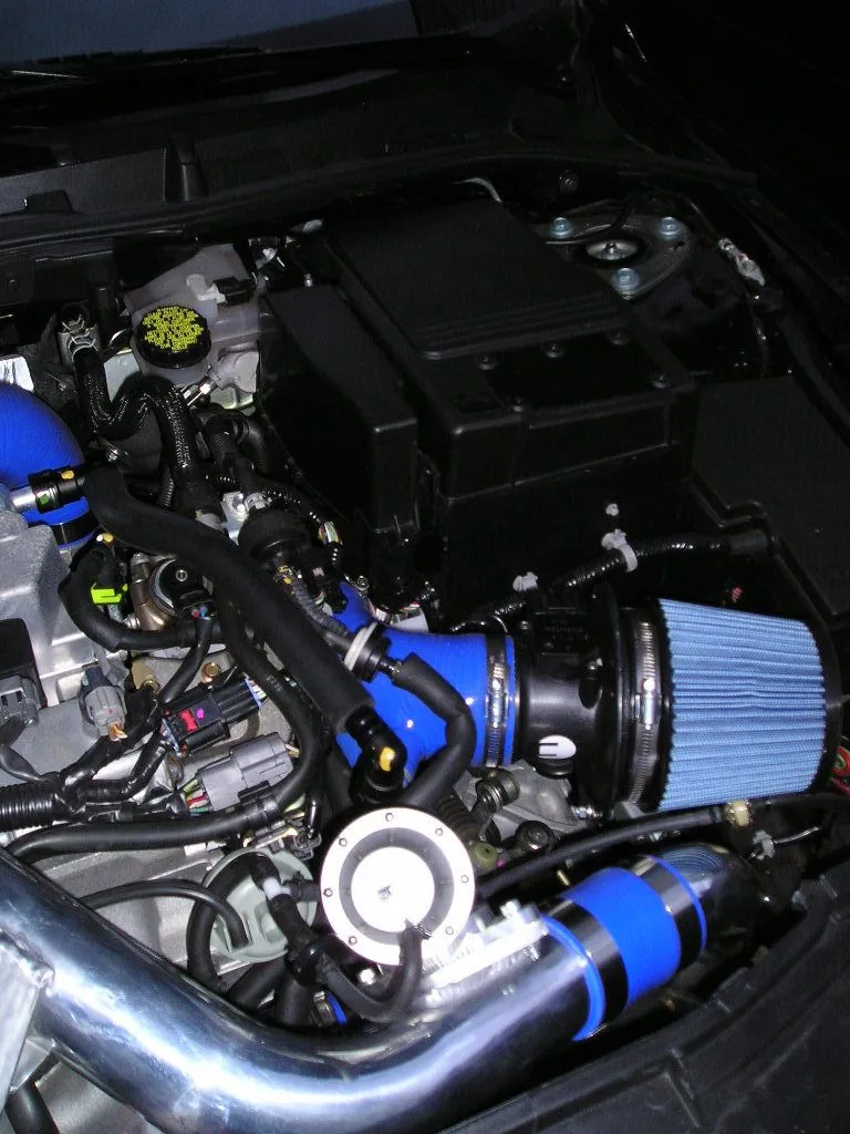

The HKS valve is a better design. It does not open under vaccume or creep open with boost like the stocker. It sounds better no matter what , but I also have a custom recirc so it still has a slight HKS vta noise. I also can run vta if I want which after I start really tuning the car I will work with it.
Hey here are some new shots of the new Cobb intake and $treet Unit BOV recirc hose. The Turbo XS FMIC is 100% compatible with the Cobb SRI. The $treet Unit recirc hose is just a 4 ply straight hose in 1-1/8". That doesn't fit so great. I had to trim it which is why my stock one was screwed up.
