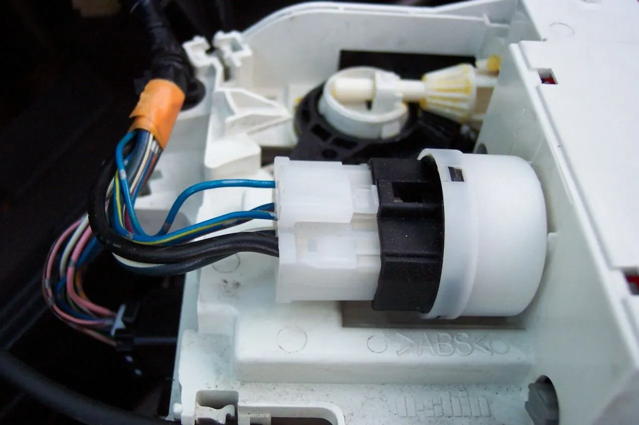

I finally found a solution to MY A/C flickering on position 2 and 3 problem. Canadian dealer wanted $420CND + taxes. US dealer would be around $190US.
PROBLEM: A/C light flickers on position 2 and 3
PREVIOUSLY TRIED: Replacing switch, cleaning all contacts
RESULT: Worked for a day or 2....
SOLUTION: 1) Pull out each wire (1 by 1 so there's no color mix-up) using a tiny screwdriver to lift the tiny tab inside each wire housing.
2) Clean each contact with isopropyl alcohol or similar

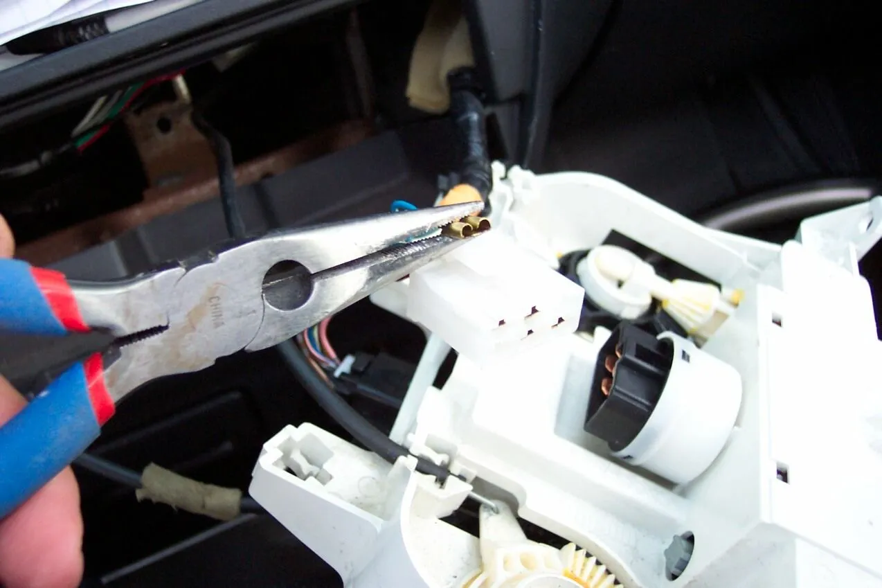

3) Squeeze the connector closed with pliers

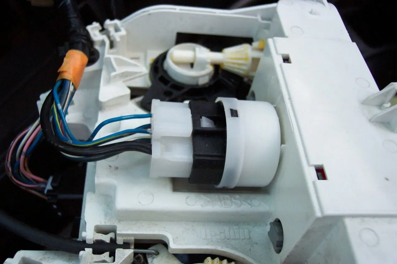

4) Re-install
Before doing this, I noticed that if I would pull the wire harness out a couple of mm, I would lose electrical contact completely (obviously). But what surprised me was that when I
would push the connector in SLOWLY to the point of just making electrical contact, only fan speeds 1 and 4 would work. I would have to push the connector in further to engage all
fan speeds. After squeezing my contacts, I now have the A/C light completely solid during ALL fan speeds, EVEN when I pull the connector out a few mm. So this worked for me!
Try it and post your results!! Put a STICKY too!!

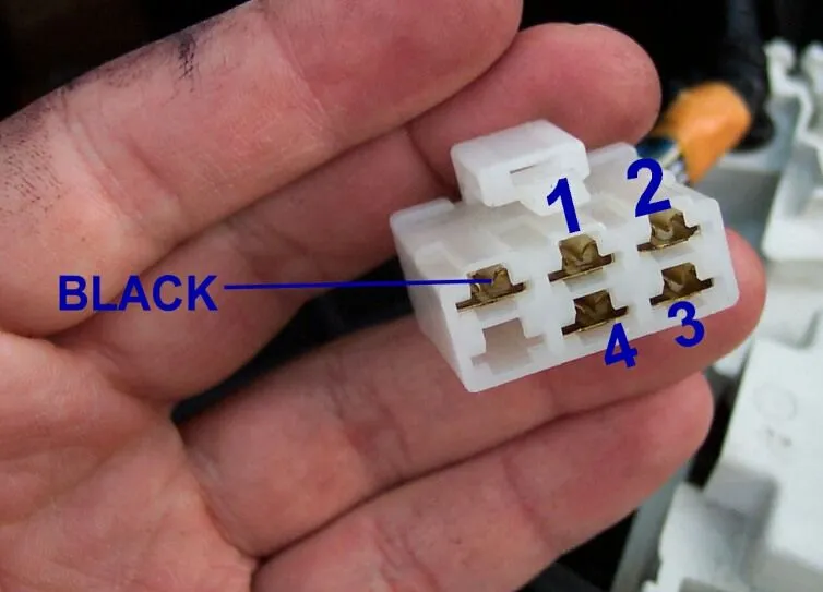

EDIT: I JUST ADDED A PIC WITH THE PINOUT SHOWING WHICH WIRE CONTROLS WHICH SPEED... THIS MAY HELP YOU ISOLATE THE PROBLEM WIRE...
These are found behind the climate control panel. You have to pull off the front bezel, detach some wires and 2 cables found under the dash.
