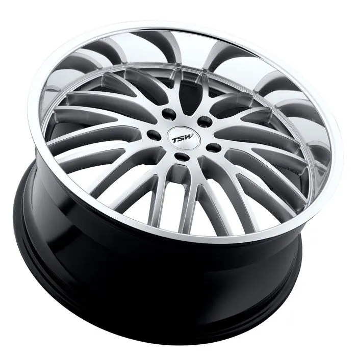

Hi All - just got an 07 M6 V6 and would like to install lowering springs and leaning toward the Eibach Pro Kit simply because it's just a daily driver. While I've installed lowering springs in my younger years on miata's, supras and mr2, I just don't have the time anymore...so wondering if anyone would know any reputable installers in either Roanoke, Va. Beach/Norfolk or York, PA since I frequent these places? The other question is about the wheels. Having read most of the threads on wheels and tires, I need some advice on the TSW Snettertons, 18x8 wrapped w/ 225/40/18's. Looked at some sites, all confused about applicability. Any advice is appreciated. Thx

you have to find out he backspacing on those and the hub bore size. i did a quick google search but couldnt come up with much. dig around a bit more and when you find it post it up and we should all be able to tell you if it fits or not.
p.s. the mods will move this to the right section for you too i am sure
ok just did some more searching. i am not sure what finish you are looking for but if you are looking for the silver this should be the part number you need
1880SNT405114S76
specs:lip-1.1 diameter-18 width-8 backspace(mm) 40 bolt pattern 5-114.3
chrome part number is 1880SNT405114C76 same specs
