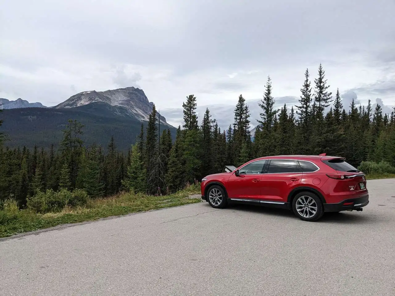

Like I did last year, I drove out to Banff from Winnipeg again. That's around 1450km each way. From Banff we drove into parts of British Columbia and parts of Jasper, Yoho and Kootenay National Parks. The trip was awesome as was the ride, it was really great driving around the mountains in the CX-9. I found myself using all driving modes including the normal Drive, the Sport Drive and manual switching of gears (mostly to make use of engine breaking while going down some of the steep and fairly long declines in the Rockies). For the drive across the prairies we were fully loaded up - I removed the 3rd row seats and packed the rear of the car with all sorts of camping gear. On the trailer hitch I had a bike rack with 3 bikes. I was pleased to see that even on the way out West I was doing under 10L/100km, which I wasn't expecting as going west we get a head wind and it's a gradual incline of a few hundred meters. The total mileage was around 9.4L/100km which all things considered is pretty good (average speed on the hwy was around 118km/hr). But once we got to Banff I took all the gear out and removed the bike rack and the overall performance was great. Passing trucks on the winding roads of the #93 HWY in Alberta/BC was effortless and actually quit fun (although watching other drives pass on blind turns was rather unnerving).

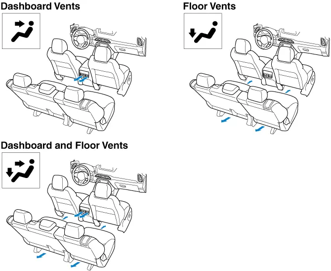

The cx-9 has floor vents under the second row seat to warm the 3rd row. These are controlled by the rear hvac system. My guess is that the rear temperature control where either set to a warmer temperature on auto or just set to heat and warm air was blowing directly on your equipment in the third row.
Note that on Auto: cooling request will automatically switch the vents to dashboard vents only and heating requests will automatically switch to floor vents. If you want cold air at the floor you need to manually set it up.

You know, I didn't even consider this. Those two rascals in the back (10yr and 8yr old) were probably playing with those controls. Don't blame them, it was a very long drive. I'm gonna have to check that. That would be so funny if that's what it is.

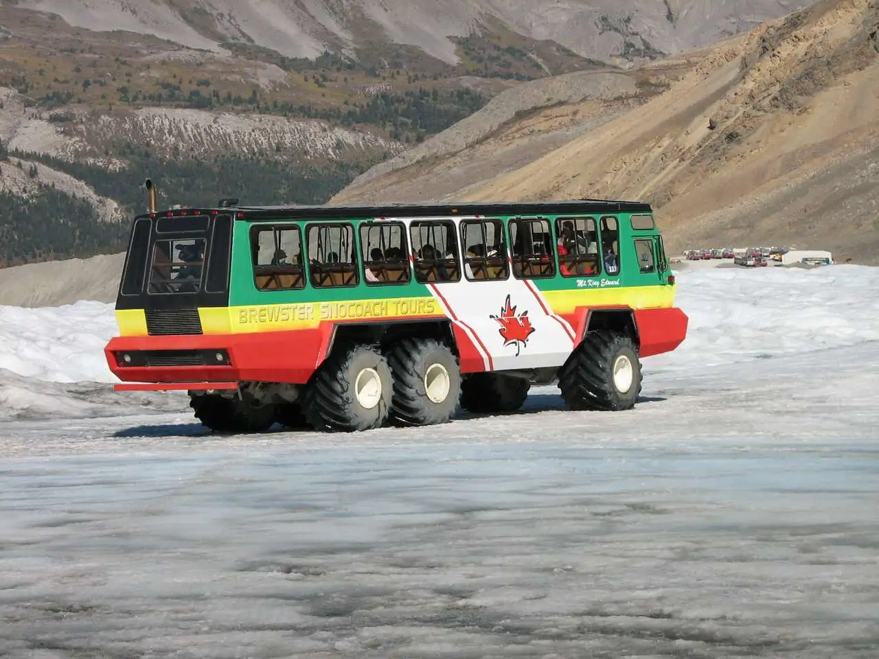

Pictures from 16 years ago: the ever popular photo op at Lake Louise; battling elk; "bus" that will take you onto the Athabasca glacier, if its still there; Big Horn lounging on the road shoulder.

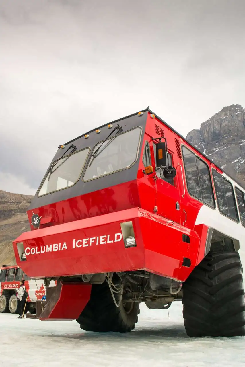

Yep, the "bus", aka Ice Explorers, are still there but they've been upgraded and repainted. These custom built 55,000lbs beasts are powered by a Mercedes engine putting out (depending on model) over 300hp and around 1000ft-lbs torque.
However, the glaciers themselves are receding and it's possible that within our lifetime they will be gone. So if anyone wants to see them, now's the time (or, well, 2023 I guess, they don't run tours in the winter).
