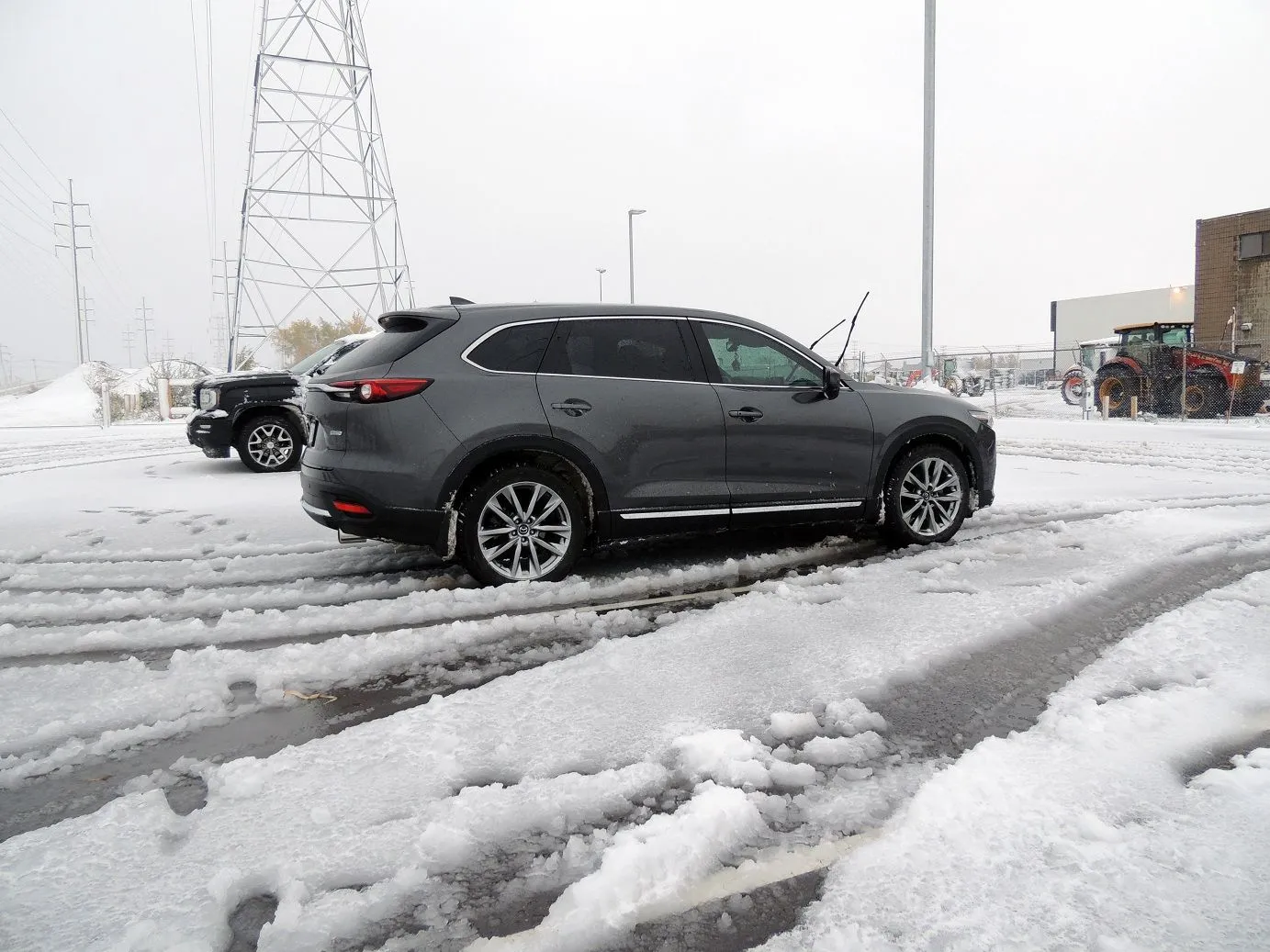

Agree with norsairus. I had Ecopias on my 2018, and after adjusting them to the correct psi, they were ok for the Calgary winter at the beginning of 2018. That said, they were indeed the worst tires I've used in the snow, so I wouldn't recommend them unless you absolutely can't afford to change tires. I had no issues getting around, and never got stuck once, but it was highly dependent on me, as a driver, being aware of the tires' limitations at all times.
I now have Bridgestone Blizzak DM-V2s, and they're much better in the winter. Driving to work this morning was a breeze.
