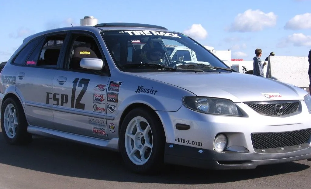

I should have pictures up in a day or so of my Kosei K1's...15X7 +38. They are around 13.5 I believe, but they are white. If anyone is interested keep checking the FS forums over the next few days. I've got to get my Hoosiers taken off so I can get good pictures.

I'm pretty confident that they wouldn't rub under 90% of driving situations. The problem with them is the offset. They will stick out in the back. There isn't any way around it. For racing, which is all I used them for, a few millimeters sticking outside of the fenders sin't a big deal. For street driving it can look a little wierd. The Hoosiers in the picture below are 225/45-15. They are noticably wider than a 225 street tire.
