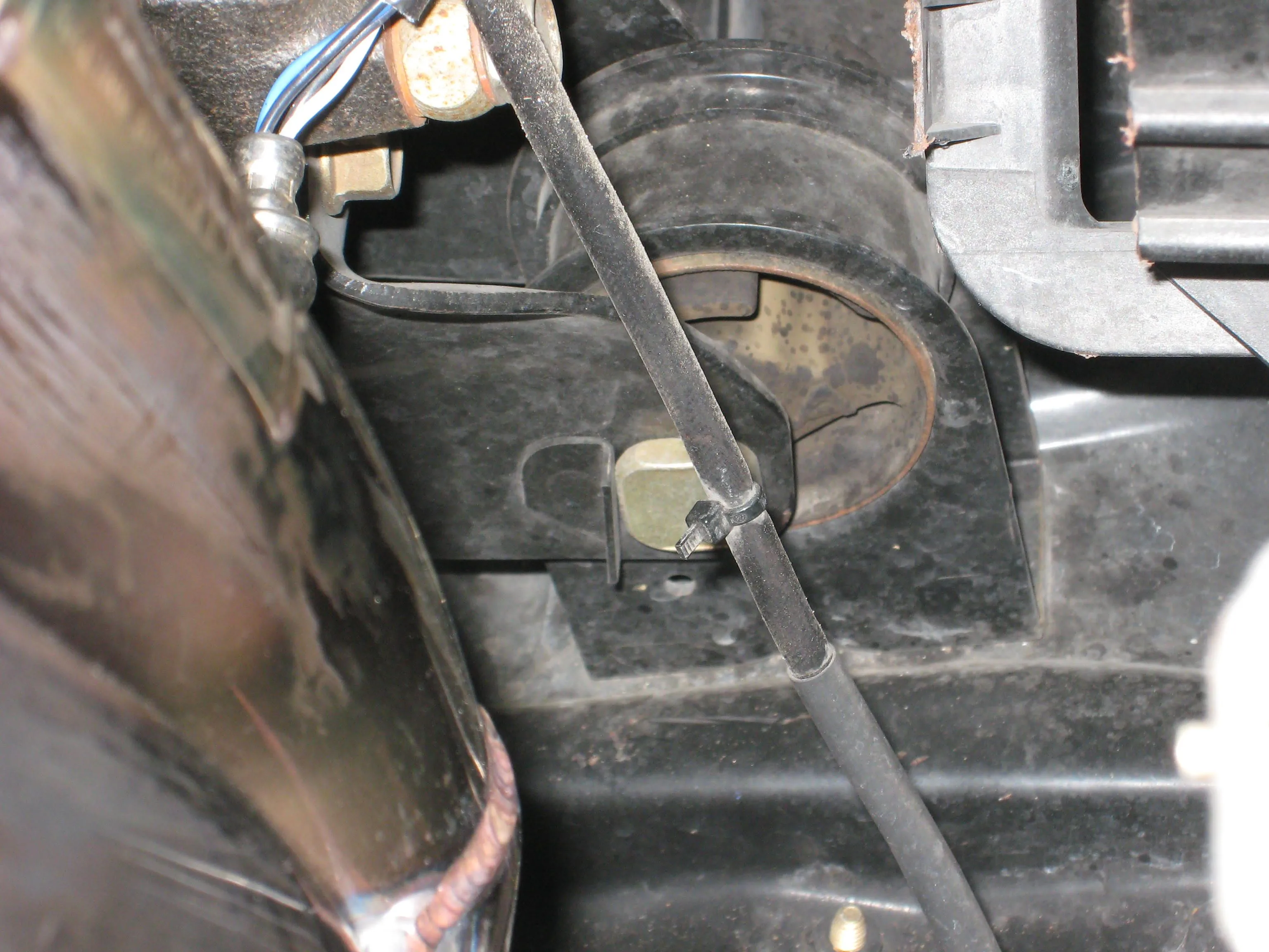

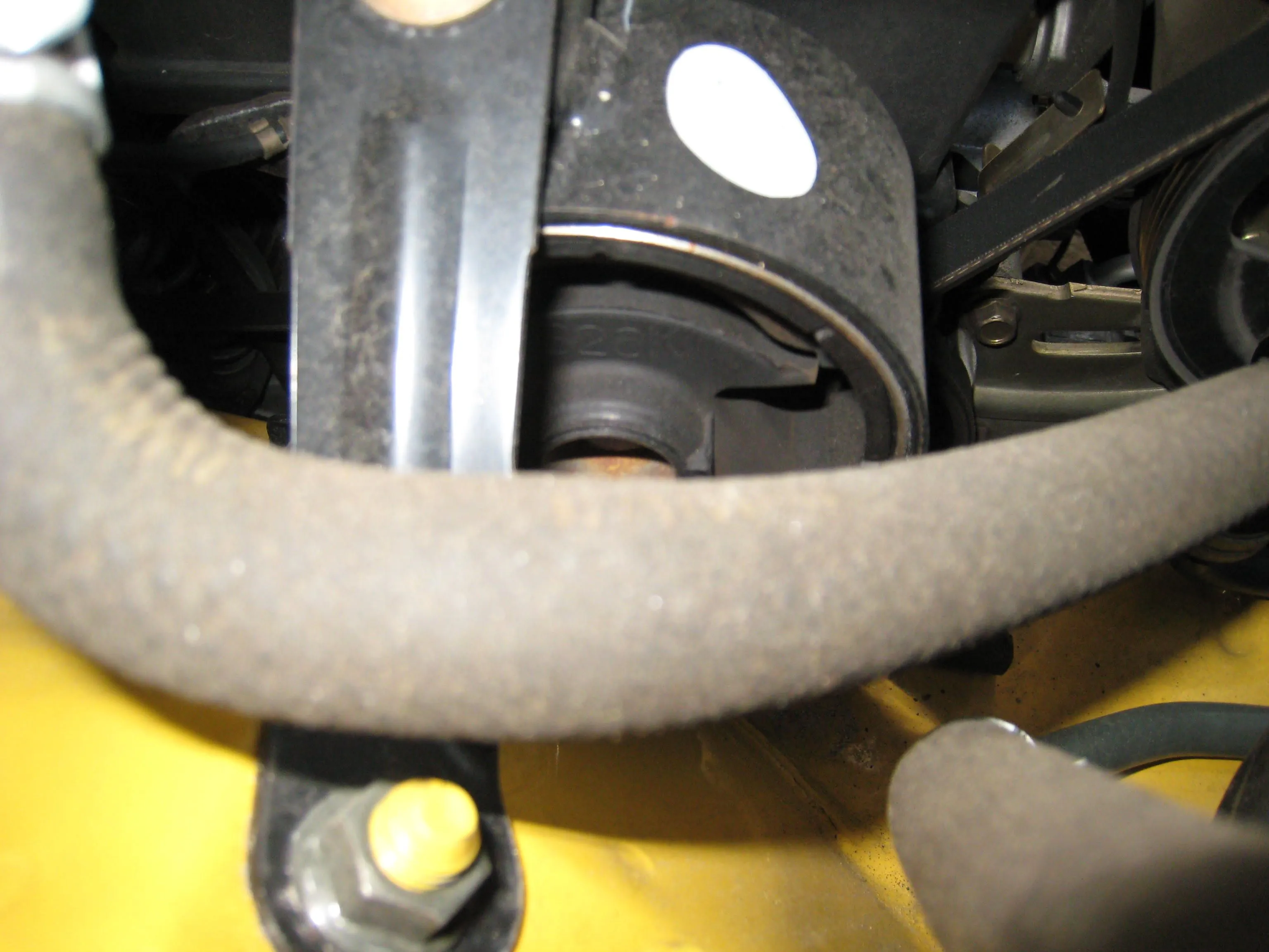

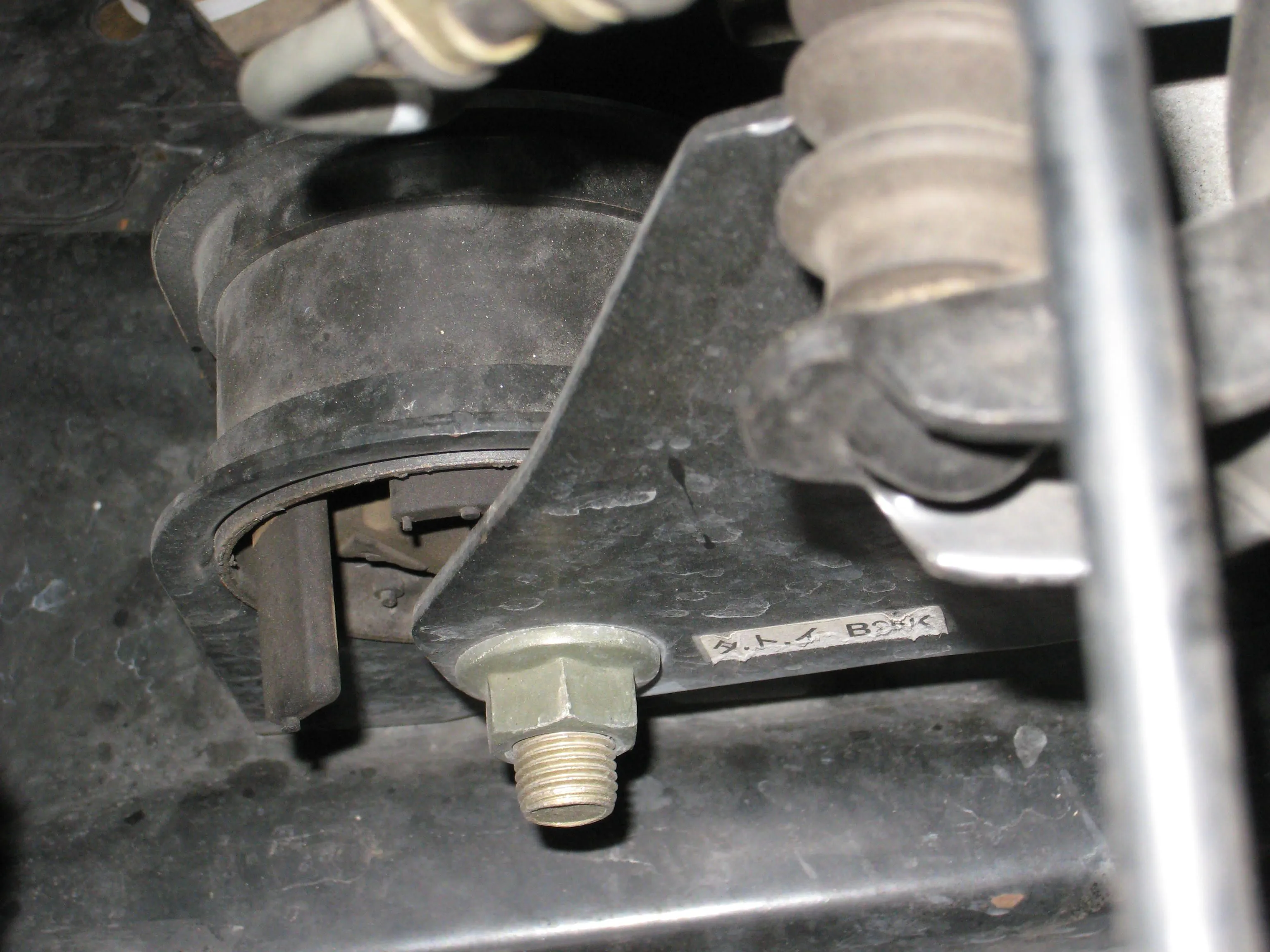

Torn? The first two are the front mount, last is the passenger side.... :(

I'm not an expert and its hard to tell from your pics, but there is a good chance they are at least partially torn. How many miles are on your car?

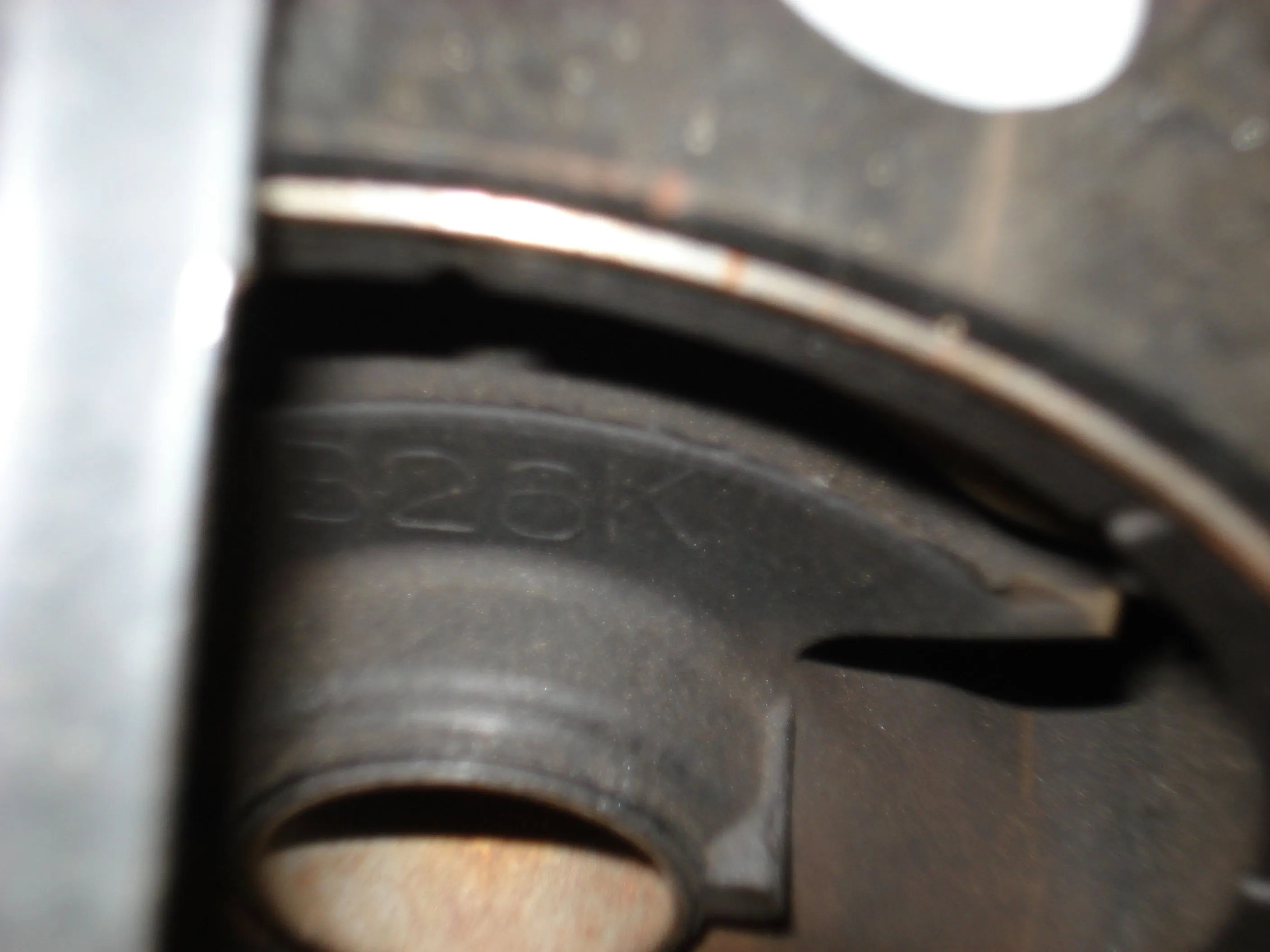

about 41k. the last one (side mount) looks torn i think. should that piece be disconnected from the other part of the mount? attached another of side. any better?

To me, none of yours look torn. The center of my torn front mount was resting on the bottom of the mount, rather than being suspended in the center. The factory side mount is a lot beefier than the factory front mount and it has a lot of little channels and whatnot that makes it really hard to tell if it is torn without taking it out. It might might, be torn, but maybe not. If it is torn i dont think it has the impact that a torn front or rear mount might have.
Here is a link to a pic of a torn side mount from SLSs website. maybe it will help.
http://www.slsperformance.com/slsp/m23ProductImages//alternates/135.jpg
