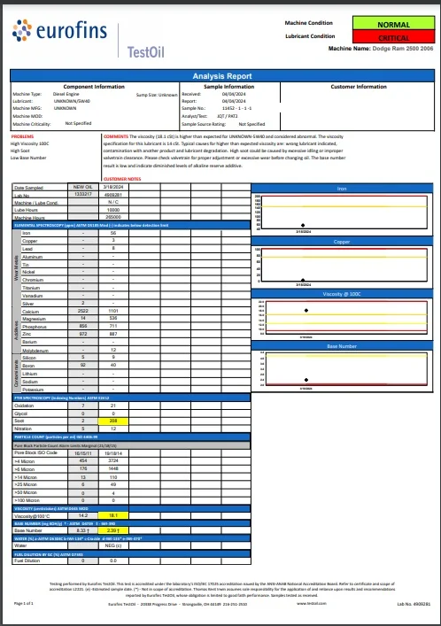

The attached Eurofin tests results are for my 06 Dodge Ram, 2500, 5.9 Cummins Diesel. I had to do some searching on their website to find the automotive tests.
At the bottom of the report it shows amount of fuel in the oil. Diesel fuel in the oil is of major concern. When injectors start to fail, it over fuels and dilutes the oil.
You will note the high soot and viscosity numbers. I was surprised to see this BUT I had treated the oil with Hot Shot Secret Stiction Elimination. It looks like the oil additive is cleaning out the engine and hopefully the build up between the pistons and rings. This was the second treatment. The engine starts quicker, more power and good FE. It sounded different after the first treatment. We treat excavators and Bob Cats with HS SS with great success.
Note an important test, Base Number. Below 3 means it's time to change oil. I believe this was caused by HS Stiction Elimination. I'll test again at 265k mi.

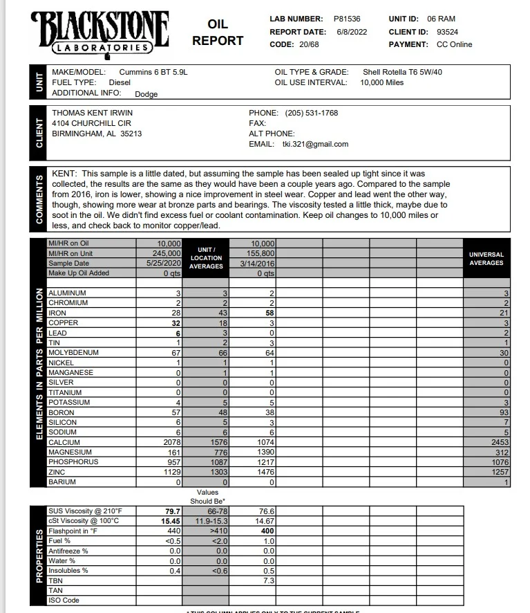

I attached a Blackstone report at 245k mi. This oil had the first HS Stiction Elimination. Blackstone didn't test for soot but noted it might have some due to the HS SE. Also, no Base Number test.

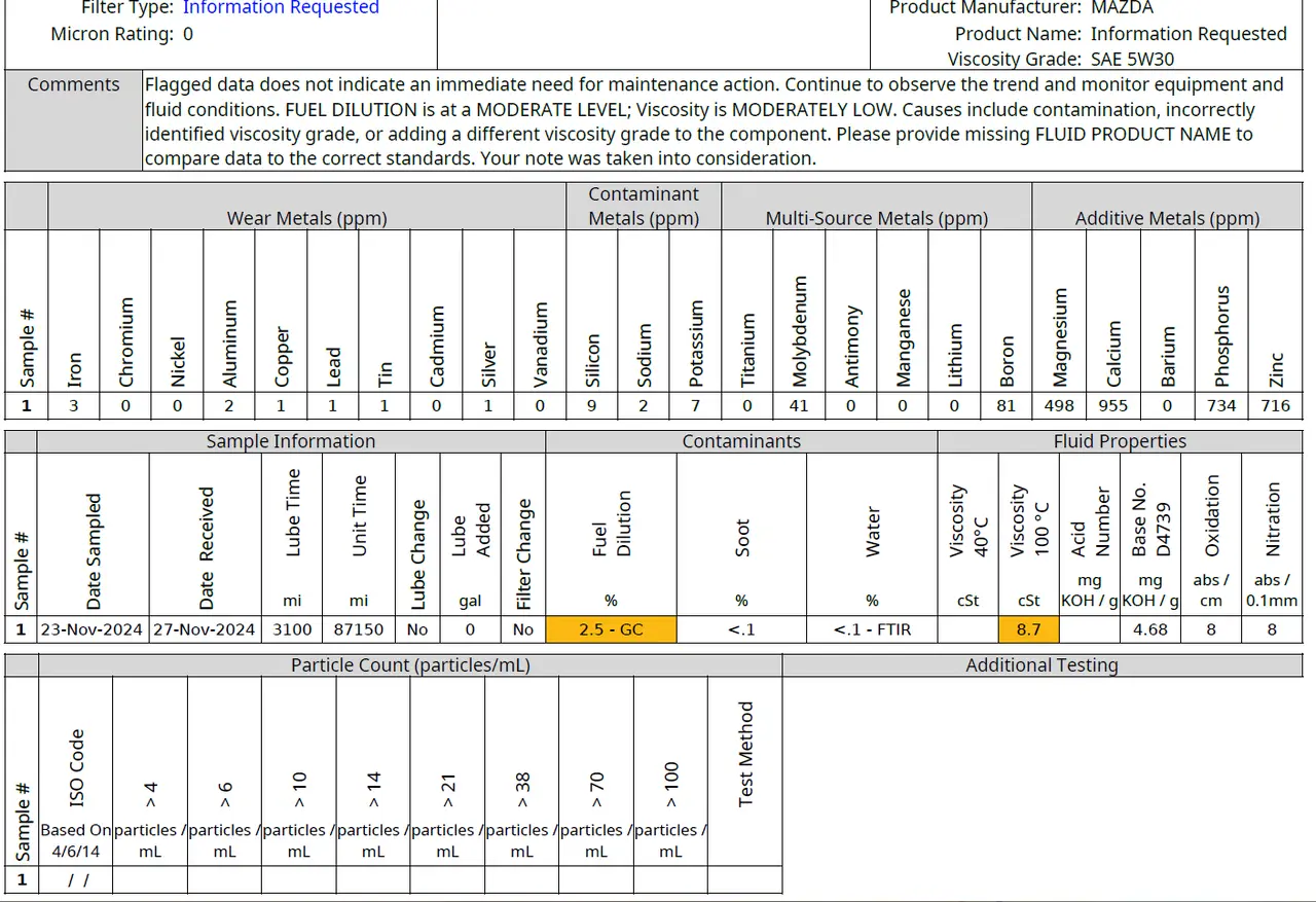

Here's an oil analysis for my 2019 Mazda 6 Signature. A little history...
1. Bought at just over 84k miles, one owner, mechanically pristine for the mileage and drove great.
2. Per Carfax, avg just over 10k miles per oil change (dealerships and various oil change places).
3. Last oil change before purchase was at Mazda dealership, claimed they use Mazda OEM 5w-30 semi-syn blend. From the oil analysis here, could be an Idemitsu product when comparing to VOAs online but can't nail down who makes it. Filter was not OEM, so who knows.
4. Since purchase (3k ish miles), driven 80% commute, 20% highway, some-what spirited (this car doesn't like over 100 mph on the highway IMO, definitely not German-like and mostly expected). Avg mpg just under 21. Oil was in the engine about 10 months, probably overdue for a change.
Everything looks great from a wear standpoint, no sky-high potassium levels or anything strange. Just fuel in the oil of course and lowered viscosity, same issue as some cases I've read about on this and other threads.
Changed oil 2 weeks ago with Castrol Edge Dexos Gen 3 5w-30, Thailand OEM filter (PY, not PE). From looking at other UOAs from 2.5Ts and some EcoBoosts, seems like this oil might reduce sheering a bit. Worth a try. I'll post another sample to Oil Analyzers at 3k mileage and post the report. Would prefer to change oil every 6k miles or twice a year if I can (I average 12k mileage a year).
Doubt there's a way to curtail the oil dilution but if anyone knows of a remedy please share. Maybe just but the highest viscosity 5w-30 one can find if the Castrol Edge sheers off quickly.

Looks similar to mine.
Also, the detergents in that oil look a bit low. I'm sure your new oil will be better.
