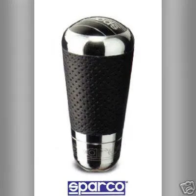

this is the only knob i found so far that kinda resebles ours, what do you think?
It's not bad but I kinda like the stock knob. I went to Autozone and looked at all the knob's they have there and I could not find one that I liked, though I will admit that's not saying much for their selection. I think the stock knob is heavy enough to work well with a short shifter.

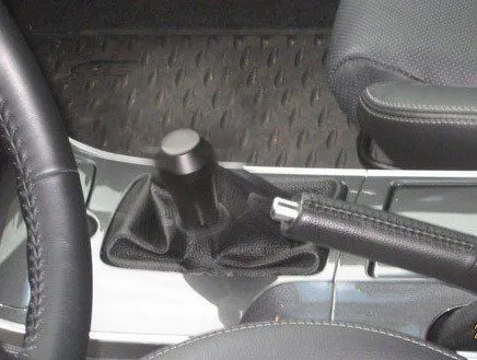

this is what i want mine to look like, just with the stock knob tho
Just cutting the shaft is not the best idea. It is really only for the "look" but it will make shifting slightly harder due to decreased leverage. The Twm shortens the shaft and elongates the linkage underneith. The linkage on the bottom is the big deal. By being longer it can move the cable as far as it need to go with less movement on the shaft.
ya i know ur 100% right, i just wanted it to look good hehe
