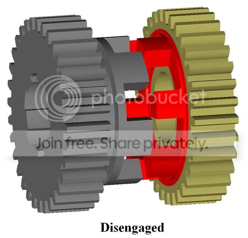

callphy, what you describe is not exactly what I would consider abnormal. reverse is different than 1-5. It's a different kind of gear, and sometimes harder to get into. What might help, is to get an understanding of what stuff looks like in there, or what is mechanically happening when you shift gears in a manual transmission. When you shift into a gear, the gear "engages" using a dog clutch. A facsimile is shown below.
So if you shift into reverse and it doesn't go in, then put the stick back in "neutral", then release the pedal to re-spin the gear, push it in again, and then re-try to put it in reverse. If the pegs match up better, it will shift into gear no problem. First gear is much the same way--more so than the other gears. It spins so many times for each wheel rotation that it's hard to get the pegs to match up sometimes. To get it in gear you might have to "double-clutch". This is what I described above with reverse. Without shoving the stick into 1st, release pedal, then push the pedal back in and then try to put it in first. you just need to re-spin the gears sometimes to makes stuff mesh together properly.
hope this helps.
